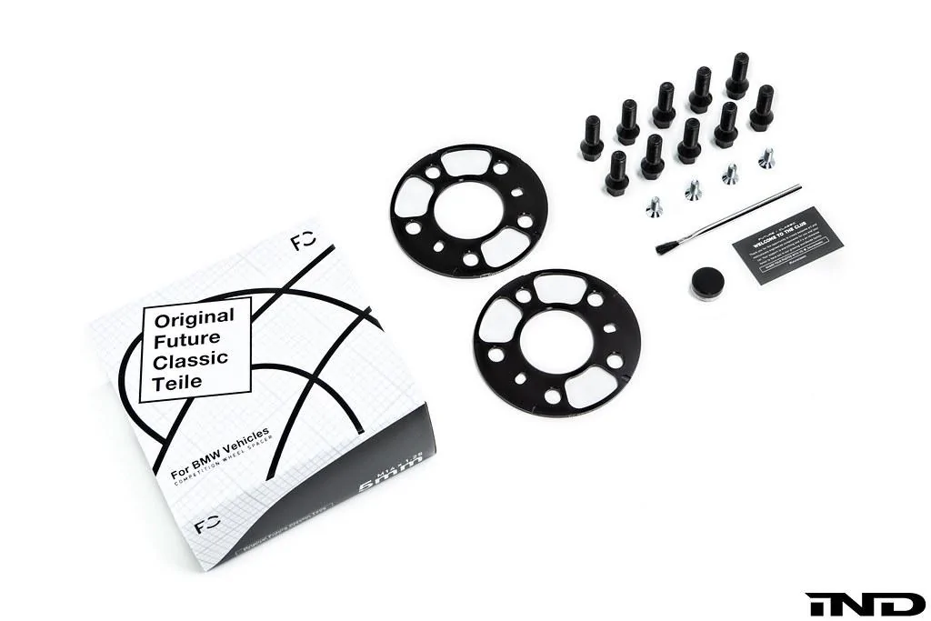

jopfer
Jacob
Oct 22, 2019
138
101
Bozeman, MT
2020 Supra GR

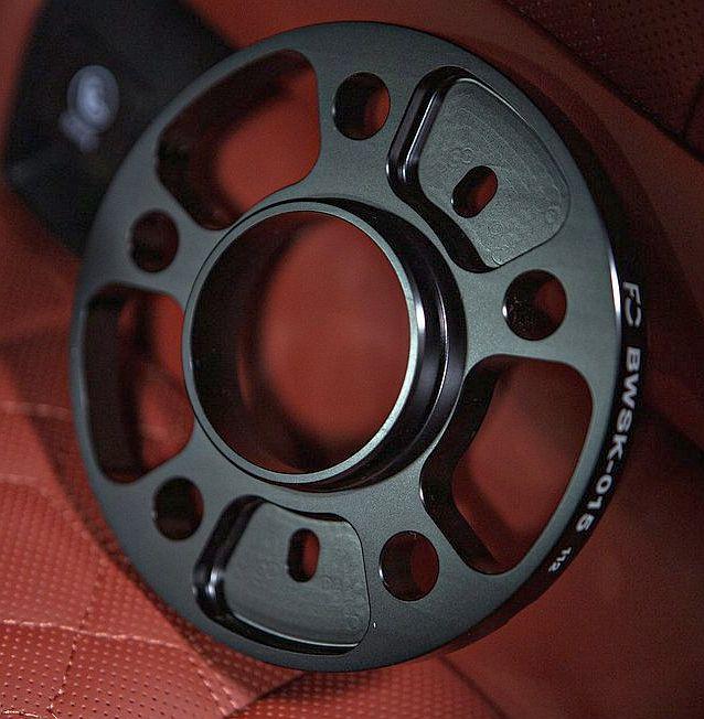

Looking for feedback....Anyone use this spacer kit? 12mm, 15mm, 18mm
Future Classic A90 Supra 5x112 Wheel Spacer Kit
I have the motorsports hardware stud conversion kit and went with Future classic 12 mm front/ 15 mm rear spacers. The offset of these two is perfect. I also have HKS lowering spring with 1.25" drop all the way around. No rubbing. Looks great. Hope this helps.

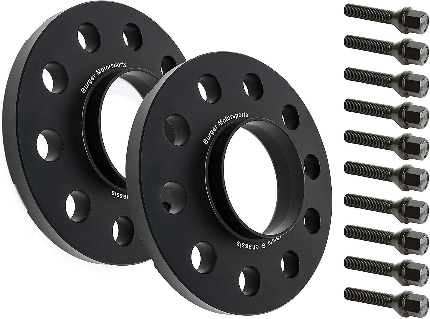

I'm still trying to decide between Future Classics and Burger spacer...definitely going with 12~13mm front and 15mm rear....
Burger (shown below) is currently out of stock of the 13mm and 15mm....However, the Burger spacer set will cost $120 less (includes shipping cost) than the Future Classics spacers...
Aside from the fact that the FC spacer set will cost (including shipping) $120 more than the Burger spacers my other concern with the Future Classic is that the spacer machined out sections do not appear to have a symmetrical weight distribution around the hub...Anyone experience any shaking or vibration with the Futures because of this?
I do like the idea that the Future Classic Spacer use a bolt to secure the spacer to the hub...

The Future Classic spacer (with 2 machined out sections shown below) doesn't appear to have a symmetrical weight distribution around the hub...Has anyone that installed the FC spacers experience any sort of shaking or vibration because of this asymmetry ?
