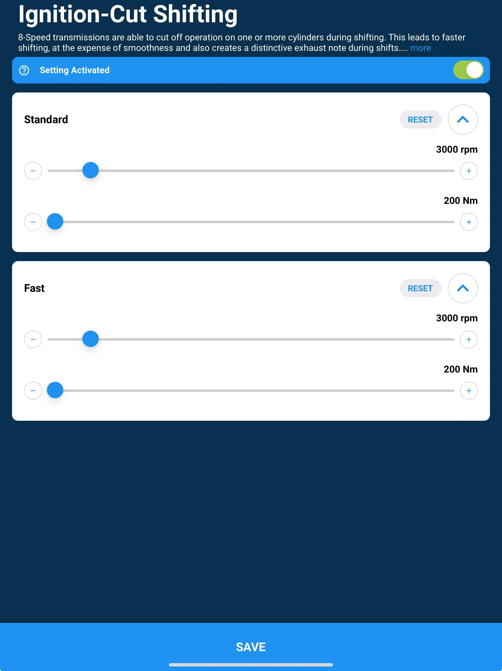

I'm glad you posted I hadn't heard of this setting until I got the email. Are you trying to get it to have faster shifts all the time or trying to make it only do farts at higher torque values? I'm assuming it's the former in which case it sounds like you've configured it correctly, part of me is tempted to lower the values to the absolute minimum for both to see if you can get very fast shifts every time. Very curious to see what others comment on this setting because the wiki page has nothing extra other than the in app explanation.
Can you screenshot your current settings?
my car always had “farts” at higher torque values, it doesn’t make any noise unless I’m on it at least a little bit. For me it was mainly the faster shifts and sounds is just a bonus. I personally love that blast when shifting, if I could I’d get the way my mustang would shift when it had the N2MB WOT box installed. Loud pop at each shift and at night little blue fire balls. I like that F2 cars have that pop on shifting.
but with the setting I have it at now, I didn’t notice anything different, not shift feel or sound. To be honest though I am perfectly fine with how I have my xHP set up right now. This was more just dicking around with a new option given to us.

Hmm I'm not sure this setting will let us get fast shifts at low speeds. I flashed my car today to the lowest values for both, in this case 2500rpm / 200nm which is basically your settings. Quick math to convert 200nm to ft/lb yields 147, and using the cars builtin sport displays, 147+ ft/lb is already about the same butt dyno I had for the fart / fast shifts anyways.
I'm going to try a stupid configuration of reassigning all shift speeds to fast and try that with the ignition cut shifts configured, but I'm not optimistic. I'll then try faster shifts via torque reduction upshifts, I would love the car to shift "as fast as possible" while still being comfy, but it may not be possible.
edit: I did the remapping everything to fast, no major difference. i then adjusted the torque reduction upshifts UP by 5% everywhere (faster shifts at the cost of more turbo lag) and im a fan so far. I'll keep testing and report back
