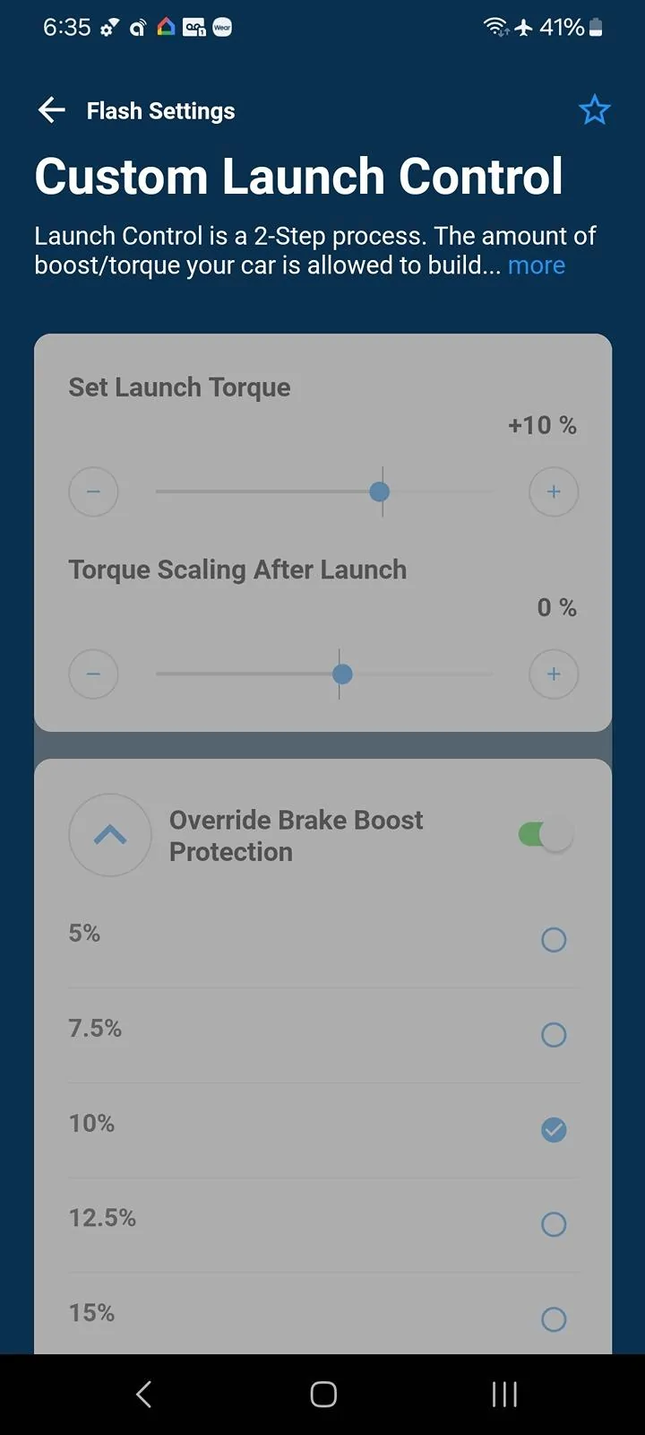

Has anyone messed with the "custom launch control" "set torque launch" and "override brake boost" options? Are these new options? Didnt see them before. Wondering if any tips/recommendations. On e50 dp tune, thanks!

Yep. Running a custom 93 tune on the JB4 and xHP stage 3. It all does fine together. I can't think of anything tune/JB4-related that really wouldn't work well with xHP...
Does it matter which is installed first?
