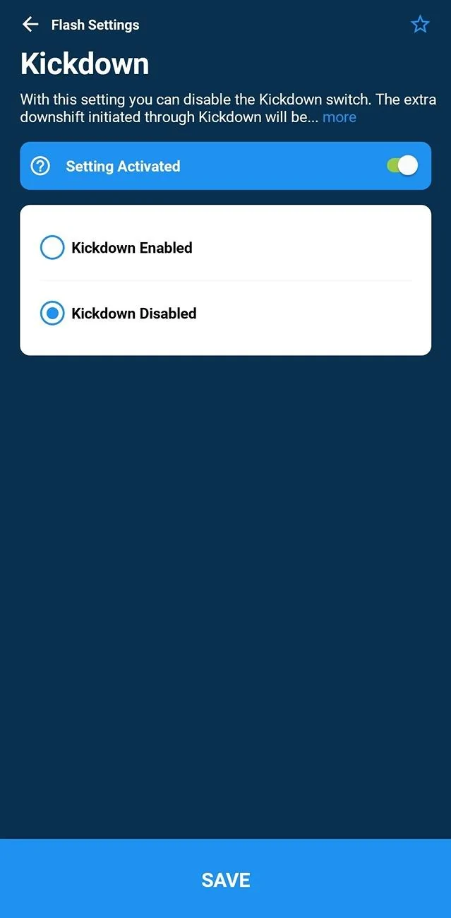

anyone having issues with the tcu not obeying the kickdown disable? I even tried cycling the setting off and on with subsequent flashes, but the pedal button (and left paddle hold) still kicks down.
