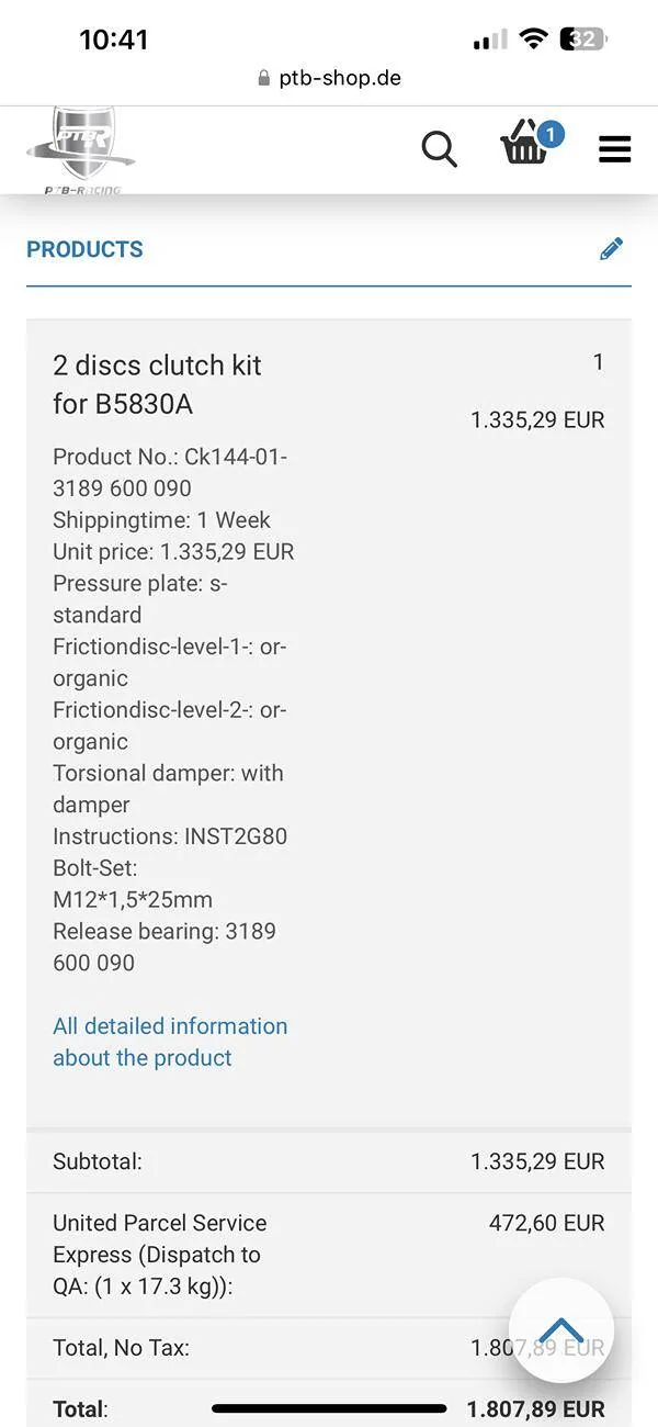

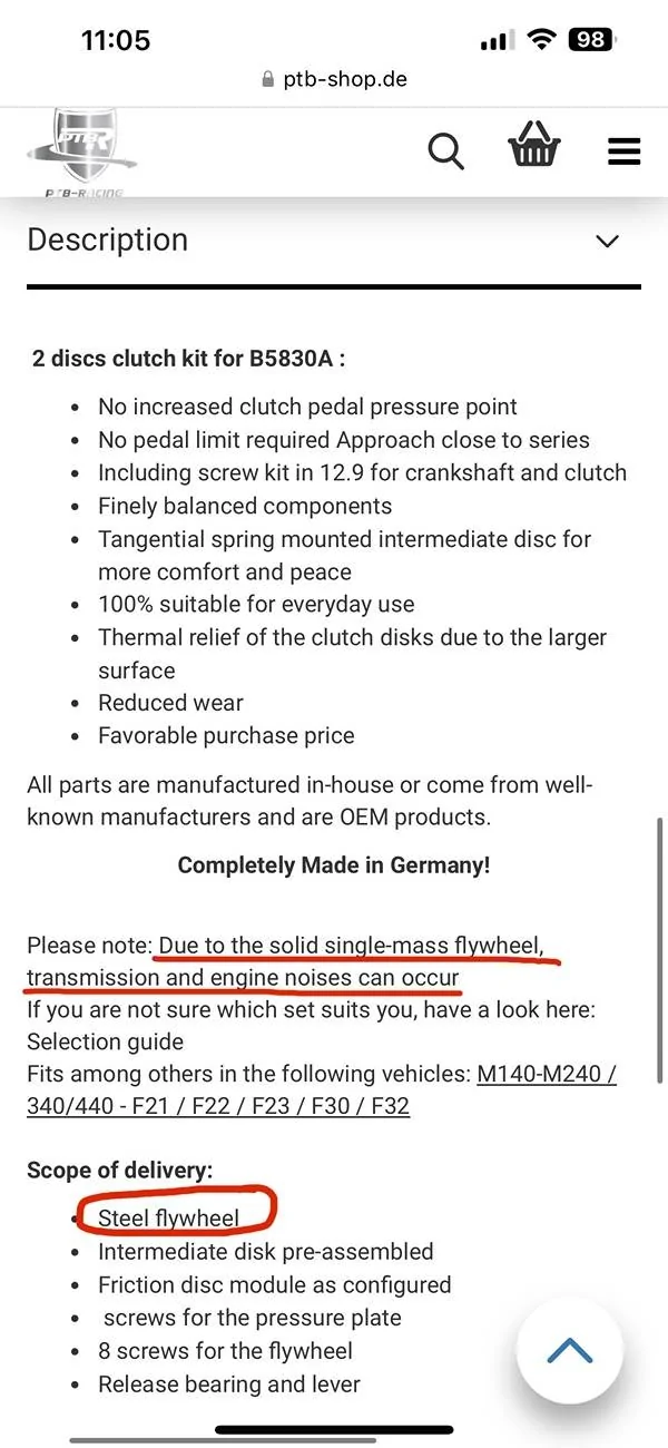

Does that include a new flywheel? I’m not sure if Google translate is working properly but it seems like it does.
Yes the clutch kit they offering on their website, it comes with steel flywheel “SMF”.
https://www.ptb-shop.de/Kupplungs-K...-M140-M240-340-440---F21-F22-F23-F30-F32.html
You can email ptb racing if you want “DMF”, they told me we can make your request. As you can see, on PTB website they don’t have the flywheel option selection it just come with SMF but I believe they will add this option soon on their clutch kit website page, but for me I’m happy with single mass flywheel (chatter time) ?
SMF > single mass flywheel
DMF > dual mass flywheel
here is a short YT video showing why the SMF makes more transmission noises compared to DMF.
