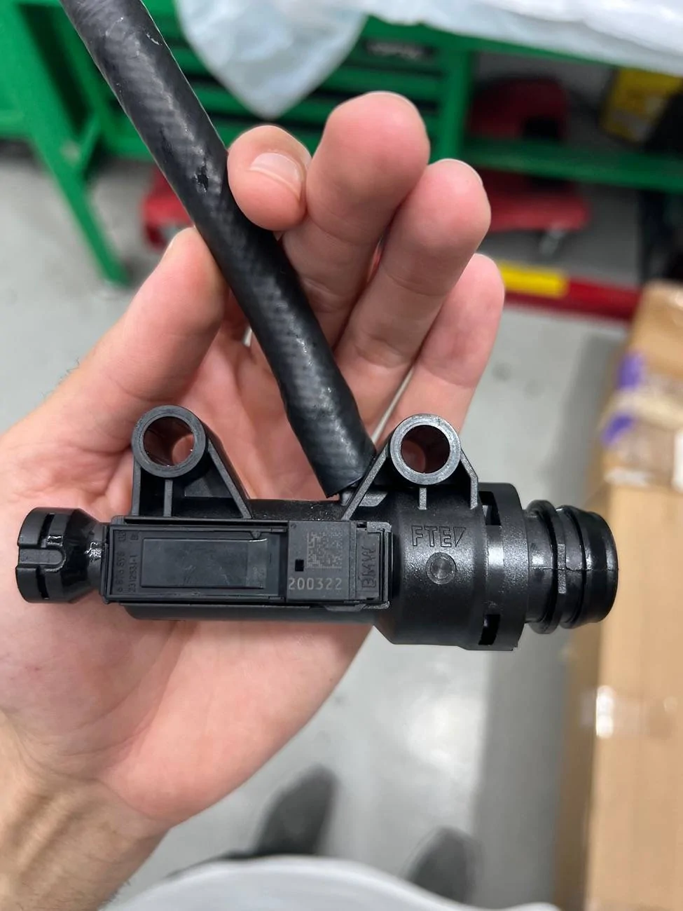

People are starting to recommend the original slave over this HRB. Guess another case in point
In general allows for less pedal effort and shorter throw since the clutches are now stiffer to hold the added power. Although it seems that with CM all you get a fun ride on the tow truck.

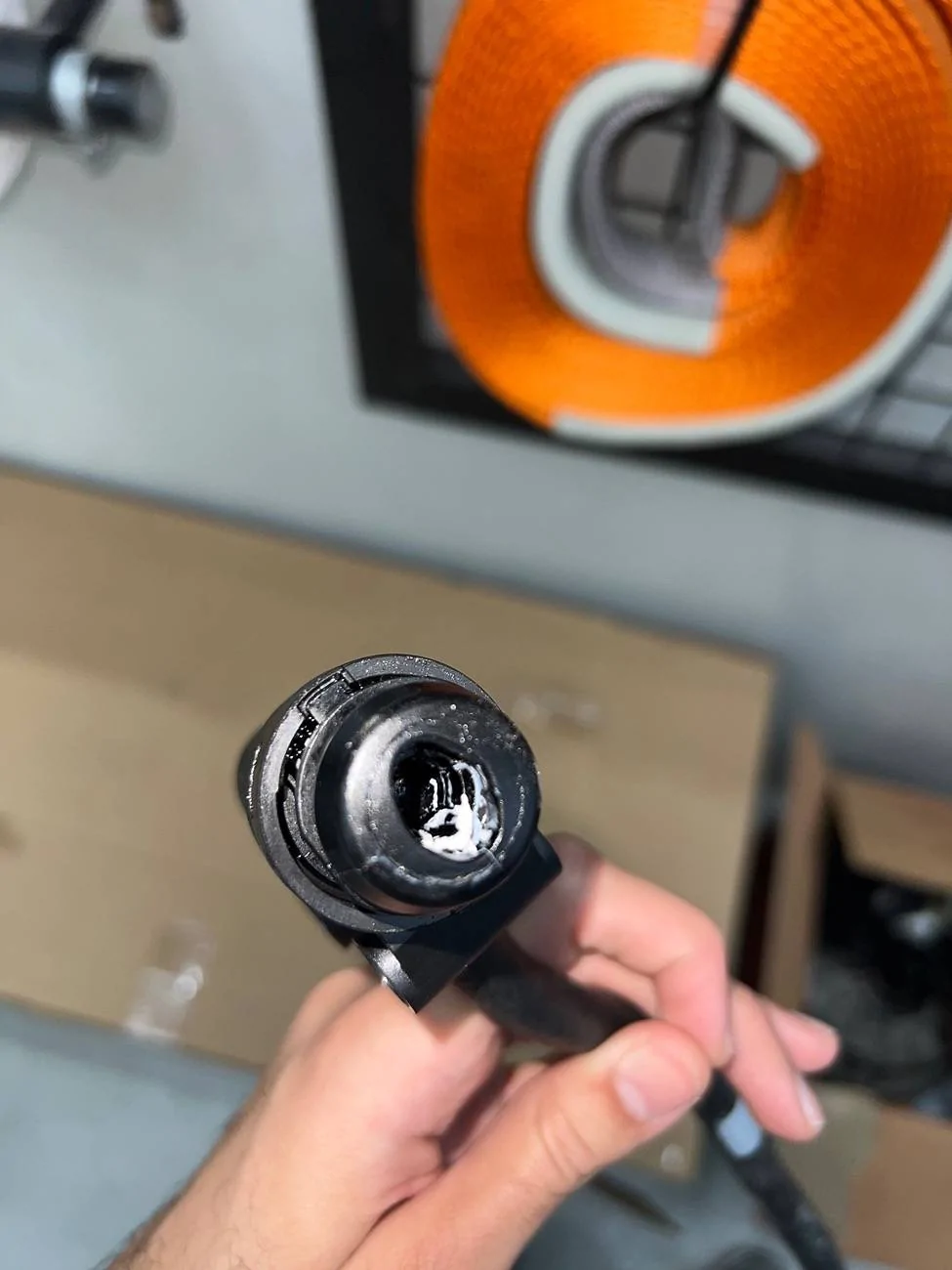

Pedal effort is much higher with their HRB and clutch feel is worse. Mine failed twice, the first time during break in when i wasn't even pushing it. Everyone I know who purchased this part had a failure and CM is refusing to refund the customer or their distributor.

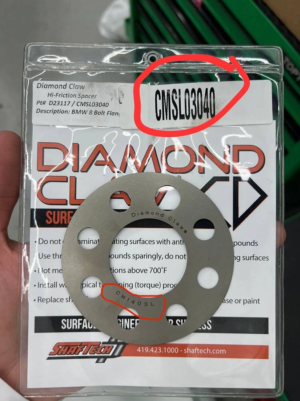

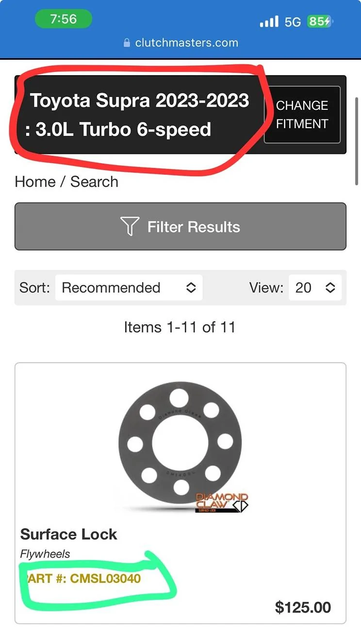

Wait a minute, FX1000 clutch kit already comes with a bearing for owners that wants to go with OEM fork system?! so what is the new thing here? ?
and one more thing, the wrong part number I received for the surface lock they can’t refund it ?! They mentioned it before and they said it’s ’mispackaging’. Or it’s my fault on this mistake as well?

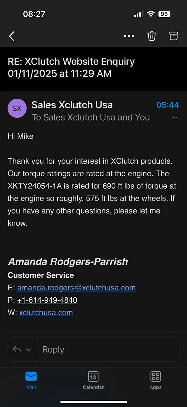

For 500 lbs ft of torque it seems the DM clutch would be more cost effective, also holds 500 lbs ft
https://www.driftmotion.com/DM-Stage-3-Clutch-Kit-for-MKV-Supra-2023-24-p/dm1135.htm
I agree, especially since it's Kevlar, and presumably full faced. I have a full faced Kevlar clutch in my K swapped BRZ and after 15,000 miles upon inspection it looked like it lost maybe 20% of it's life? And that was with a good amount of abuse (clutch kicks, racing, etc). I'll likely go this route with the Poopra once time comes to replace the OEM clutch.

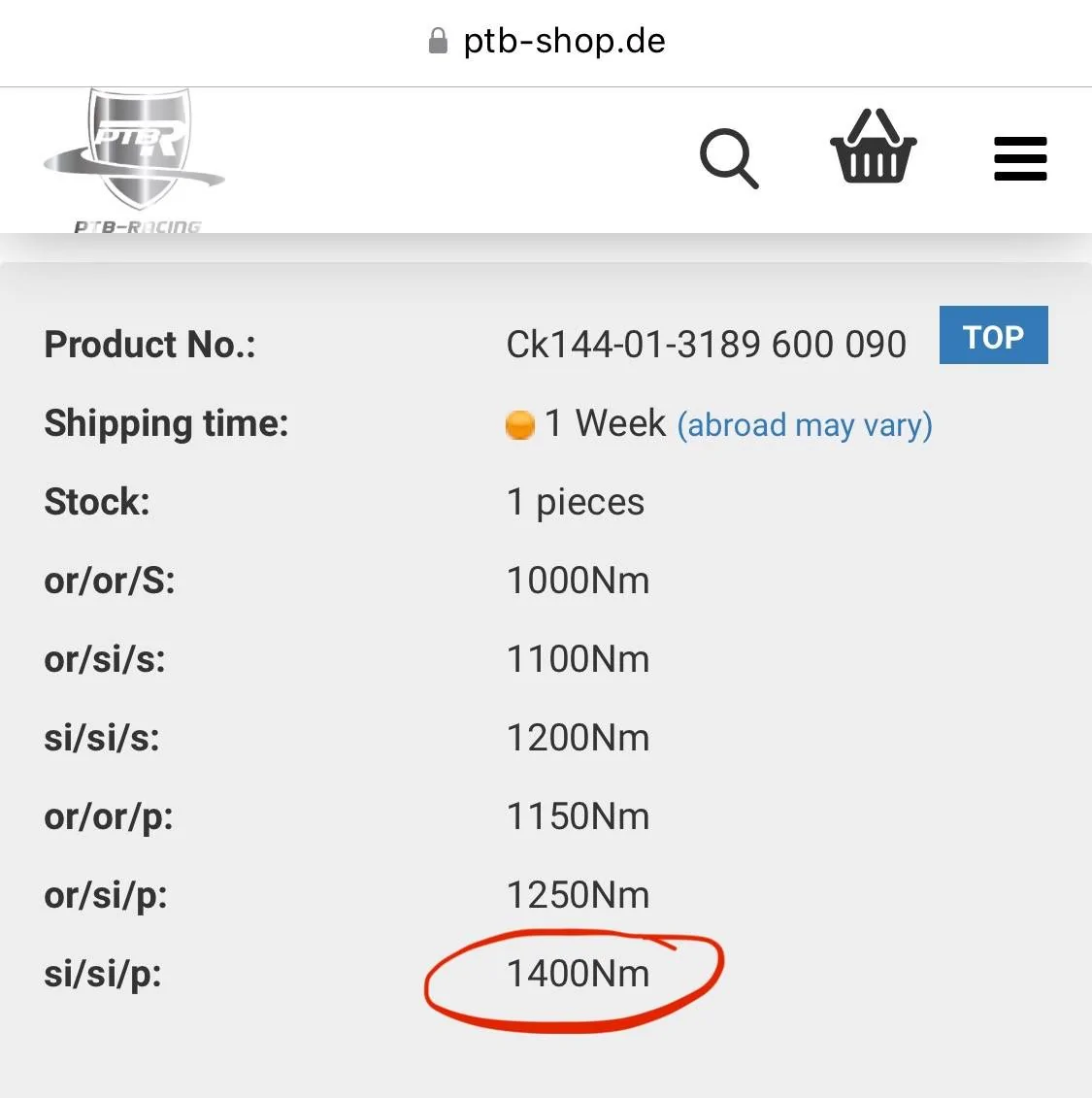

PTB is offering many options that even can handle 1000 lbs ft.

I just installed the PTB twin disc clutch with their SMF flywheel. I can’t wait to drive the car really excited. I’m waiting to receive the clutch master cylinder, mine has blown up completely cause of the CM HRB > worst company ever.

great to see more options for our MK5 but 6 puck wouldn’t be street friendly unfortunately and is it sprung or non sprung, missing photos and some details I guess.
I asked them, looks to be sprung. I asked earlier about pedal pressure and the response was “a little more than stock”. I’d be interested if someone does go for the DM.

sprung Kevlar full disc seems street friendly
