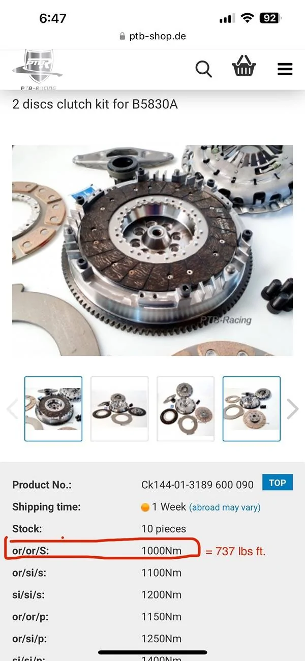

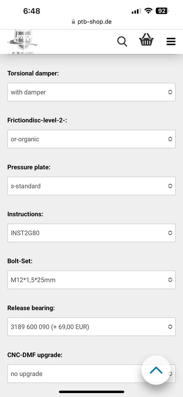

I really recommend PTB clutch. Smooth gear engages, clutch pedal feels exactly like OEM and it handles torque well. Even my friends who tried my car, didn’t believe it’s an aftermarket clutch. Mine is twin disc clutch with single mass flywheel. You barely hear the chatter sometimes never.
Above is my clutch preference, 1000Nm is more than enough for me.
