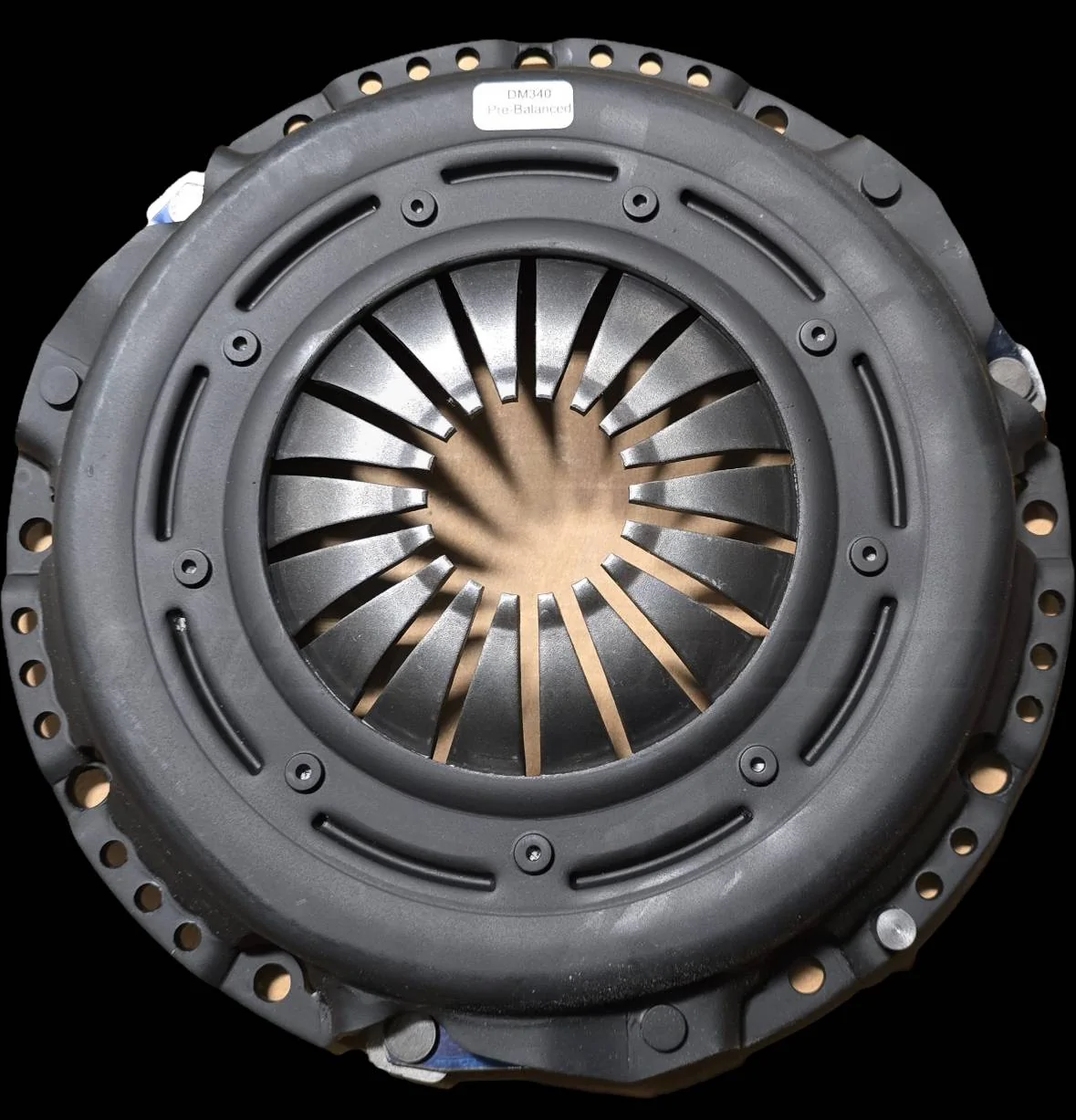

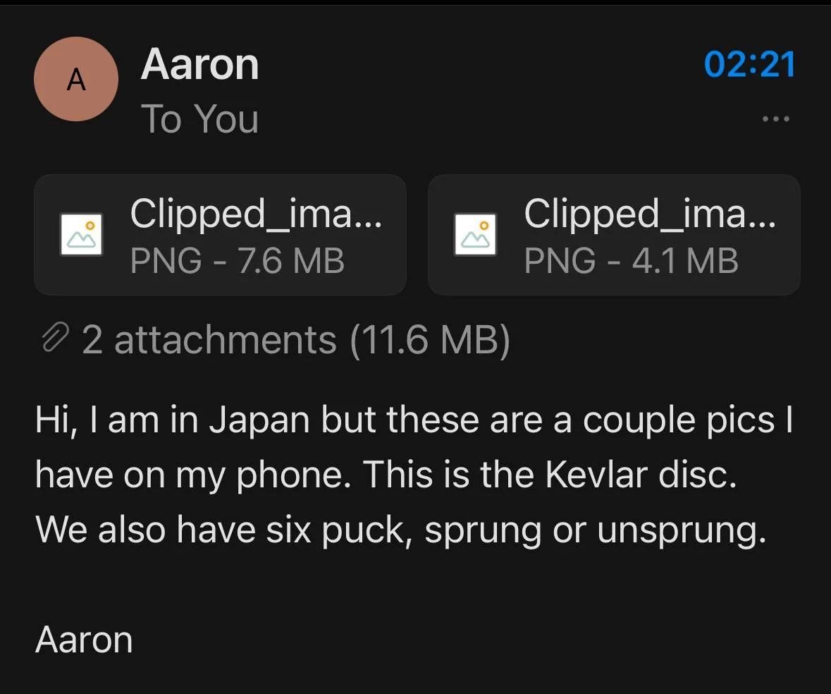

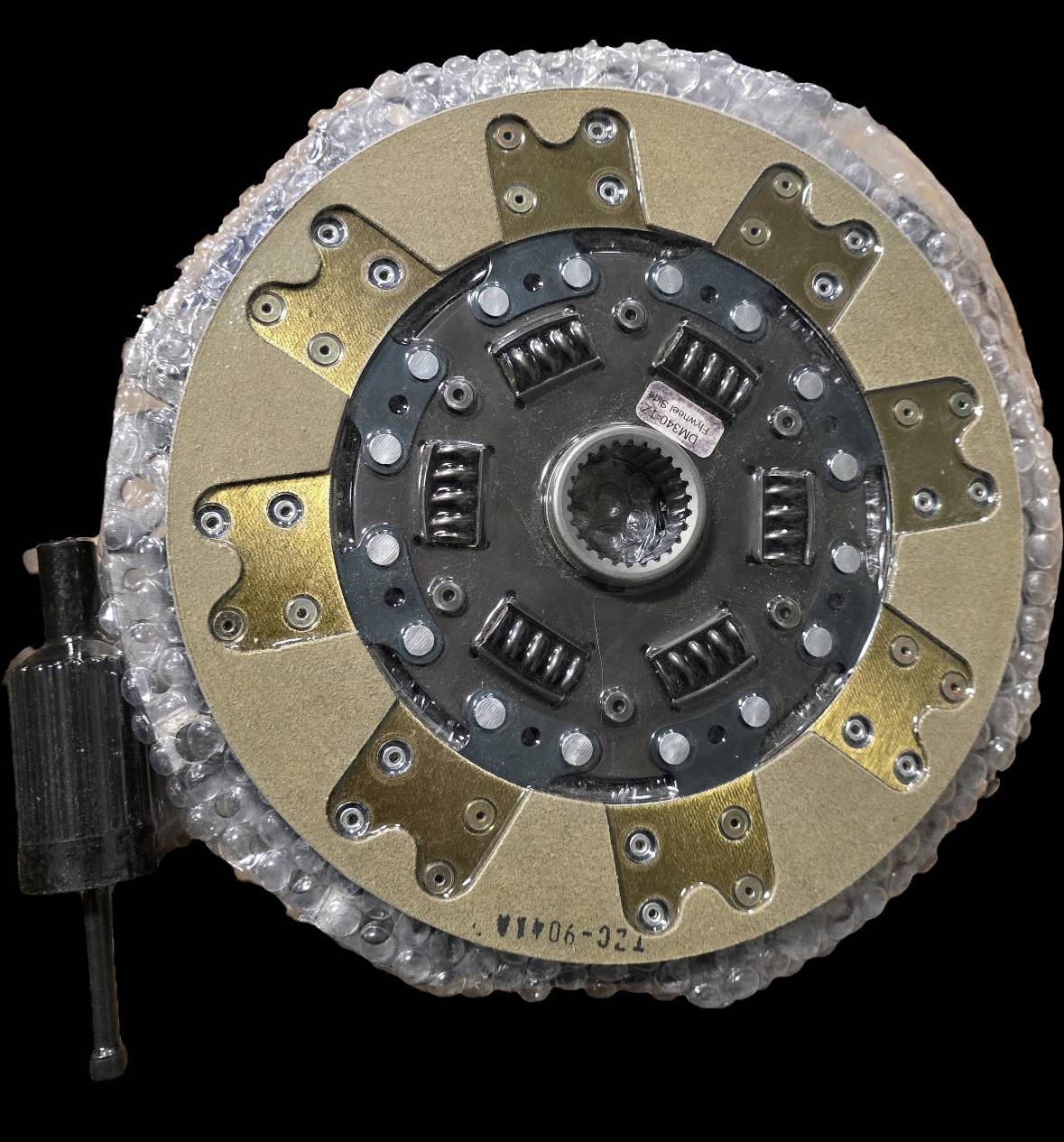

I asked them, looks to be sprung. I asked earlier about pedal pressure and the response was “a little more than stock”. I’d be interested if someone does go for the DM.
I've never seen anyone mention hard numbers with regard to pedal pressures for aftermarket clutches. Seems to me aftermarket manufacturers could easily tell you how much in percentages the clamping force was over stock so people could make a decision on what they are prepared to accept before they buy a clutch kit. "a little more than stock" doesn't cut it for me these days.
