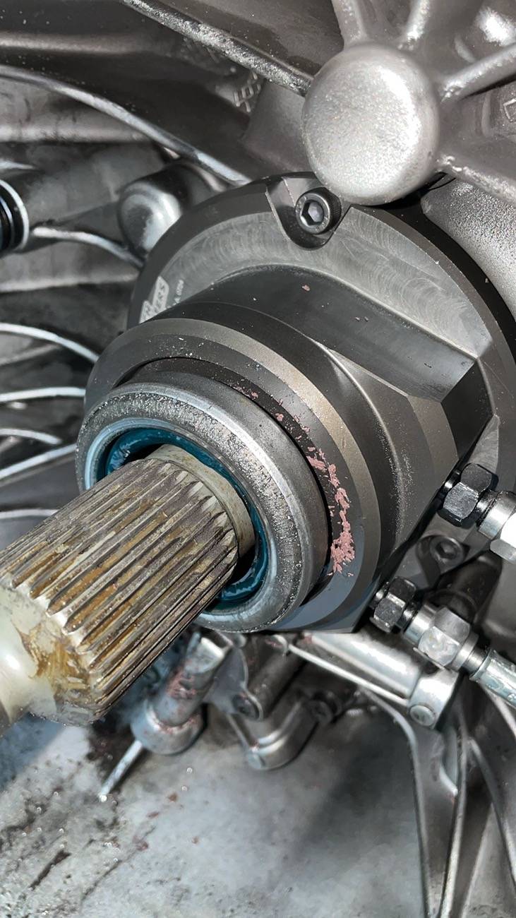

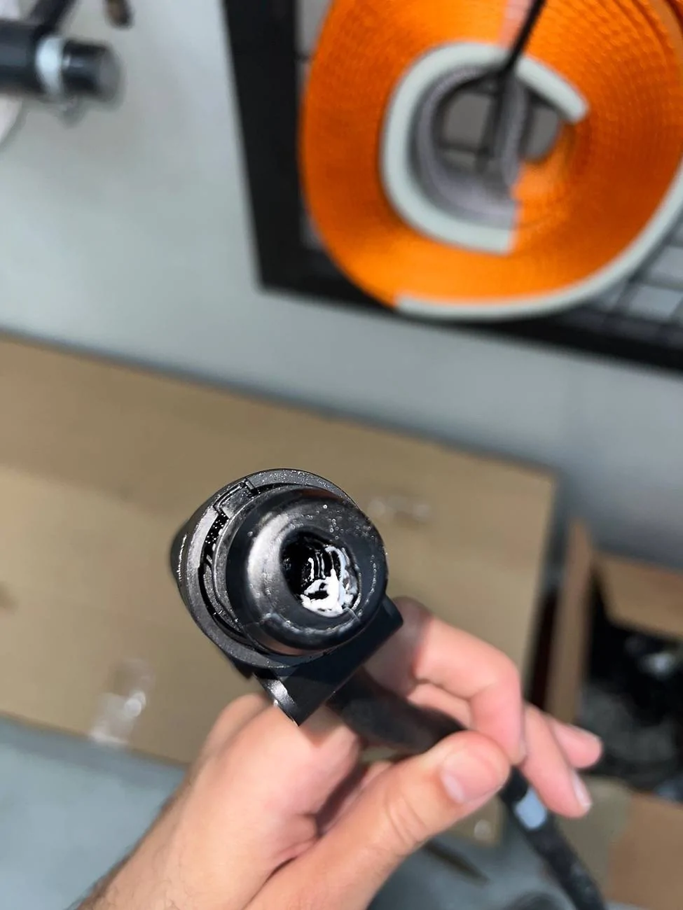

this what you get when you buy products from clutch masters. HRB blew up
People are starting to recommend the original slave over this HRB. Guess another case in point
Seems like poor design choices were made allowing it to extend past the appropriate range. Sad to see things like these on parts that are by no means cheap. Looking forward to your feedback on the PTB clutch.

What would be the benefit of a HRB over a slave cylinder?
In general allows for less pedal effort and shorter throw since the clutches are now stiffer to hold the added power. Although it seems that with CM all you get a fun ride on the tow truck.
add to this, HRB not only blows itself up, it also blows your clutch master cylinder like it did to me. Now I can’t find this part here in Qatar so i ordered it from Germany today. So yeah, two weeks from now. All that cause of CM cheap products.
