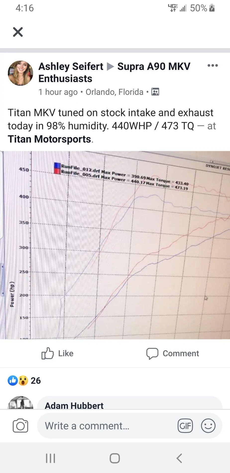

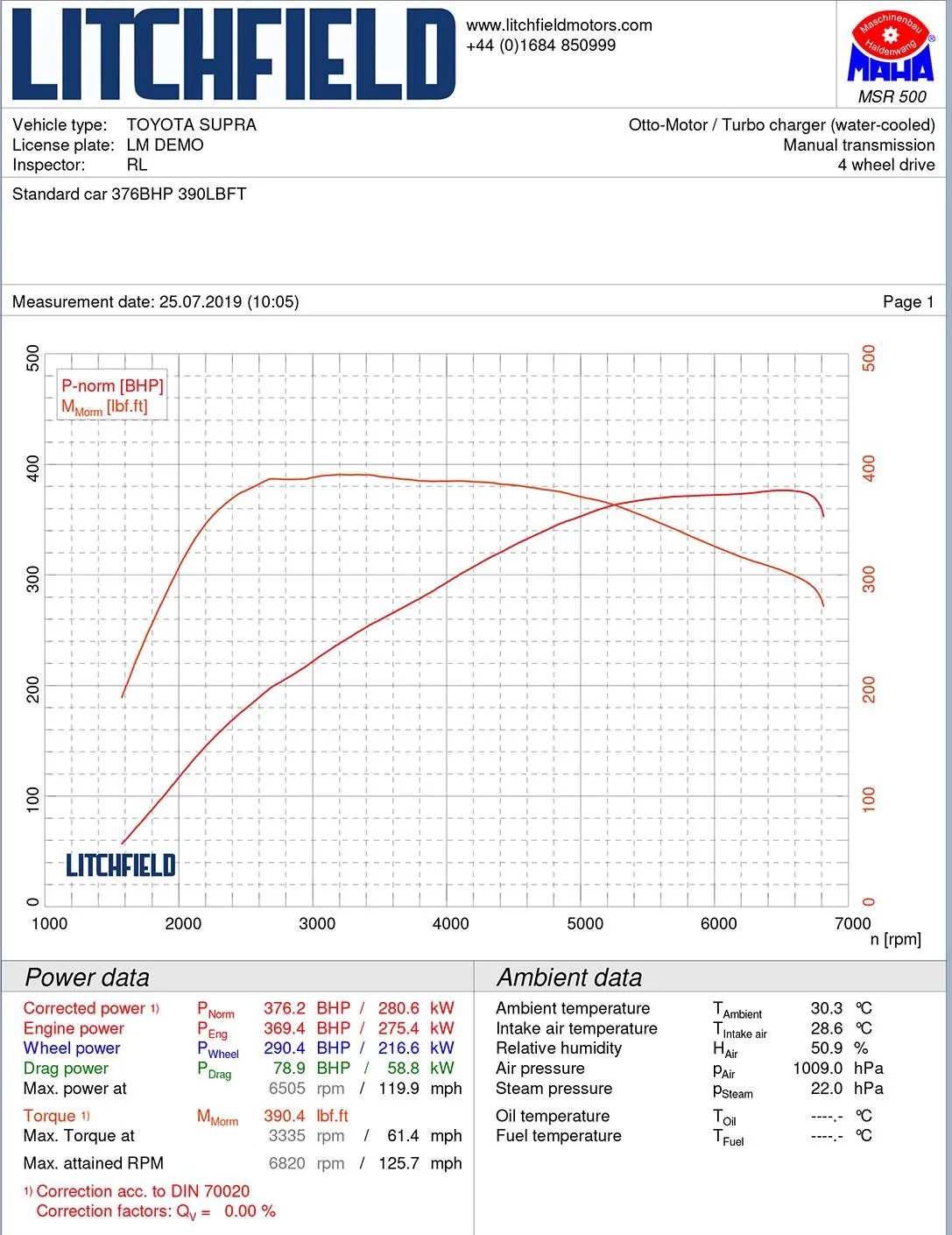

All I'm saying is I'd like to see some verification of the perf stats they were able to attain, off a production car.
I've seen 4.0 for 0-60 and 12.5 quarter elsewhere so far on stock production cars, which is close enough for regional, altitude and temp conditions to account for the difference. But a 40lbs/fr diff on a dyno jet is pretty big imo so I wouldn't mind some other sources to back up those numbers.
The high torque is due to it being in 5th (1.3:1) gear not 6th (1.0:1). A simple rough calculation converting the ratios would give about 330lb.ft of torque.
Regarding the torque converter locking up, look up torque converter torque multiplication. Basically when a converter is unlocked it acts like a bigger gear driving a smaller gear by fluid. Once it's locked, the ratio goes back to 1:1 reducing the torque output.
Sorry, but it doesn't really work that way. Gearing/mechanical TQ multiplication doesn't influence dyno measurements as you've described. If the engine theoretically output the same TQ at the same RPM in say 1st gear as it did in 6th, the dyno would read nearly the same result. All the dyno knows is how quickly you accelerate the drum/hub from RPM X to RPM Y over time.

No it was their first tune. Made 336hp 368 stock
Sorry, but I'll take the word of mainline. Different gears do give different torque readings unless the dyno is setup to correct them. There is a shop in my area that is known to make insane numbers of torque because he does 2nd gear pulls to inflate the numbers. You could also simply change the tire size on the dyno configuration and see how it can affects torque.
https://www.mainlinedyno.com.au/images/downloads/DYNO_TORQUE_FIGURES_-_THE_TRUTH.pdf
Even if we disregard how dynos measure torque, the car's ECU could simply output different torque numbers at different gears. Only way to know for sure is get a car on a dyno and test it in different gears.
