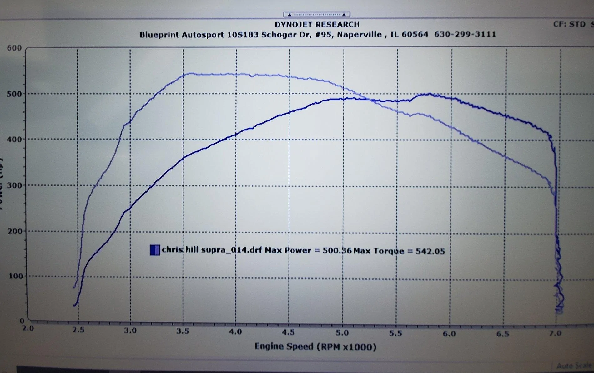

AWD dyno with all the rollers going. It's about the same as the Dyno Dynamics showed. When I toss her on a Dynojet, she'll show the high numbers that everyone else is seeing.
The DD they played with correction a bit I discovered. Normal, was about dead on with what toyota claimed.
It would be interesting to see the SuperFlow graph with the various correction factors/filters applied. The CF utilized on your graph is definitely the heartbreaker one. I have graphs from them in both "WhlPwr/WhlTrq" and "SAE HP/SAE TQ" both of which are much closer to Dynojet numbers (comparing the same car/setup), i.e., SuperFlow "SAE HP/SAE TQ" of 529.5/476.8 compared to 546.4/487.1 on a Dynojet using STD correction, Smoothing 5.
Nice numbers on CES's dyno! They're a good group and I'm excited to see how they progress with their shop car.
RE: 15:1 AFR at WOT --- that's definitely much leaner than norm even for a DI car; however.... getting an accurate AFR reading at the tips through cats and a stock exhaust, particularly one with valves can be problematic, in my experience. It's very possible the sensor is not getting an accurate reading due to positioning, etc..

Direct injection allows you to run different AFRs to standard port injection. You can run a lot closer to stoich without risk of preignition.

Would still be nice to see the AF graph read off a wideband before the first cat. The dip at 5000rpm is completely missing in this one. It is really hard to get reliable numbers off a divided exhaust too. Back when we had annual emissions tests in the Vancouver area, I would always get the techs to stick the probe in the drivers side of my twin pipe muffler. That one branched off the other side and is barely used under full throttle, aced that test every time lol.
But thanks for doing all the dynos Goose, those are some great numbers on the dynojet! I would quote these to anyone that asks over the C&D 425 one on the preproduction car. Now the question is can you pull off a 3.8 0-60 :D
That's a pretty solid torque curve!

The high torque is due to it being in 5th (1.3:1) gear not 6th (1.0:1). A simple rough calculation converting the ratios would give about 330lb.ft of torque...
That's not how chassis dynos work. You'll get about the same HP and Torque figures at the rear wheel in every tested gear on a chassis dyno because the dyno ""knows" engine RPM, tire velocity and static roller weight (inertia chassis dynos). While torque converters can create some anamolies, this can be directly observed in vehicle's equipped with manual transmissions.
People would be recorded drive wheel torque in the 3,000 ft-lb plus range I new Surpas (dyno'd in first) if torque output represented torque at the tires due to gearing ratio multiplication.
Testing in the 1:1 ratio for any vehicle is considered protocol because it helps established a consistent database.
In theory, lower ratios (especially below 1:1) can be expected to yield ever so slightly LESS peak HP and torque figures because they exhibit greater frictional losses.
Those who've tested their (same) vehicle in various ratios on the same day on the same dyno (inertia in particular) know this to be true through first hand experience.

Yeah, we did it in 6th at Performance Factory, and 5th, and the numbers were essentially the same. Only difference is the speed, and how long the run takes.
