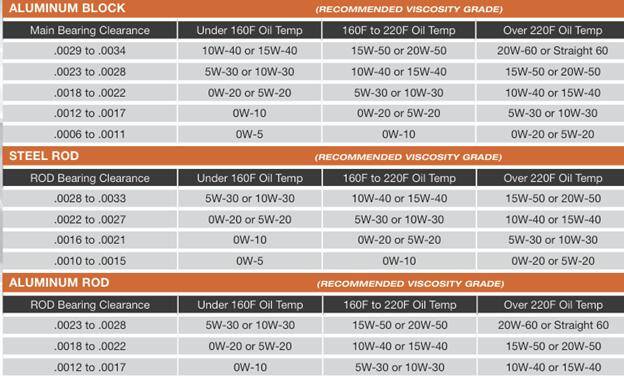

@concept after all your crying...
I like these apples better:
For your Toyota GR Supra’s B58 engine, the recommended oil is 0W-20 C5 synthetic oil that meets ACEA C5 and API SN standards This specification is particularly called for Toyota’s GR Supra oil and is in line with the requirements for the BMW B58 engine that the Supra uses. It’s important to use the oil rating recommended by Toyota to ensure optimal performance and longevity of your engine. If you’re driving in conditions that vary from normal daily use, such as high speeds or extreme load conditions, the owner’s manual suggests that an oil with a higher viscosity may be better suited.
However, for most driving conditions, sticking with the recommended 0W-20 C5 synthetic oil is the best choice.
The B58 uses forged 4340 steel connecting rods, making them suitable for high-performance applications. The rod bearing clearance is typically between .0010 and .0020 inch.
Average oil temp during street driving....220?
Liqui oil recommends 0W-20 full synthetic oil for the GR Supra. I spoke to their tech representative (Stephan) and he verified that their oil meets Toyota’s/BMW’s (for the Z4 with B58) specification for the oil, and that their specific 0W-20 for the Supra 3.0 is the correct oil. Other, higher viscosity oils may void the warranty.
Always question the source of information about certain mods. If the source is a guy who tracks his car often, then his advice is more likely to be accurate for those who also track their cars.
However for normal street driving at mostly legal speeds, stick with the Toyota and BMW owner's manual. If I move to Germany and commute at 120 MPH for 45 minutes on the Autobahn, then yes, I will change oils.
8,806
17,269

The list clearly shows "technically suitable" oils for a B58. And it shows "Recommended" oils. Some of you are going with the technically suitable list, others either the recommended list. Seems as long as people have the information to decide which side of that fence to be on, they should all coexist happily . But apparently not?
For your Toyota GR Supra’s B58 engine, the recommended oil is 0W-20 C5 synthetic oil .... It’s important to use the oil rating recommended by Toyota to ensure optimal performance and longevity of your engine.
And another thing: Liqui Moly has many oil viscosity choices, so what does selling oil have anything to do with their recommendation?
