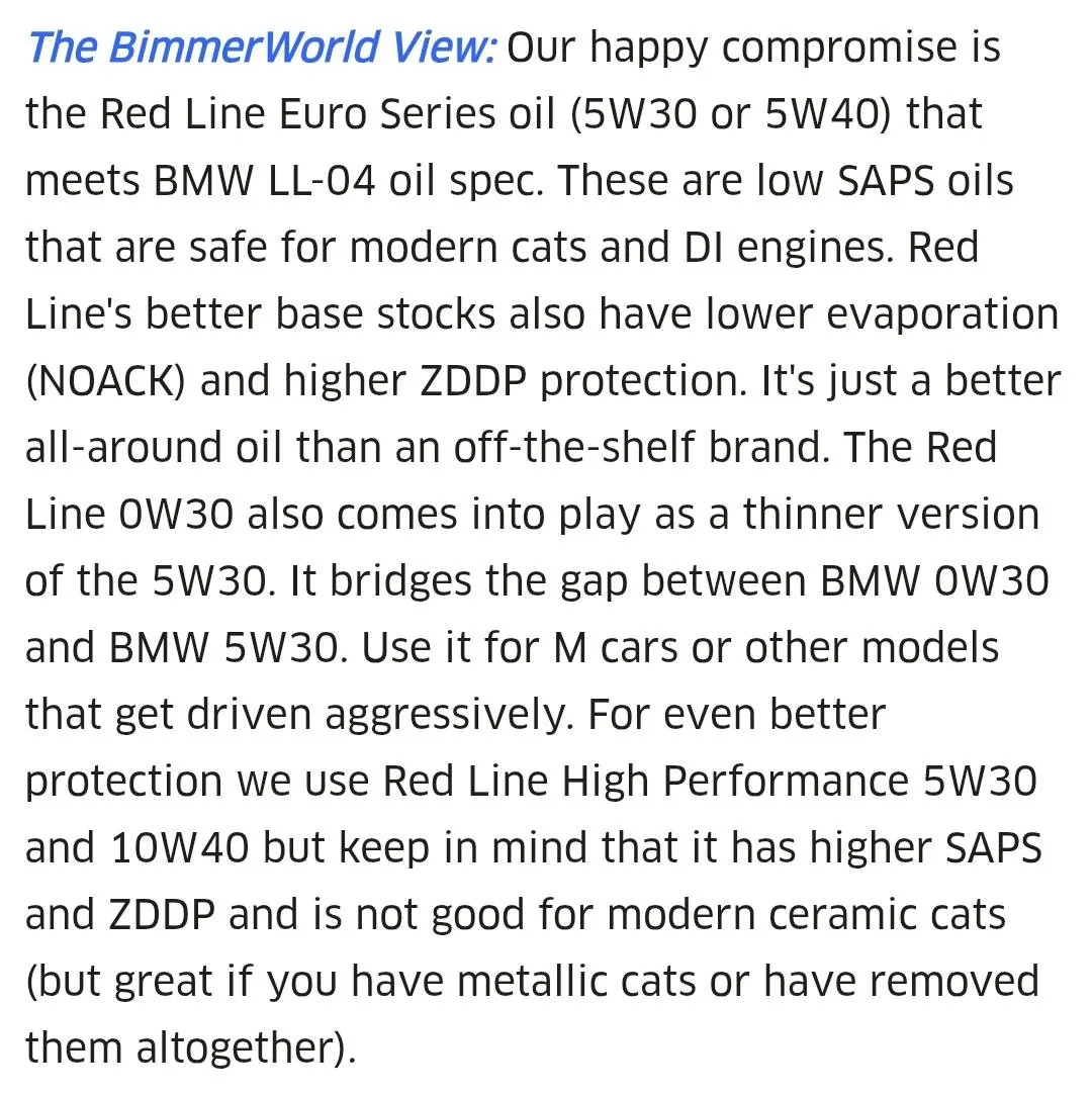

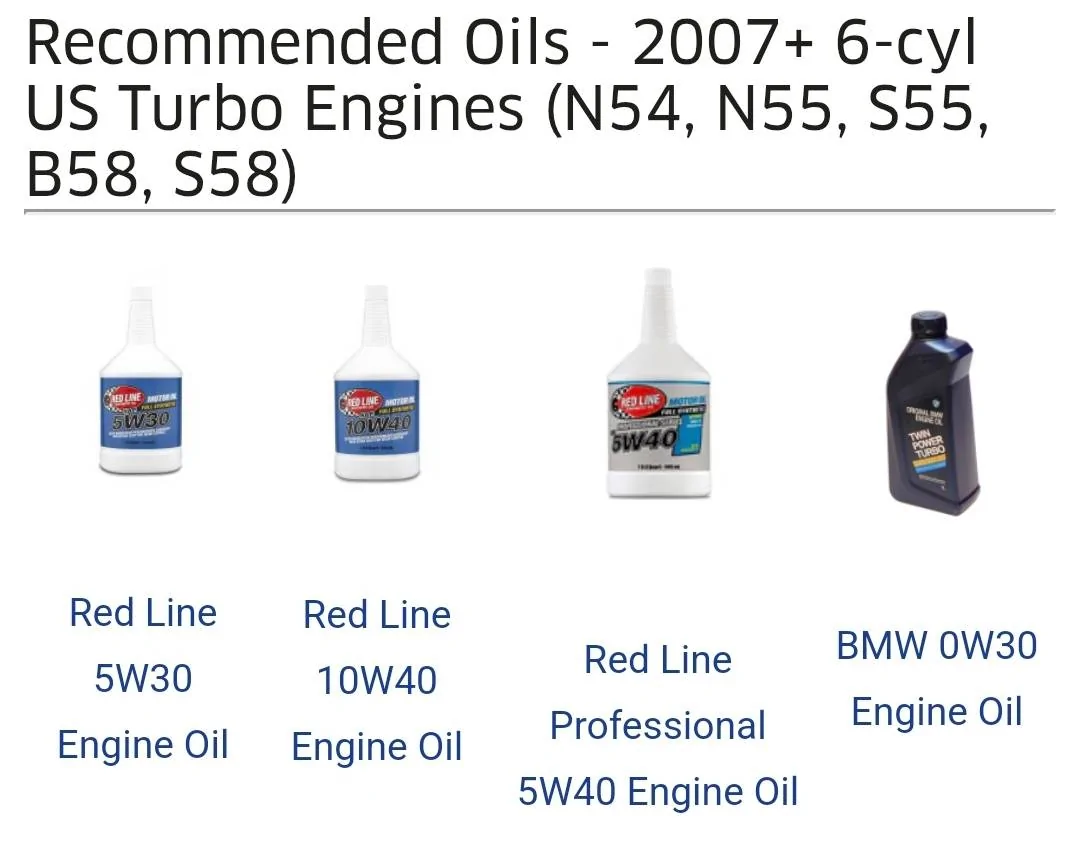

I didn't see it posted in this thread but thought this was a good read lots of info summaized in one place, I believe this is from a credible source:
https://www.bimmerworld.com/BMW-Engine-Oil/#oilrecs
Also see bimmerworlds oil recommendations attached.
So the takeaway is if you frequently beat on the car, especially when its (oil is) hot, factory spec oil probably isn't best choice for engine protection.
My opinion it is probably ok for the kind of person who has a stock engine, emissions system, turbo, uses pump fuel, drives the car in traffic, and actually uses the start-stop function (I personally don't), cares about fuel consumption and the environment, etc.
Only way to really know is used oil analysis. Since I had the car brand new, I have 2 UOA reports so far that show no cause for concern on the 0W-20 LL-17 FE+ spec oil. I'm not a track junky, but do enjoy the car, regularly beaten on every drive. Stock engine, pump gas. I live in SoCal so temperate climate and stuck in traffic often.
That said I will switch to a 5W-30 that meets the LL-01/04 spec after my warranty runs out. I'll continue the UOAs and see how it goes.
I'd add that beating on the car for extended periods of time. In Southern Cali, this is a recipe for a reckless driving charge.
I'd add ..."driving normally, most of the time with occasional brief bursts of speed beyond 100 mph."
If your oil temps are spiking beyond 230 or 240°F, then your comment below may be warranted. Are you blasting up to 150 on the way to Vegas?
I'd be interested to see if your oil analysis, one year after switching is the same or significantly better.
