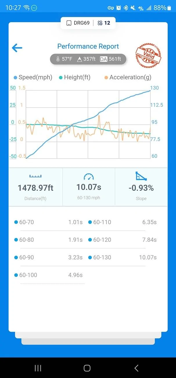

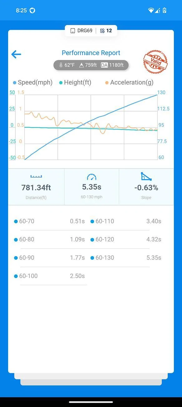

Well, another datapoint for the 6 MT.
Mods:
- Catless downpipe
- Armaspeed Intake
- Femto unlocked Custom tune by NVM
With god awful Washington 92, awful road, and we are still going through revisions of the map.
Damn Seattle area, not a single decent straight here, not one, I hate that here...

Nice to see similar mods and similar times. Did you shift into 5th on the 60-130?
Camus
Daniel.
Jan 16, 2020
175
176
Monroe, WA
2023 MT Supra, 2024 M240i xDrive
Yeah, I think 4th gear ends just before 130 mph, like 126 mph? Also, according to the logs, the power and torque curve are going down past 6000 rpm, so I might need to shift way before that.
I was thinking of getting larger wheels, that could reach 130 mph. Your acceleration graph looks cleaner, did you shift to 5th?
No stayed in 4th, you'll hit 130mph per dragy not speedometer just before redline like 6.9k. Your right though power wise shifting around 6k-6.2k is best but for this specific test riding out 4th is better. I had some throttle closure towards the end due to TC kicking in from couple bumps so need to turn it off and try again to see if it improves at all.

Interesting! I think the hard limit is 7000, so, I'll test that out tonight.
It makes sense, my 100 to 200 is decent, but the 60 to 130 is not that great.
Are you running custom tune?

No just MHD OTS for now. Be interesting to see if your custom times improve enough to make it worth it, I’ll be keeping an eye on any updates.

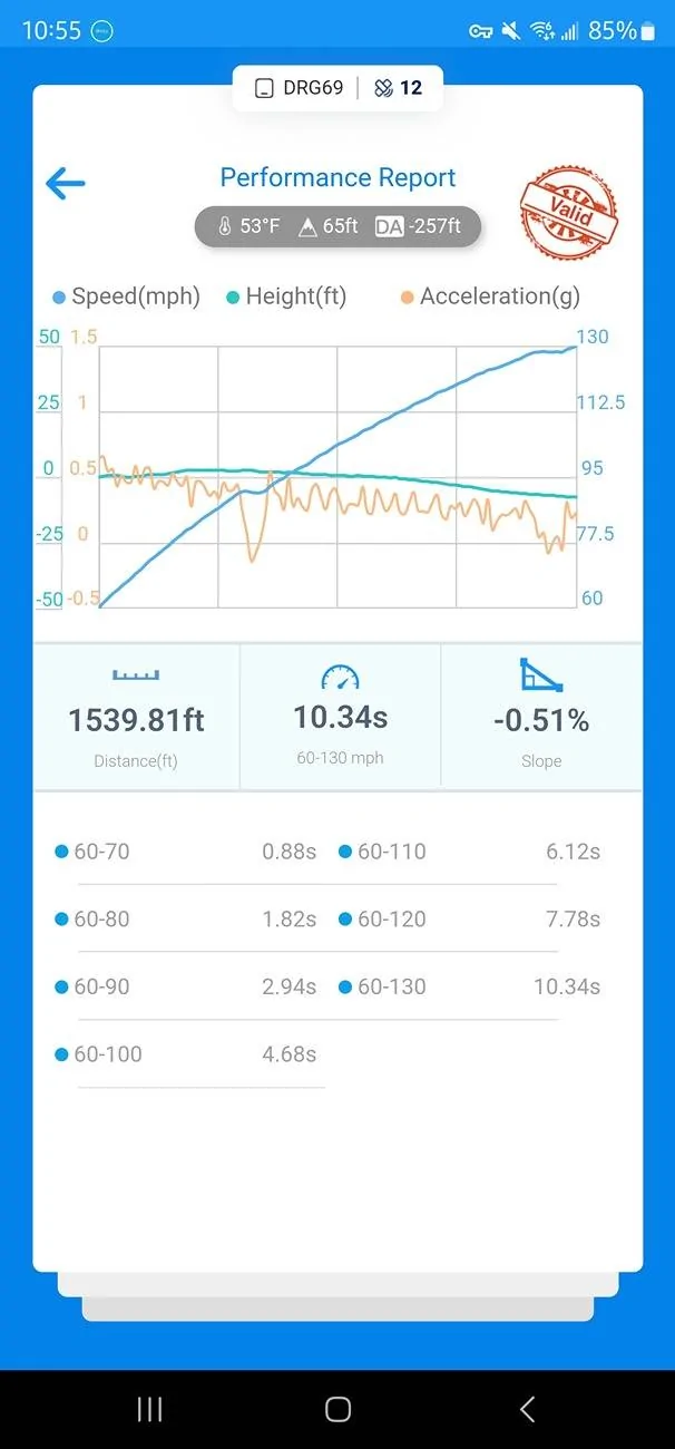

The 60-120 seems not bad. Do you have stock times to compare?

Not right now, but my plan for today is to test:
Stock
BM3 OTS 91ACN
BM3 OTS 91
Custom NVM new revision.
My guess is that stock will be in the 12s. All the other maps will be very close. The real difference will be E50, if the clutch can take it.

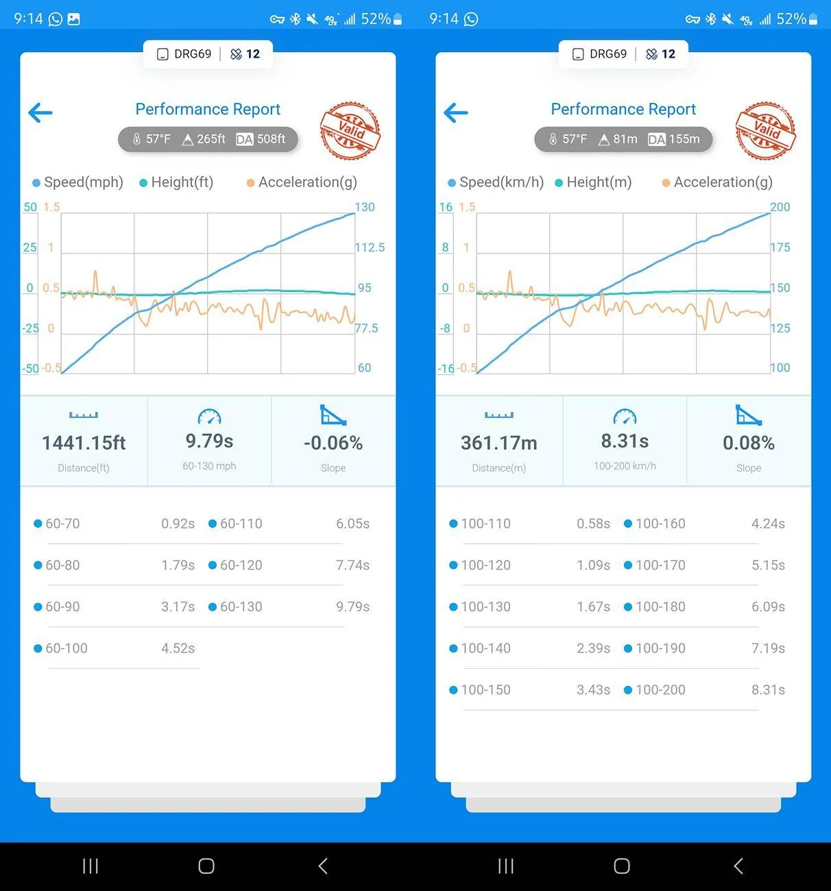

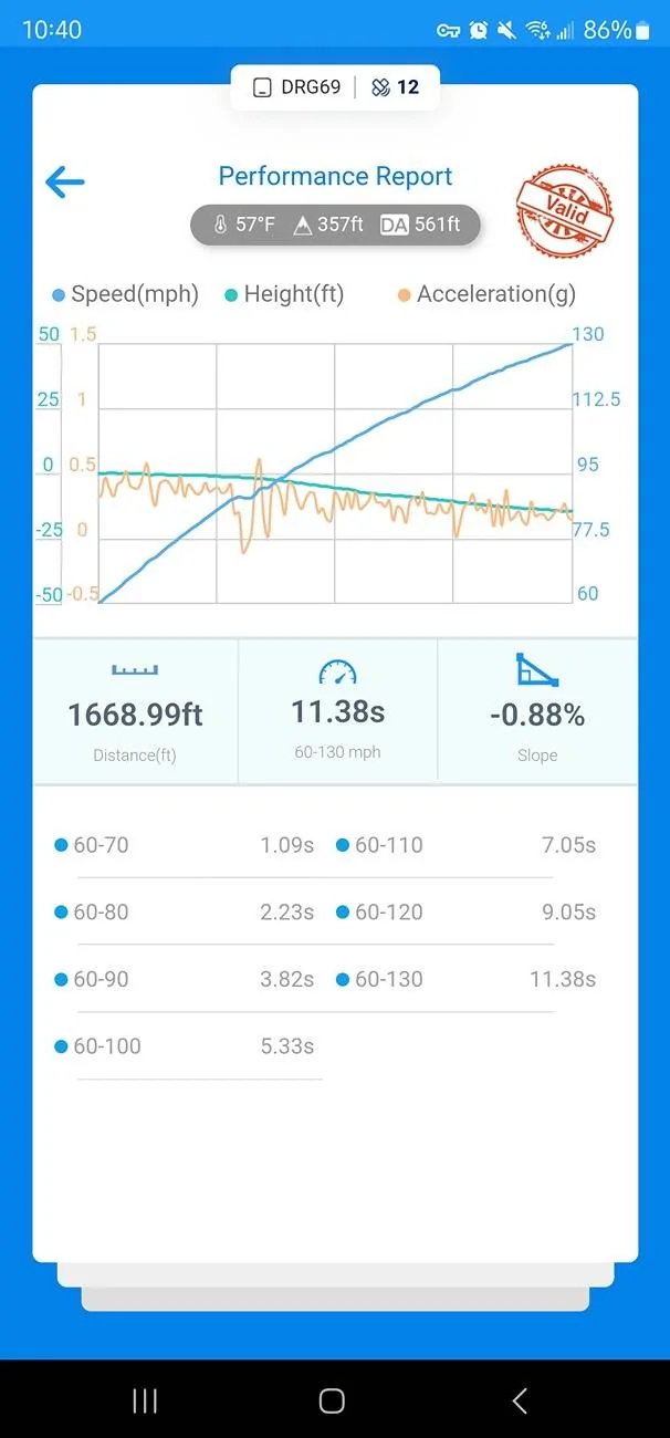

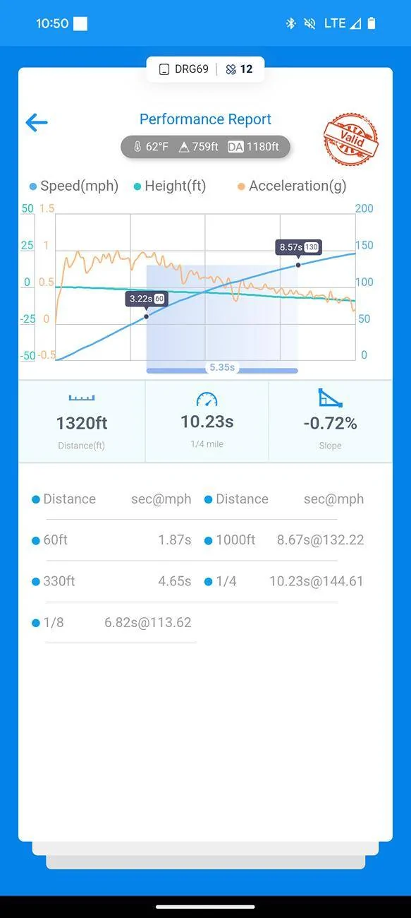

Again the MT Supra with Femto unlock and BM3. The stock map:
Then the OTS91ACN:
Sadly it started raining and couldn't try with the Custom Map, but using the antilag roll and not shifting to 5th, I think it will be in the high 9s.
I'll try tomorrow.
Edit, ok the Custom Map is great!
Quite an improvement. I think I can do a bit better though. Still, good enough for 91/92 ugly fuel.
