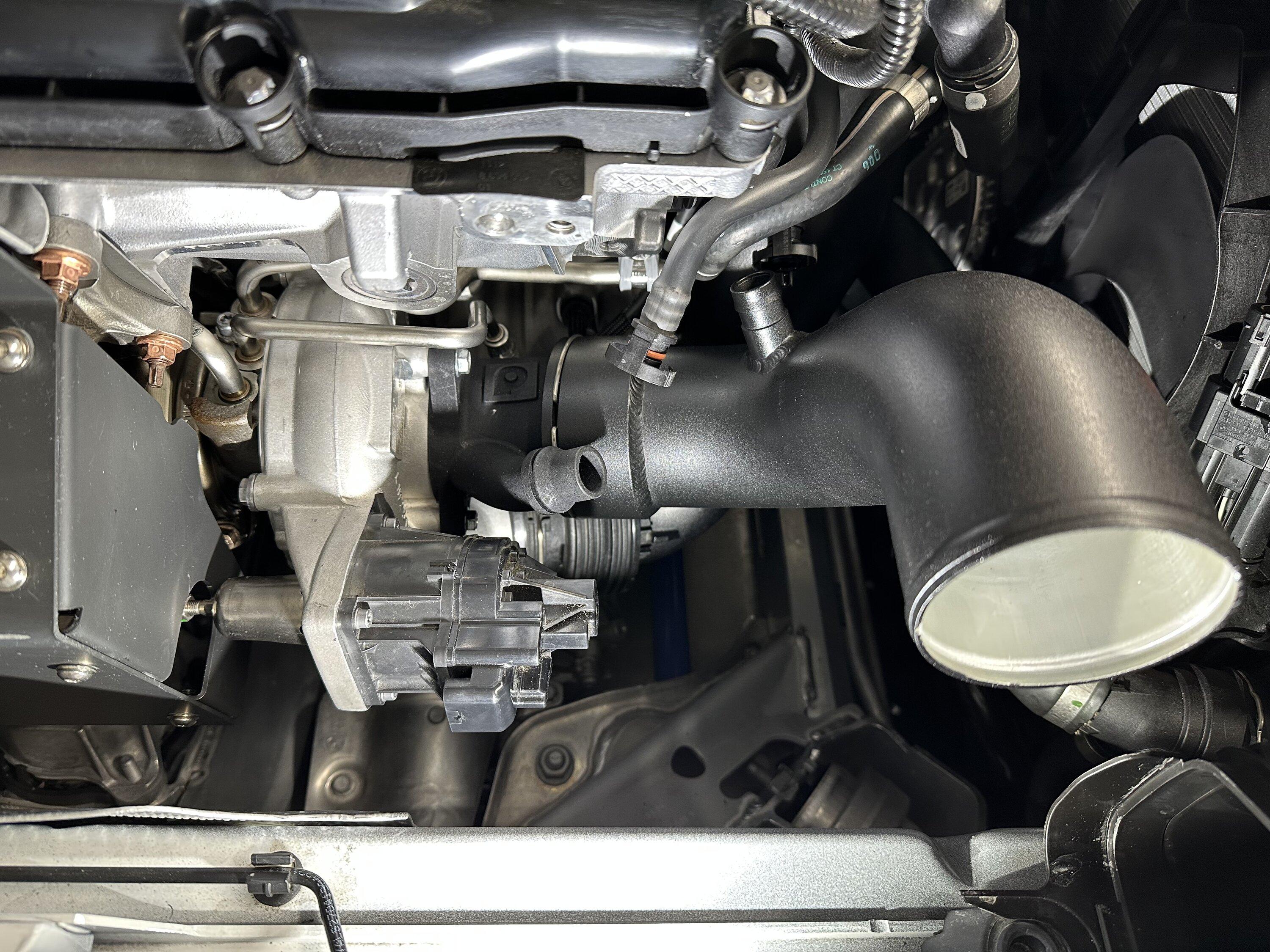

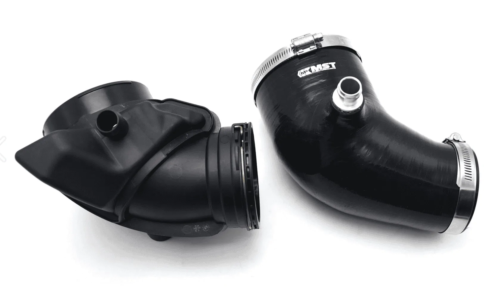

Anyone know if the FTP intake pipe fits in to the MST turbo inlet? Seems stock airbox is the way to go. So I'll probably just replace these pipes and get a snorkel intake. Honestly all three of those pretty much add up to the cost of one CAI anyways so seems to monetarily more efficient too. ?
Are you talking about this? If so, no. It replaces everything except for the inlet bolted to the turbo.
I'm running the FTP intake pipe with OEM intake. Fits and works great.

So correct me if I'm wrong, then your turbo inlet is the stock one? Or does the FTP replace that too? Hope that's not a dumb question lol.
The one in the photo is the Pure Turbo inlet, but it has the exact same connection to the inlet pipe as OEM.

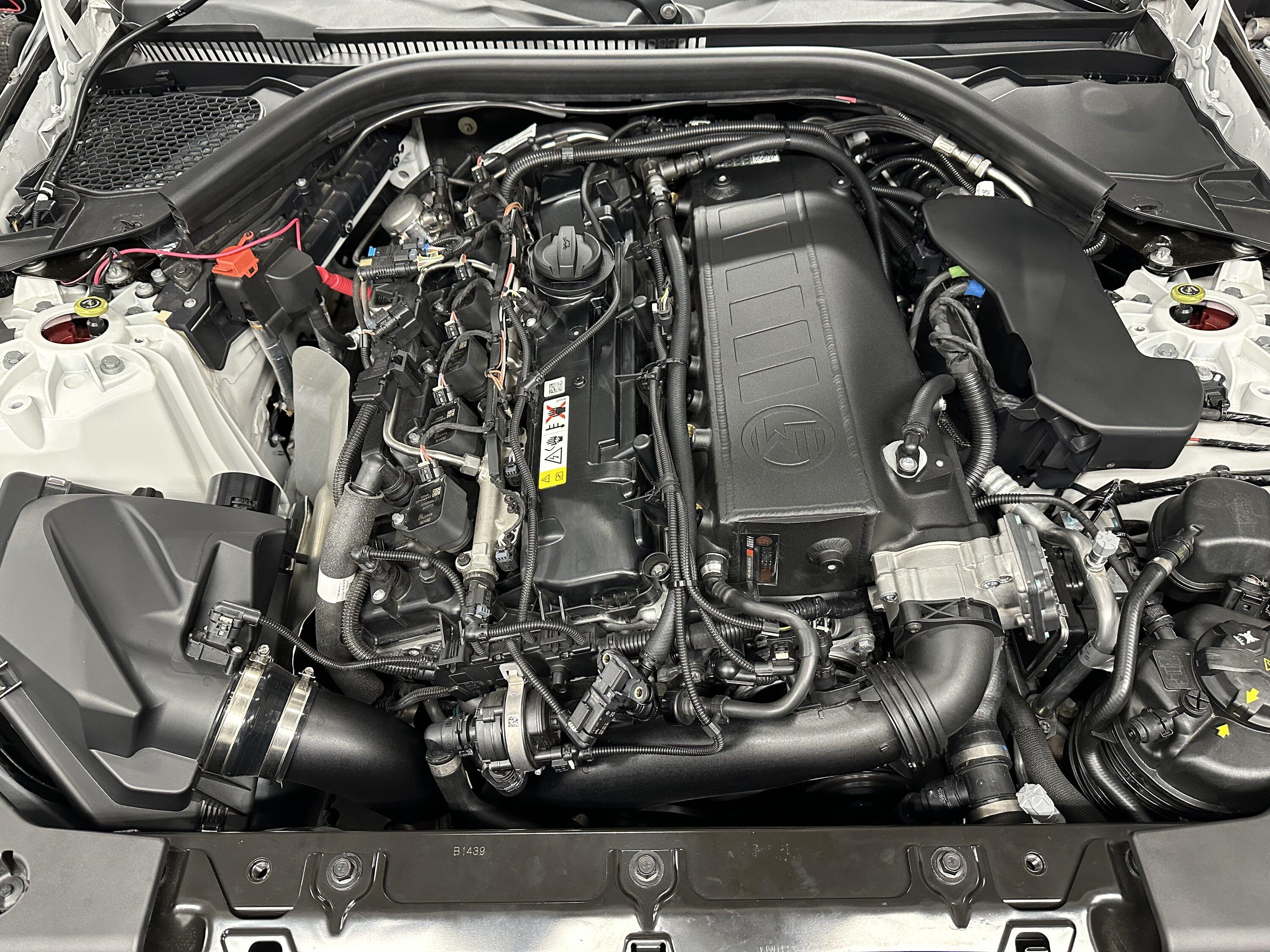

At first, I thought it was just me but others felt a drop in performance after I installed my CTS intake. It has a tall metal heat shield but the filter isn't really protected behind it. So then I decided to install the Verus heat shield and I felt a little return in power. Might have been a placebo effect or something...
Anyways, just prior to buying the Verus heat shield, I was pretty convinced that I was going to put my stock airbox back in with a K&N drop-in filter and do the resonator delete to sound like the cool kids. I'm staying with this setup until I move onto the next level with my power setup (i.e. RP 65 Omega turbo kit).
Hood scoop/vent, fender vents, snorkel, upgraded intake manifold, or a combination of these will keep your IAT's down and improve performance.
