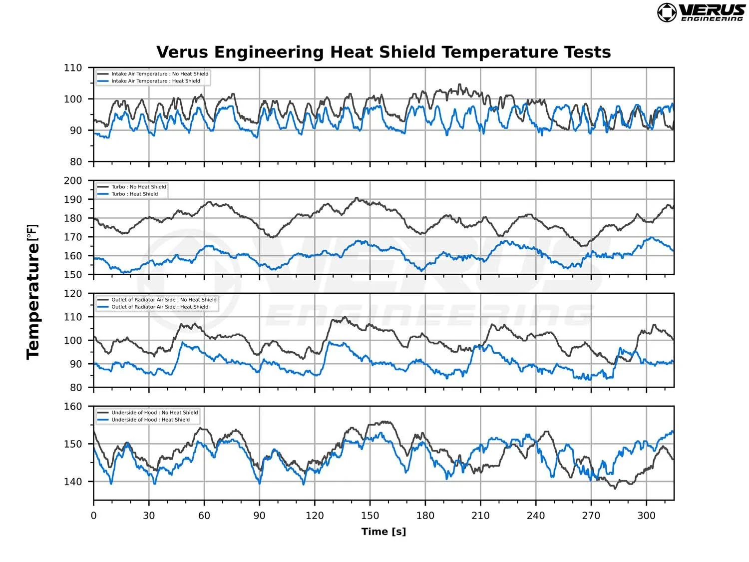

However, after adding the Versus heatshield, my IATs dropped a lot. Yesterday during 107F heat, I my IATs kept around low 120s. Last year it was around 140s with the same CAI. I do think if you want the sounds but not the heat, you need the heatshield and maybe some ventybois.
I’ve been seriously considering that Verus heat shield, but I can’t help but think that trapping that heat back in so close to the turbo can’t be good for it. It surely must increase temps around the turbo somewhat.
Has anyone seen this brought up anywhere before? I’d be curious to hear if there is any data around what a shield like that does to temps around the turbo.
Actually, Versus themselves did a bit of testing. See attached.
This is fantastic, thank you! Any chance you have a link to where this came from? I'd love to read more about this in context. I'm not seeing anything on the product page.

All in all, unless you're pushing lots of power, I see no benefit running CAIs other than sound. If you do happen to stick with CAIs, maybe pair it with a snorkel to give it a source of fresh clean air to help aid the cooling. Judging by my tests/logs, its clear that CIAs just isn't as efficient as the stock OEM airbox. Hopefully users running CAI + snorkel can chime in and share their data/experience.

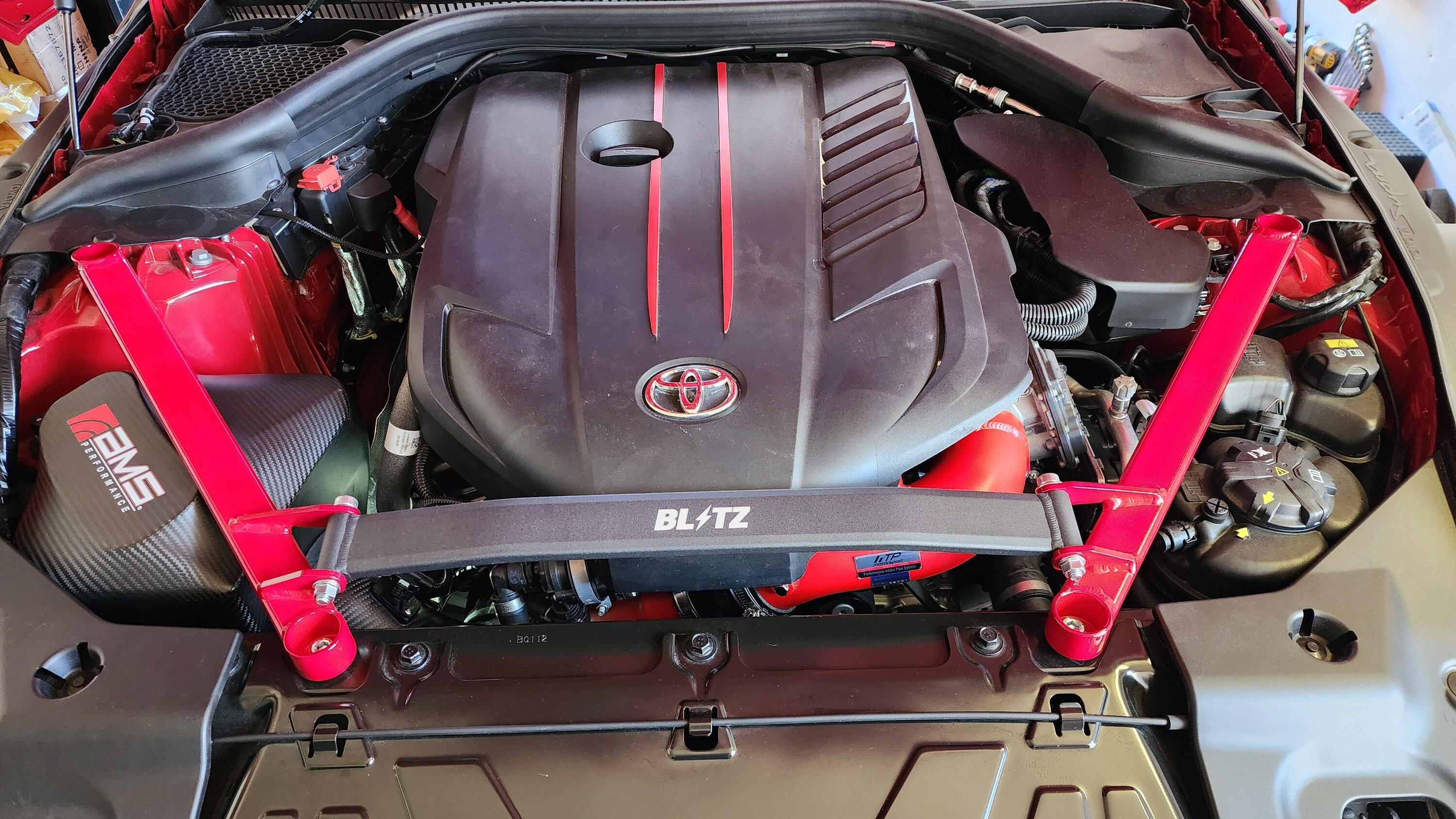

I personally have the AMS intake with the Verus heat shield and FTP charge pipe
The sound is quite louder than stock, but the air box is sealed and used the factory snorkel
A bit pricey and I initially wanted the Dinan kit, but after seeing it had cutouts exposing it to the same area air as the turbo I sadly had to pass
Without getting too crazy into it, there are three types of heat transfer; conductive when two objects touch, convective which is transfer to the fluid around the object, and radiative which is the light, or "shine" from a hot object. Heat shields are meant to reduce radiative heat transfer. They have no effect on convective cooling. A turbo blanket or heat wrap is a different story.
