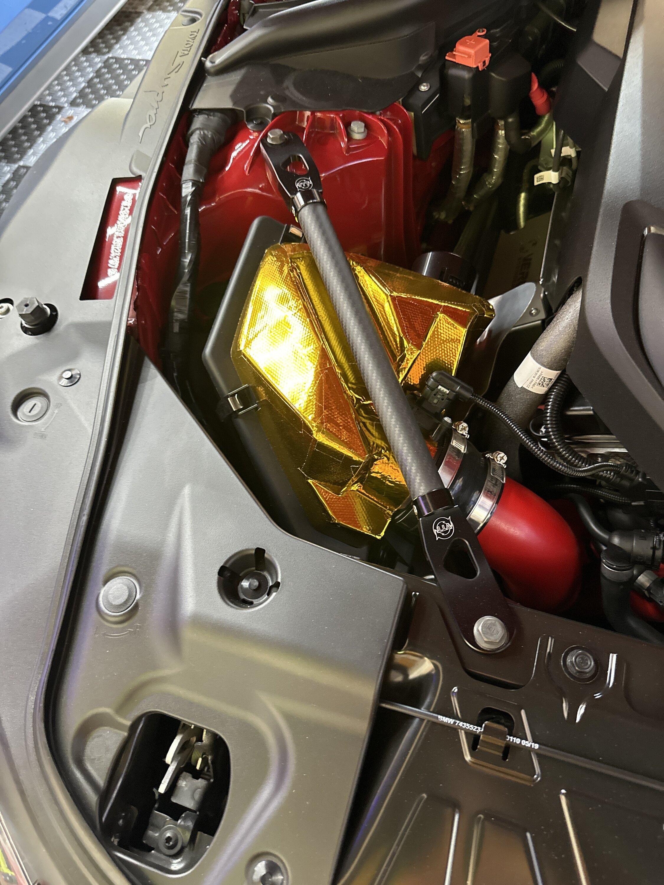

I couldn’t see any aftermarket air box being as efficient as OEM. Before the DEI wrap you couldn’t touch the air box after a drive. With the DEI, you can hold your hand on it. This stuff works great at blocking radiant heat.

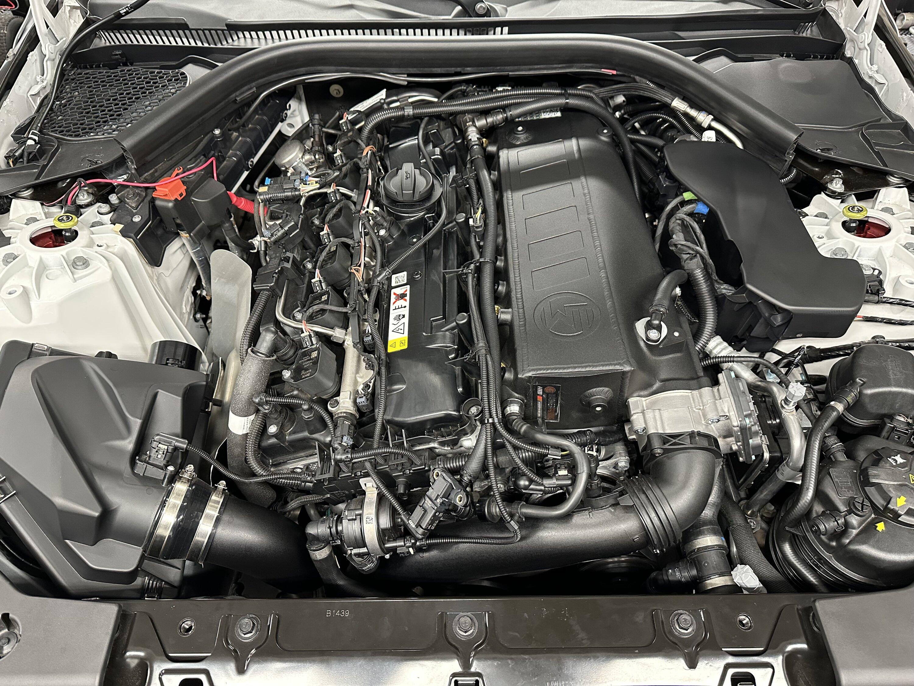

Working well for me, minus the added snorkel part. Maybe a winter upgrade?
What's the inlet tube to oem airbox setup? Did this gain a little noise while retaining factory box temps?
8,838
17,332

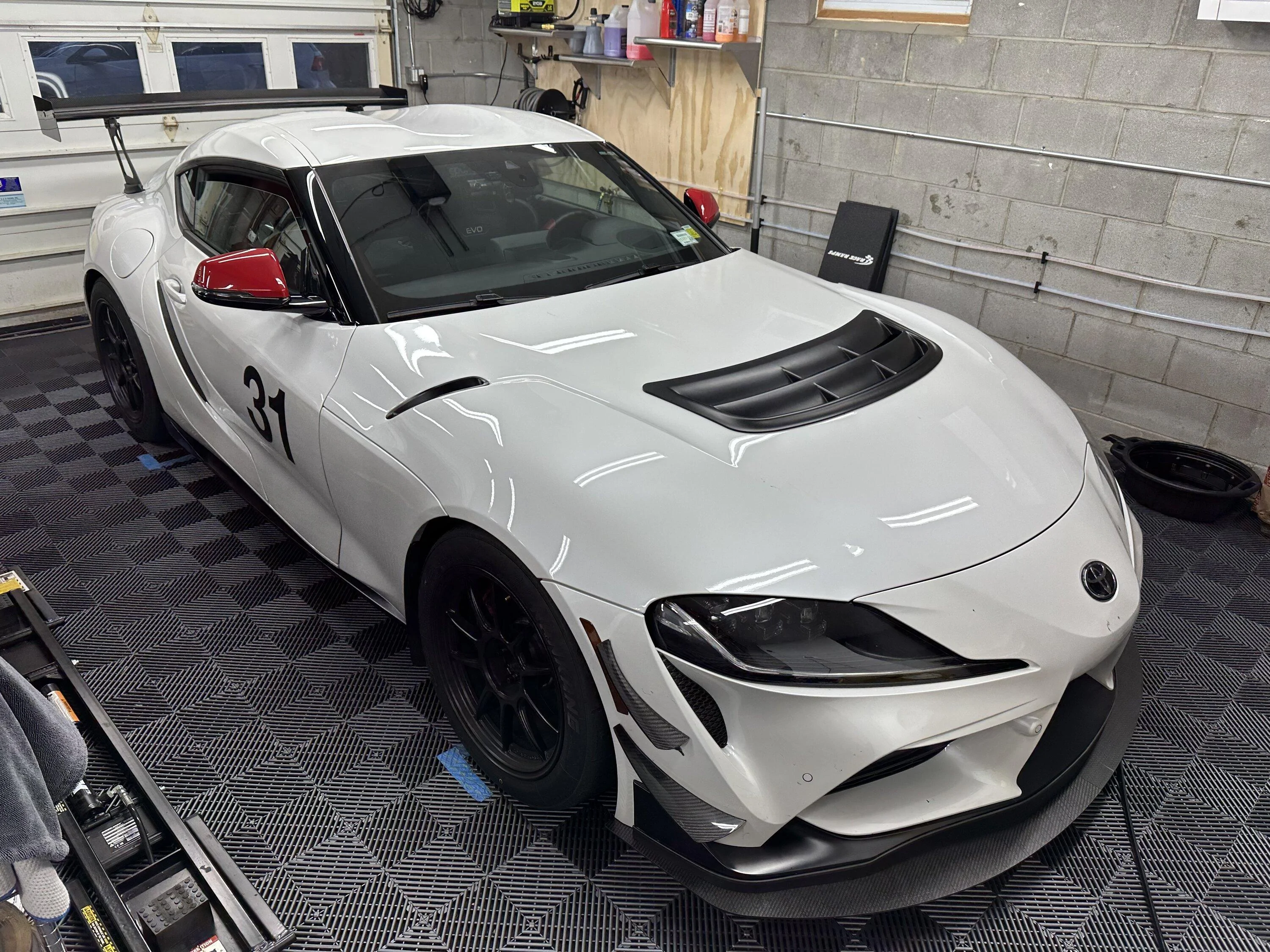

FTP inlet tube. Honestly, I barely could tell any difference sound wise with that inlet tube plus taking out the airbox resonator. Now with the hood vent, it's much louder.
That looks really good. Where did you get that specific DEI wrap from?
Awales74
Andrew
Apr 19, 2022
436
640
Dallas Texas
Supra, Mazda 6
I've done this before. It's a fun art project. Makes your engine bay look like the Lunar Lander if nothing else. A lot cheaper bling than those aluminum cap covers.
Did you happen to get any numbers on it though? I could get no conclusive results.
