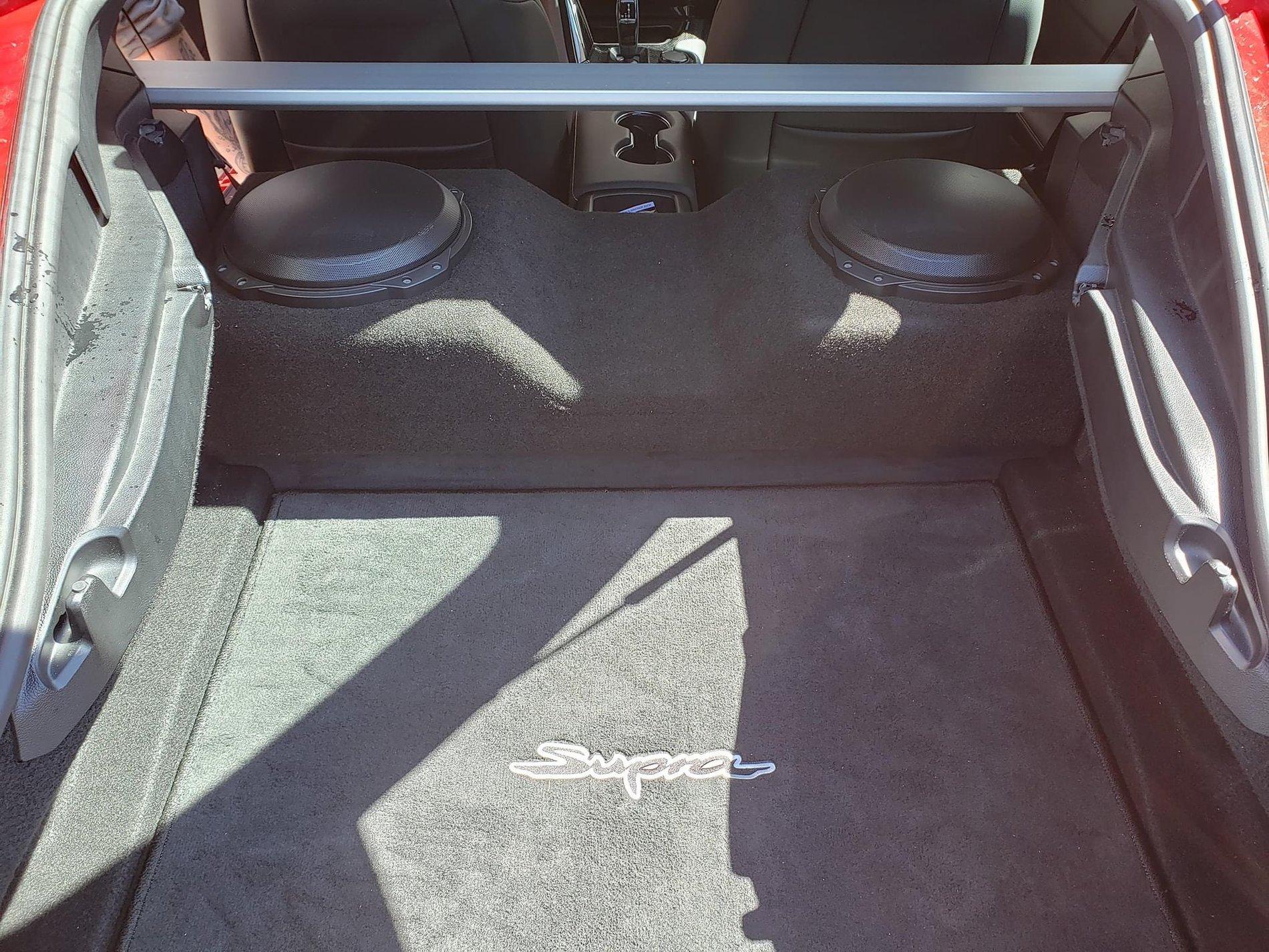

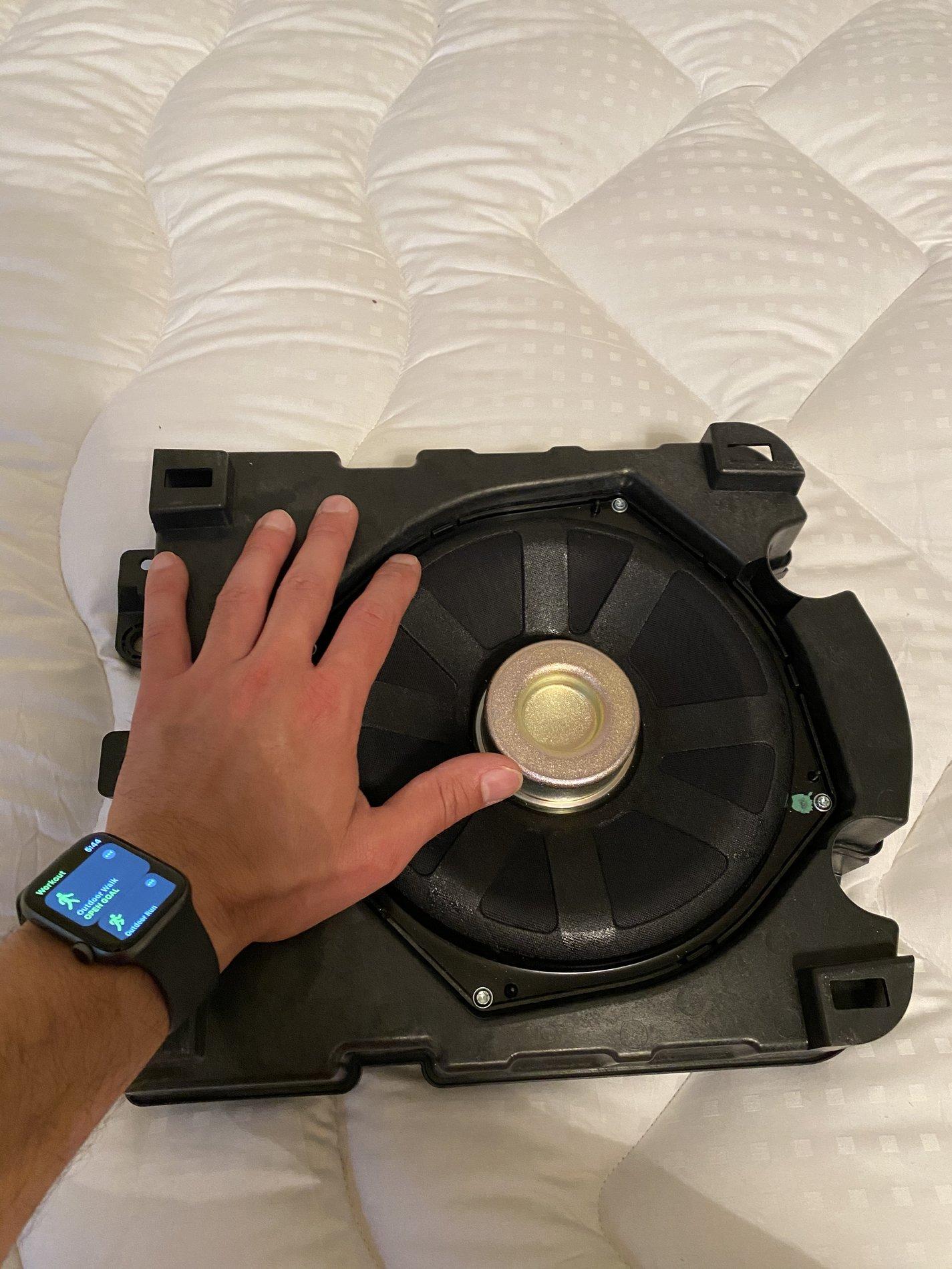

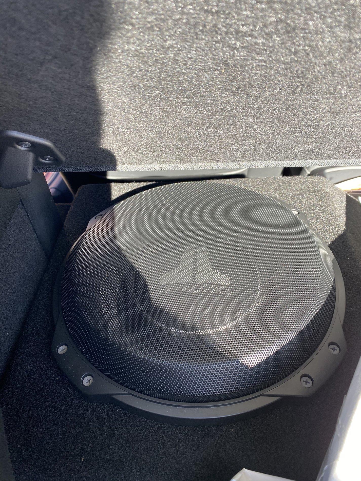

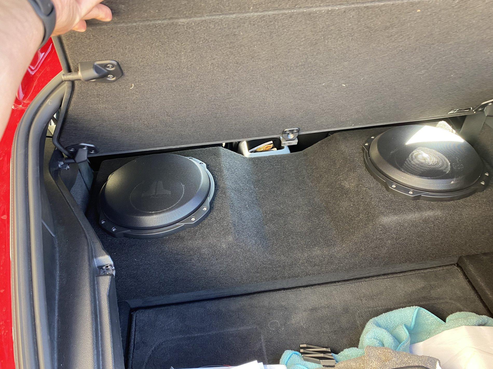

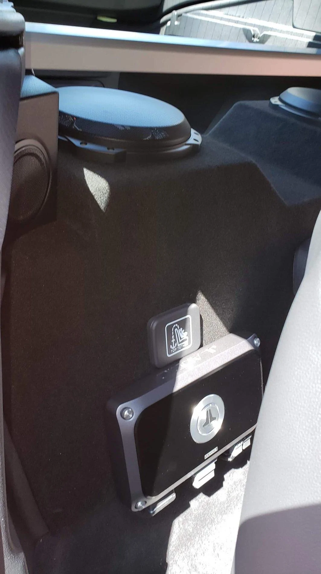

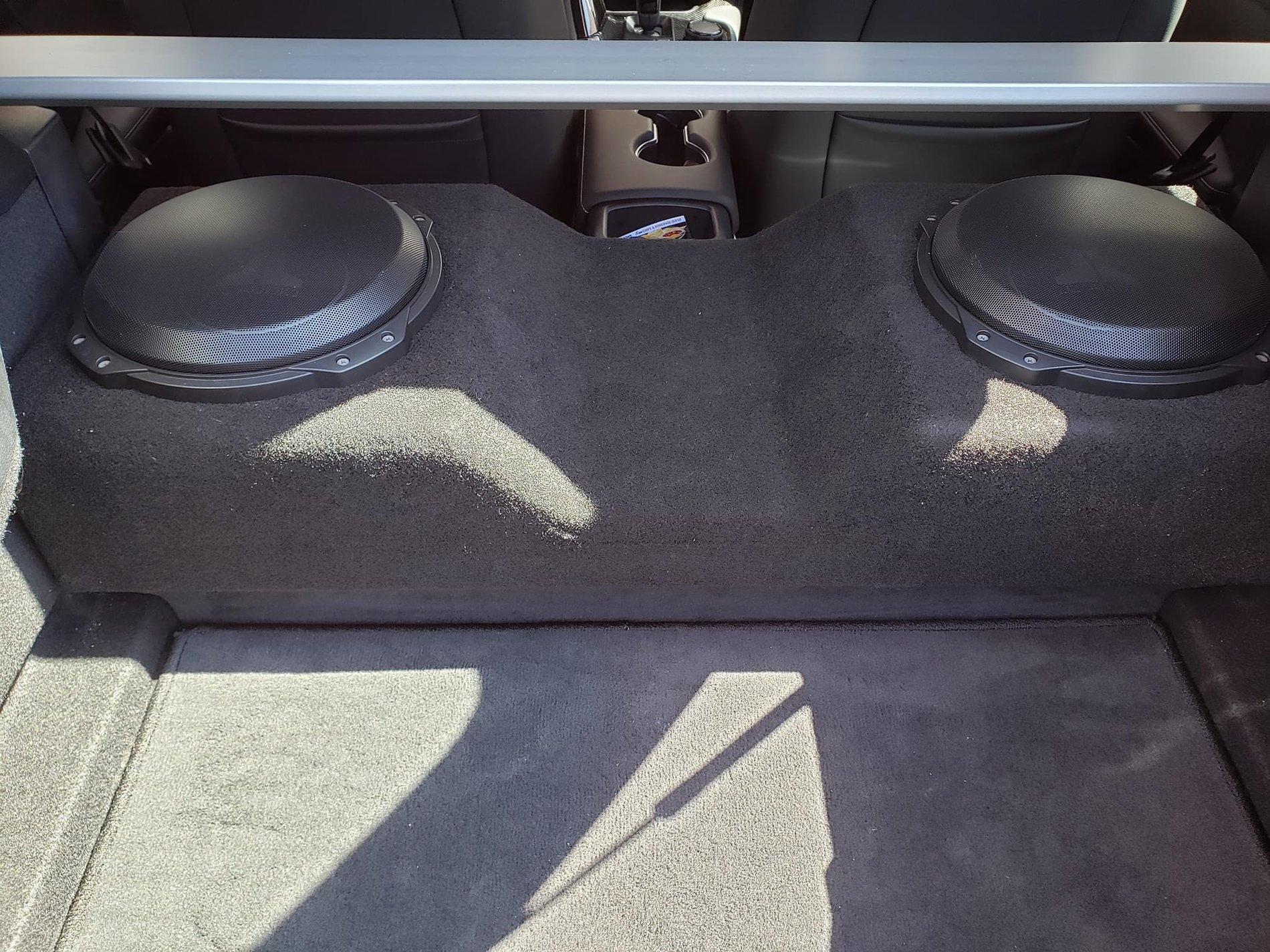

Yes! This is a complete subwoofer build to house the two JL10TW3 which are awesome! They removed the stock subwoofer enclosure “it’s crap anyway” The new enclosure work so well with the JL speakers they installed oh and a JL 1000vx i5 amplifier. I asked them to sound deadening the whole interior as well it’s a very setup for a nice ride now. No rattle and noise like it was before. Btw I do notice a slight weight difference when I’m driving the car.

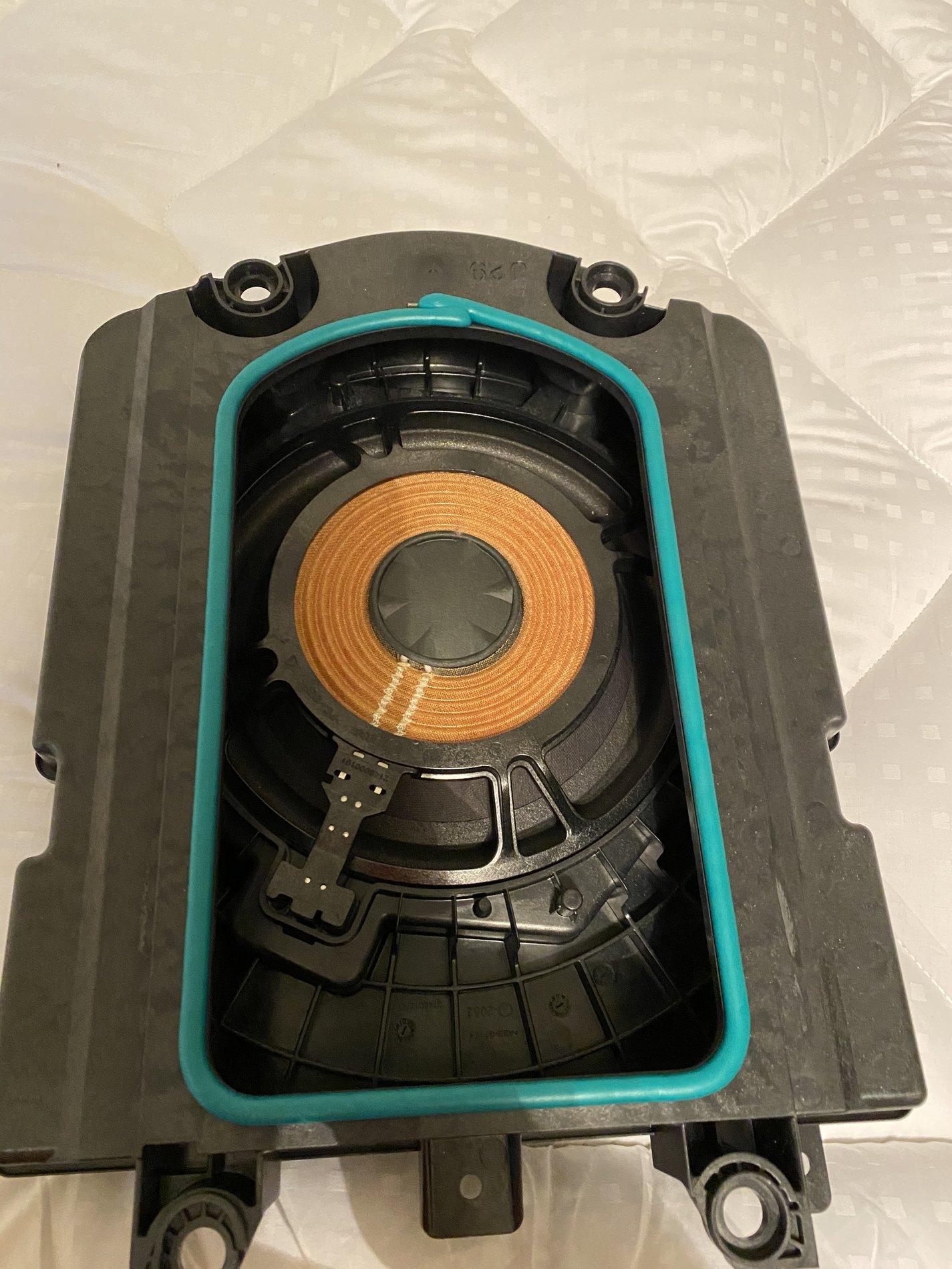

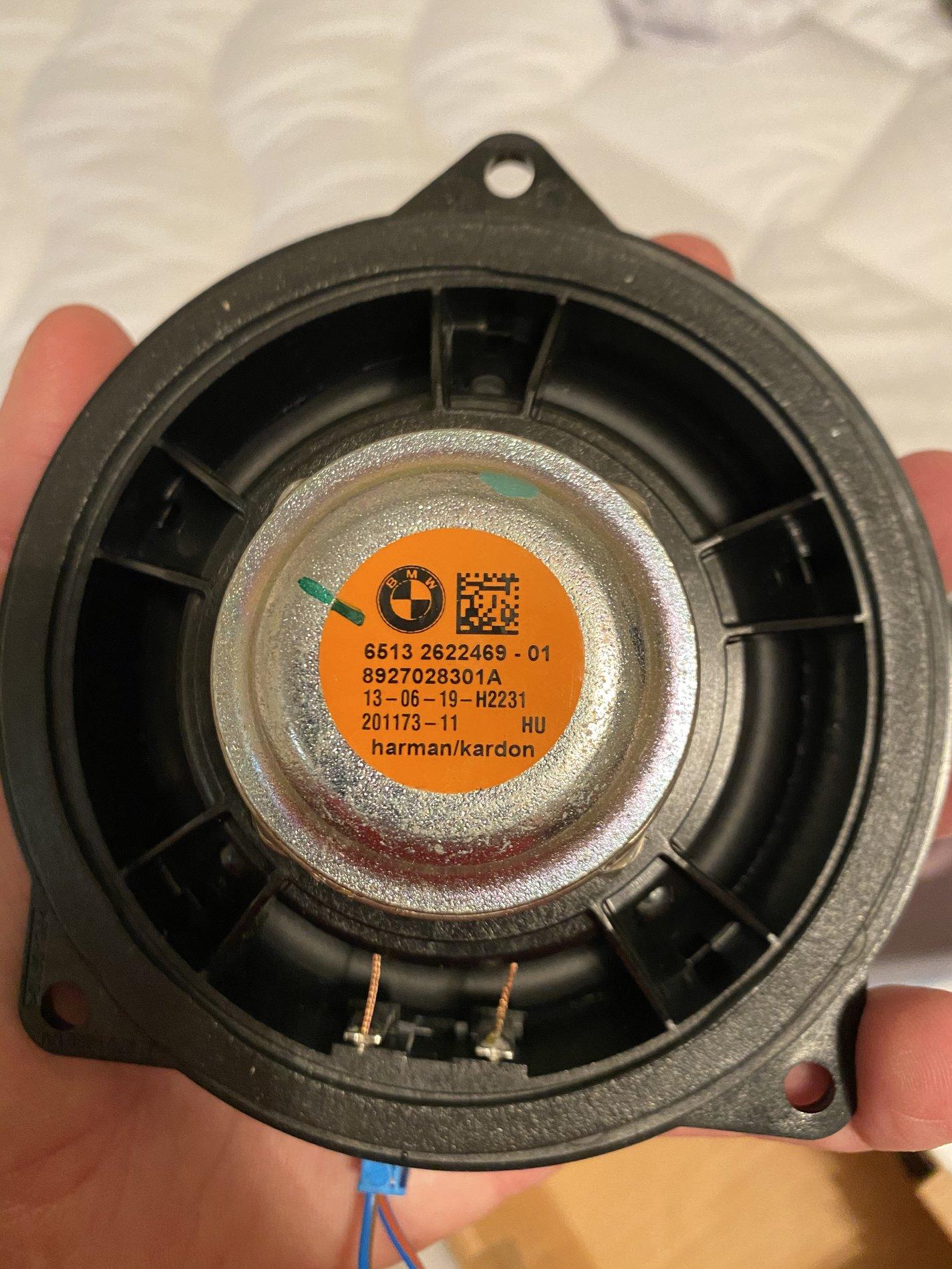

JBL audio Premium audio sham! It doesn’t say any JBL on the speakers that I took out of the car most of them are nameless or saying Harman Kardon! Just look at how flimsy they look. I know that’s how they cut cost but its not cool.

I’m sorry but I actually saw the very low cost speakers there no way around it. You have to replace them and install a good amplifier for a decent sound. Otherwise it’s just low tier sound system in an expensive car. Makes no sense.

They went sham on the sound insulation in the car that’s why it rattles like a ducking bite. After sound deadening the entire interior during the sound system build. It really did cut down the rattles and noise a lot! So if you can just sound deadening your Supra it would make a hell of a difference.
