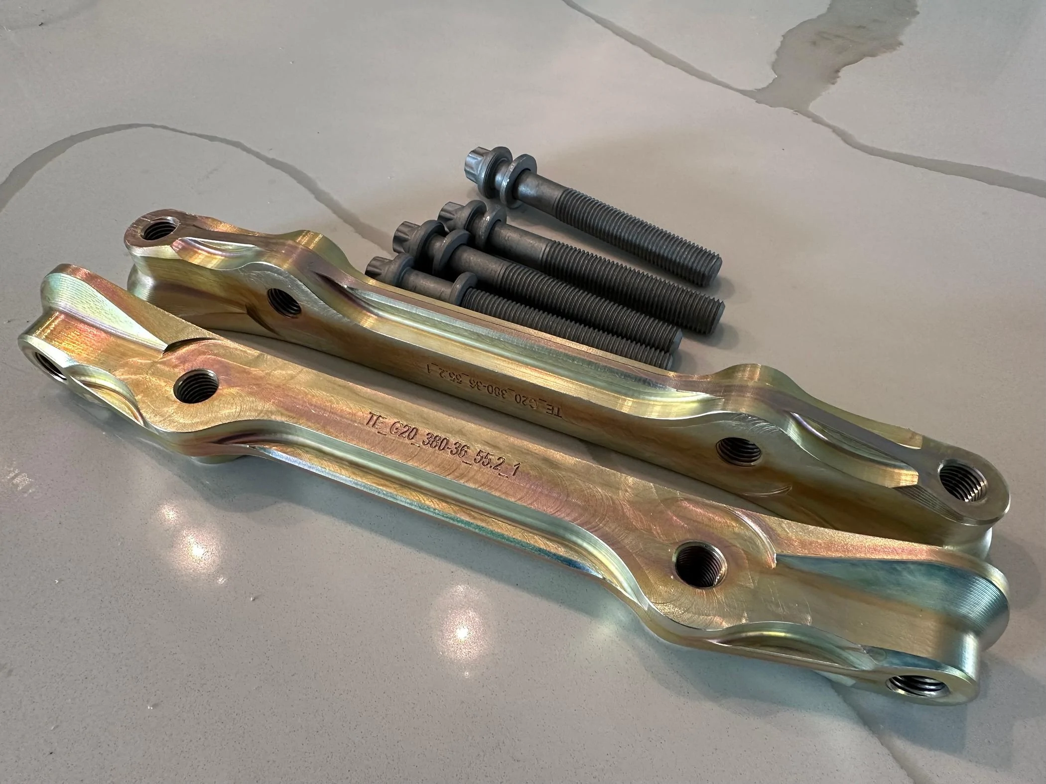

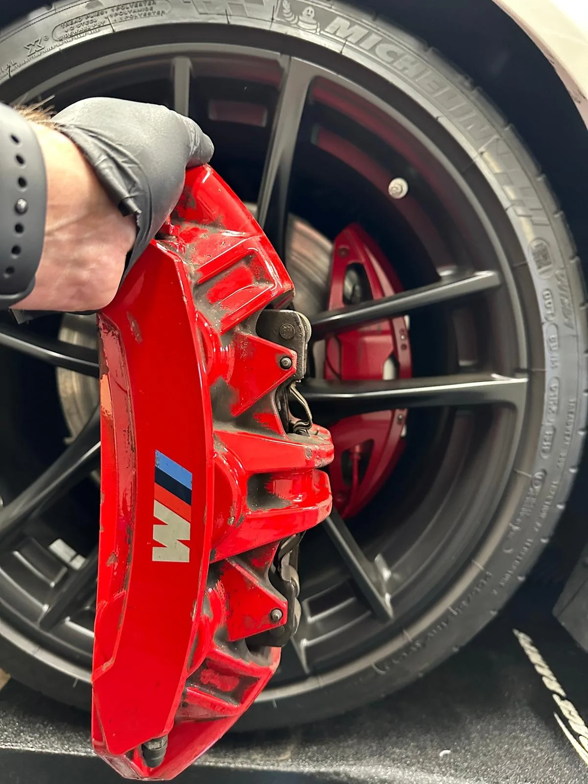

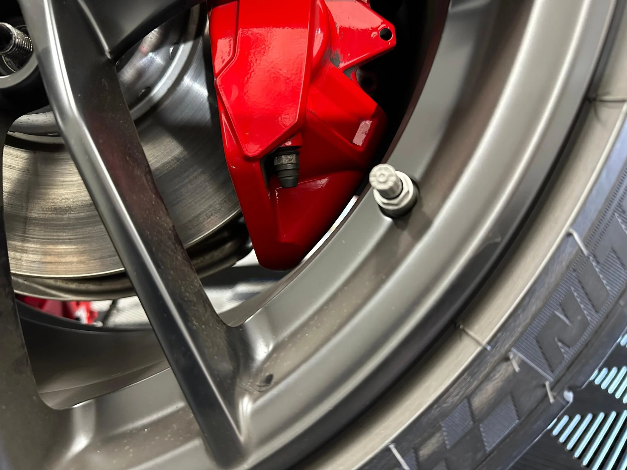

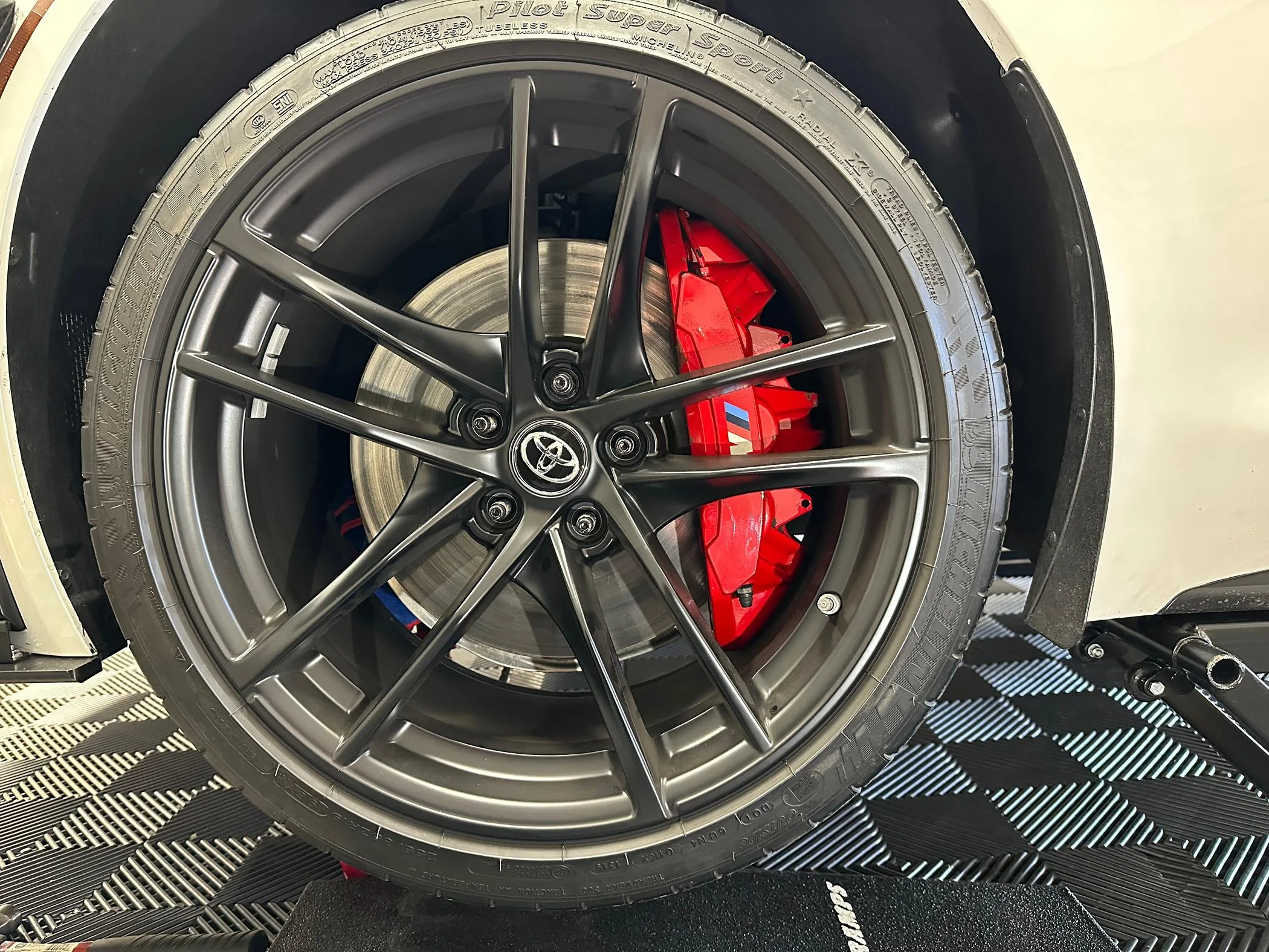

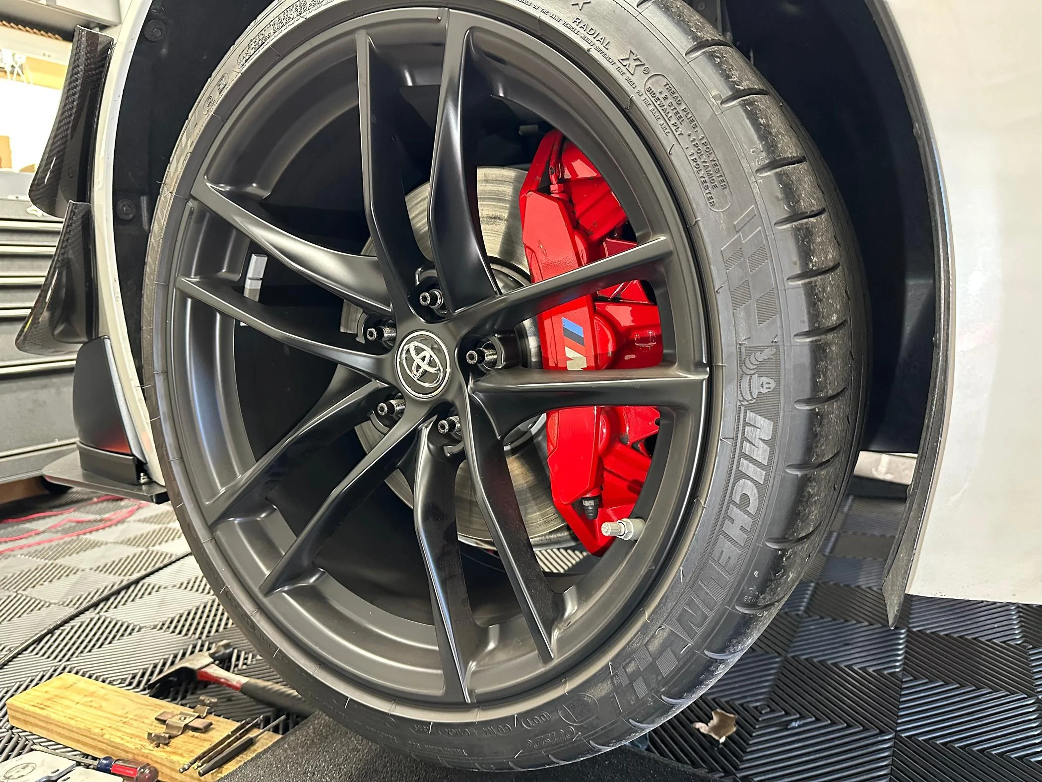

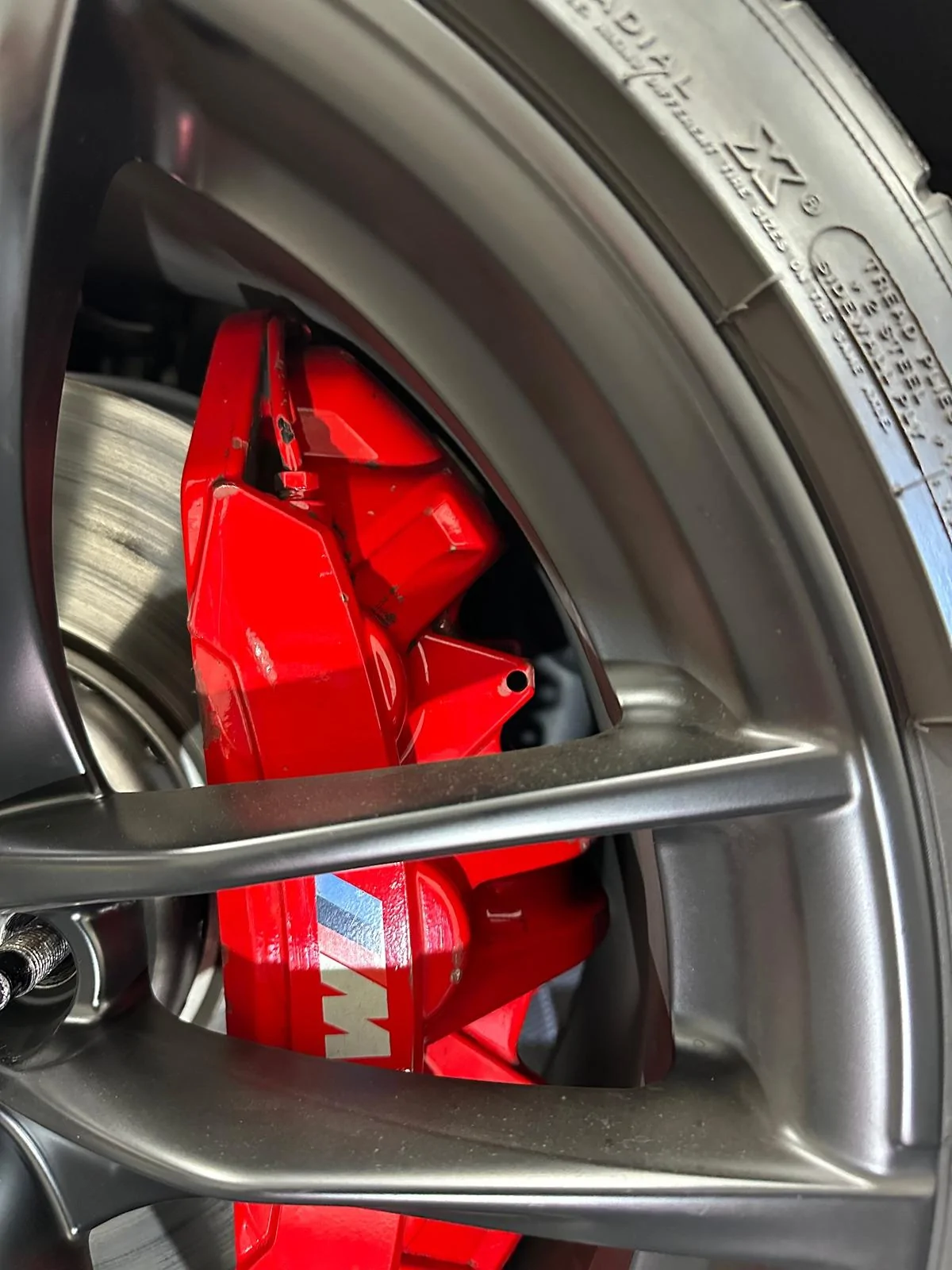

After testing fitment, The GX M2/3/4/5 M caliper upgrade is kinda dead in the water for me but figured I would share my findings for others.
Apparently, the new caliper bracket adapters that Tronik sells for the 380mm rotors plus our Supra hubs must push the caliper out from center more because 19" wheels BARELY fit over these calipers. Which is odd because 18" wheels fit fine on M2/3/4 and are even an option from the factory. You will see from my photos, an 18" would never come close to fitting with these adapters, and are personally even too close to 19's for me. This is dead in the water for me because I want to run 18's for track use.
Keep in mind that the rotors shown in these photos are still the oem Supra size. I just test fit the caliper as that is the furthest out point of the setup.
If anyone does want to use these calipers on their Supra, I am sharing my spreadsheet I created with all the part numbers:

Thanks for sharing this and doing your research!

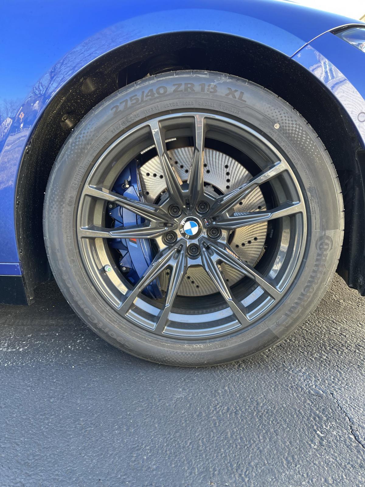

Hmm very interesting. Pictures of it on a 19'' already look tight on the m3, but the 18'' wheels look like they're one loose wheel weight from catastrophe.
Style 824m for reference. Not a usual spec for the g80's. I'm curious though, if the caliper is pushed slightly further from center, that means the pad wouldn't be making full contact with the rotor. I wonder if the fitment has to do with the barrel design on the stock supra wheels?
