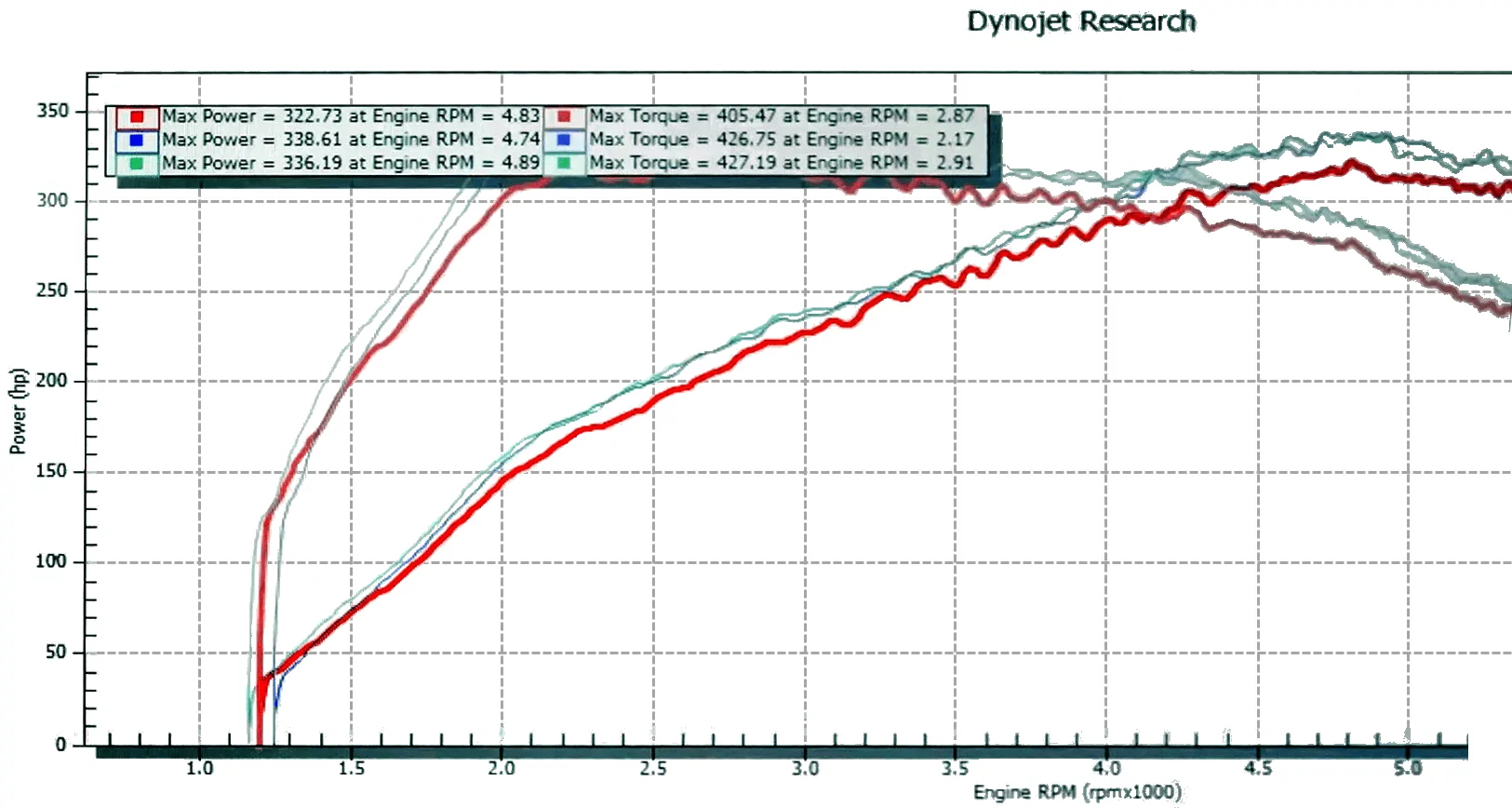

I'd imagine it to look a lot like this one (also lacking the particulate filter).
that's at the crank ;)
To show the whole picture; I googled them dyno results of some of the A90's competitor's, all stock (but be aware dyno's can vary a bit).
DynoJet (SAE) WHP / WTQ (lb.ft):
A90 Supra 339/427
Cayman GT4 345/315
Cayman 718S 320/310
911 GT3RS 400/295 (not in the same $$$ range though)
Corvette C7 400/390
Mustang GT350 470/390
Camaro SS 410/410
BMW M2 335/370
BMW M4 420/410
and..
BMW F3x 340i (B58) 300/310
the Supra has more Torque than the (NA V8) American muscle, yet the WHP is more akin to the Caymans.
hope ECU tuners can maintain the low rpm 's psi up to redline. As that would give +500WHP. (~420lbft x 6500rpm / 5252 = 520WHP). won't need more than this for a long time xD
p.s.: I recall somebody saying its a "370z" competitor with that 335HP motor...LOL!>>
370Z 280/235 ...a bit over half the A90's torque .pfffft...

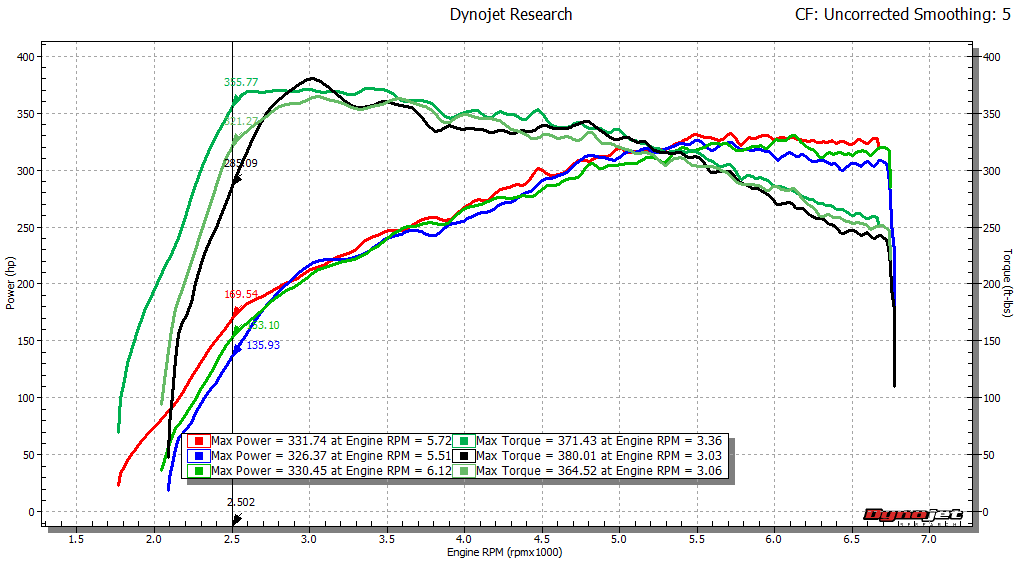

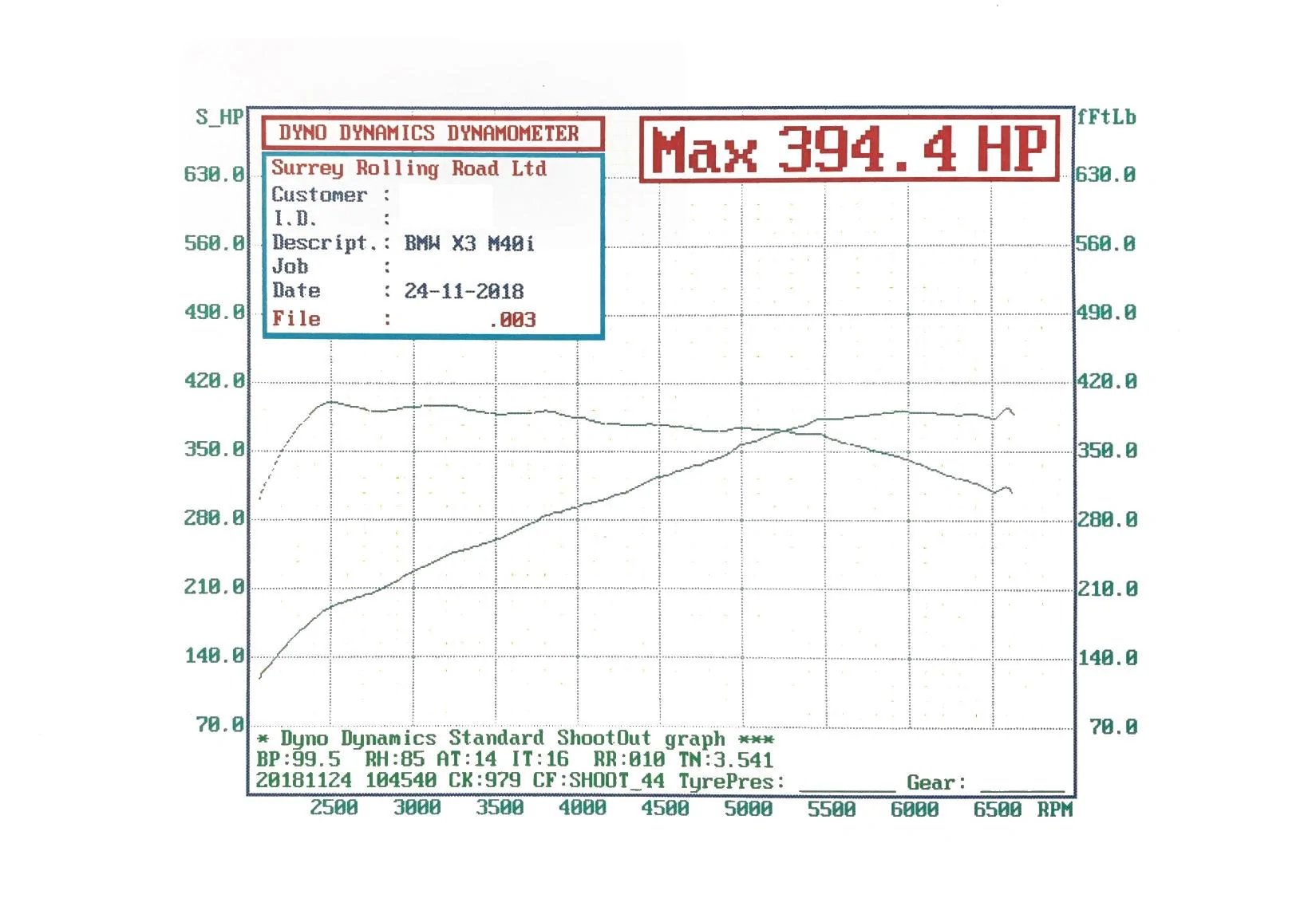

Nope, that is at the wheels. Did some googling on Dyno Dynamics dyno's and its measuring wheel torque, like all chassis dyno's do. Some dynos convert to crank torque with a bullshit flat multiplication and others try to measure the drive train loss, both are a waste of time. However, no dyno measures HP or power in any form, they only measure torque. Also apparently these dyno dynamics list numbers routinely 10 to 15% lower then a dyno jet (not unlike a mustang dyno). Forget that dyno, it's also of an x3 (so awd maybe?).
Here I found this...
"it’s a 440 8spd with the mppsk tune from bmw. No mods."
https://f30.bimmerpost.com/forums/showthread.php?t=1575160#post24263695
I would expect the initial z4 m40 to be about the same. I say initial because I think there is going to be some retaliation here...
Look at the numbers. 339whp is 1% off from the manufacturer's (BMW that is) advertised numbers, so with a 15% drivetrain loss and BMWs modern tradition of underating their turbo motors by about the same (which is a really good idea considering how widely their output can vary with temperature and fuel quality), the measured whp is inline. But come on guys, look at the torque, don't you see what's going on here? 427lbs/ft at the wheels? That's 15% over the manufacturer's claimed crank figures, and thus 15 percent over what BMW does!
We know the Supra was saddled with the low flowing head and looking at the graph above we can see that that motor flows a little better at 6000rpm. What has happened here, is Toyota. BMW may have saddled them with the lesser motor, but they also gave them the software to tune it themselves. 3 words, digital boost control.
This is mother fucking Toyota we are talking about here. Are you not aware of how Toyota operates and what they've done in the past? This is WRC level rule fudging shit here. They used to get stuck with restrictor valves in their race cars limiting top end and maximum hp, so they'd tune their engines to make as much torque as quickly and as low as possible. Torque made up high makes big HP numbers, but it's true, it's still torque that wins races, regardless where its made.
Also they pulled shit like this too...
https://www.google.com/amp/s/jalopn...acing-cheat-of-all-time-worked-1792828060/amp
So to summarize, Toyota took the engine the deal mandated, claimed the numbers BMW told them they could claim, then tuned the living shit out of it...

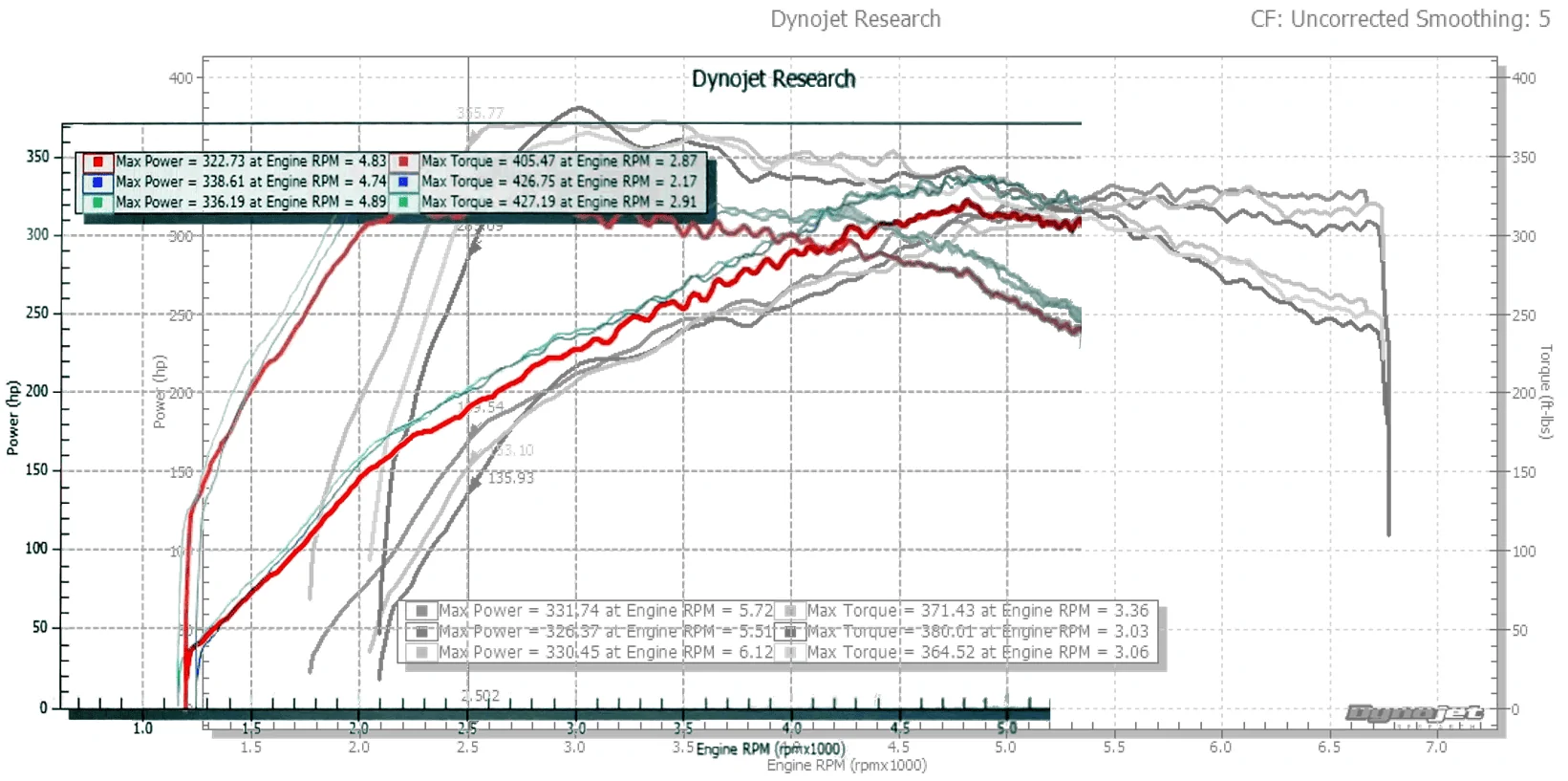

Cleaned up image:
Some overlay effort with SupraFiend's attachment. (his graph is marked with shades of gray in the below image), Supra kept the same colors as C&D.
