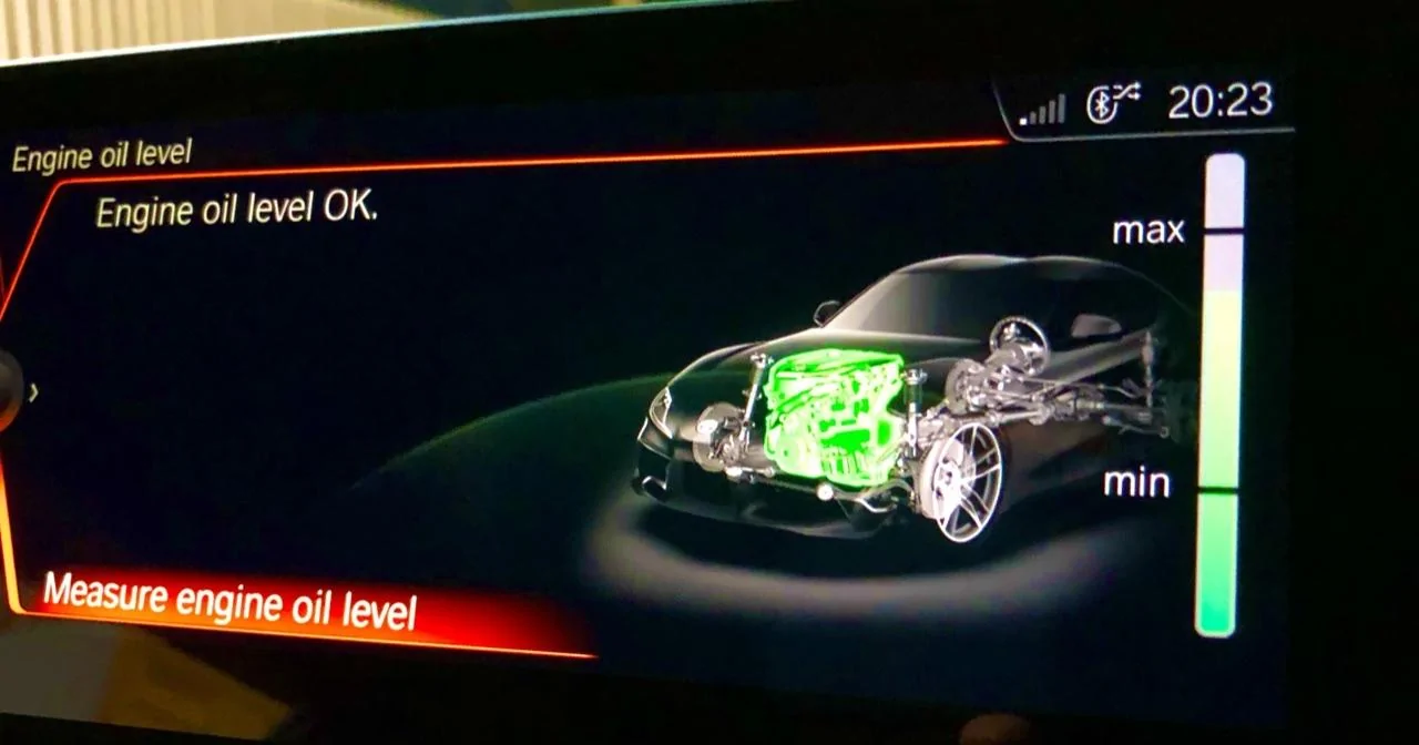

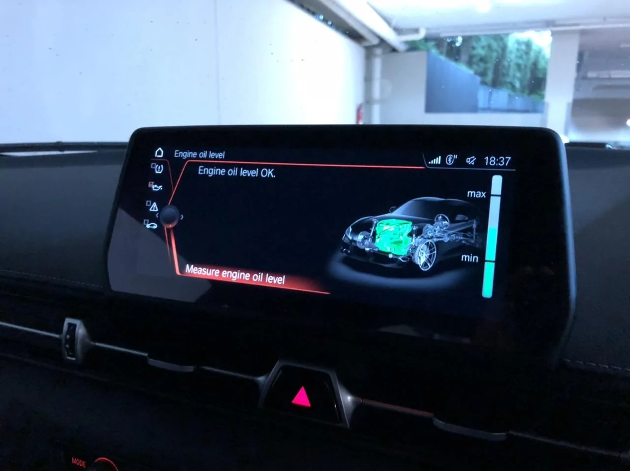

I have a 2020 3.0 Supra, and noticed some oil consumption:
  • First oil change at dealer done at 1000km. No oil top warnings, but I did not run the onboard oil measurement so I don’t know if there was any minor consumption
  • After ~1600mi on fresh OEM 0W-20 oil, I am down half a liter according to the onboard measurement.
I don’t know how much oil they filled at the first service, so I can’t say for sure if this demonstrates excessive consumption. I am also conscious I have run only 3600km out of the advised 10000km full engine break in mark. Also, the OEM oil is pretty thin, it’s a turbo engine, so some oil consumption is not surprising.
I followed the 2000km break in guidance but occasionally ran it up on RPMs within limits. Have used sport (and sport+) mode much more since. I always wait for the oil to warm up to temp before spirited driving, and the car is primarily on city driving.
im not too worried, the tail pipes look very clean, unlike my previous oil eating NA BMW (that one had well documented engine design flaws). But I will check with the dealer when I take it for the annual service in two months.
It still seems a little excessive at 1600 miles and 1/2 a quart down on a brand-new engine.

Update:
After adding 320km mileage, the onboard engine oil measurement is now showing only one notch (quarter) down from max. It somehow found 250ml of oil.
Guess that’s why BMW tells owners not to top up oil till it indicates to.
