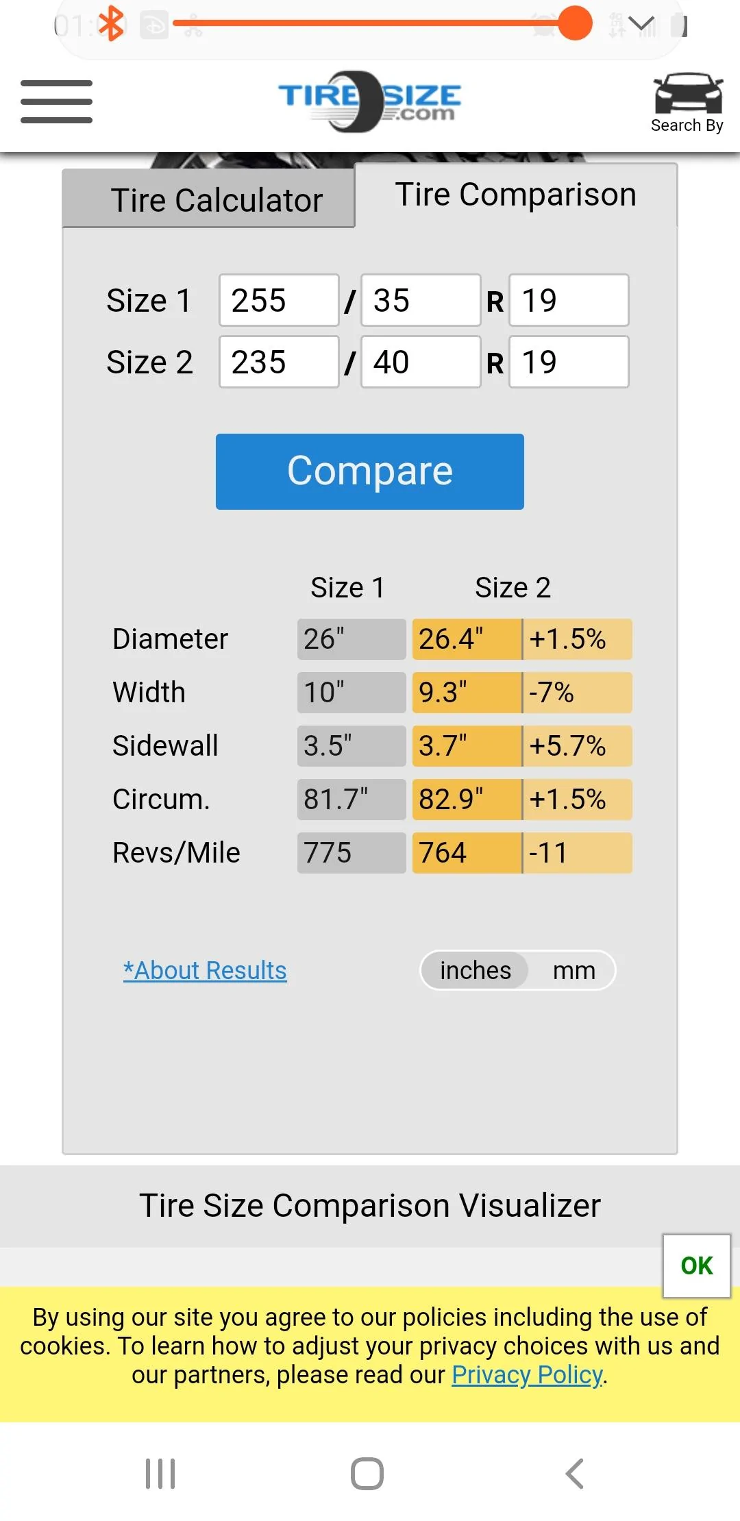

I just bought a set of the two tone OEM wheels for a winter set up. What wintertires + tire sizing do you recommend I go with? New to the tire/wheel life. Considering the Blizzaks.

@THOOPRA Blizzaks are great. For snow you want narrow tires. You want the tires to sink into the snow, not ride on top. So since you got a stock size set of wheels, I'd go 235/40/19 up front and 255/40/19 in the rear. Slightly taller sidewalls will help with the slight stretch and give you a little more ground clearance. On stock suspension you won't have any issues.
