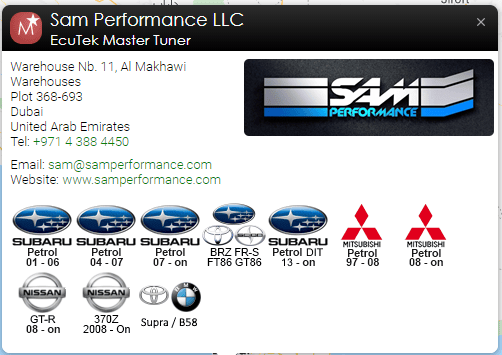

2k20HTownMKV
Joe
Nov 1, 2019
330
254
Houston
Quick check on ecutek website shows there is 1 tuner in UAE for Ecutek Supra.
