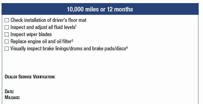

So I just took my car to Toyota to get it's oil changed and long story short they said because I'm bringing it in for an oil change before the normal 10k mile mark (It's currently at ~8500 miles) they HAVE to hook it up to the OBD and update/clear the maintenance codes and other stuff. As well as said it'd take about 5 hours to do. Not wanting to risk them re-locking the ECU as well as nothing sounding right in this situation I just left and figured I'd do more research or try a different dealership.
Aug 8, 2018
2,989
3,270
FYI its X months or Y miles, whichever comes first...
Haven't done my maint yet, so can't speak for how long it'd take dealers to read/clear/update codes...
Rhafiki
Mason
May 7, 2020
Virginia
Yeah I saw that as well but on my previous cars it never mattered if I went by what was recommended so I assumed the same would apply in this case. I was always under the impression that especially on newer cars you always wanted to get it changed sooner than recommended then after first change go on a normal schedule after that.
So I guess it will be okay to just follow the 10k/12 month change cycle?

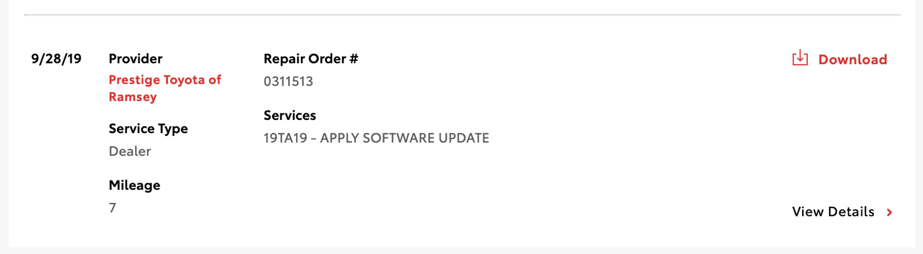

Does any one have any idea if the below would signify that my ecu is locked? I was looking through the service records that are online and found that the dealer who sold me the car applied some sort of "Software Update" about 2 weeks before I drove the car off the lot. Or maybe it's just to activate w/e they need to do after the car gets state side?
65sohc
Ken
Mar 8, 2020
459
270
Fresno, CA
How did you find those records?
Tsar
Oct 18, 2019
723
854
New Jersey
Go to Toyota.com > Owners > log in > My Vehicle > Service History. Service records should all be listed there. (I got my first service done on the 9th, it's already listed there).
