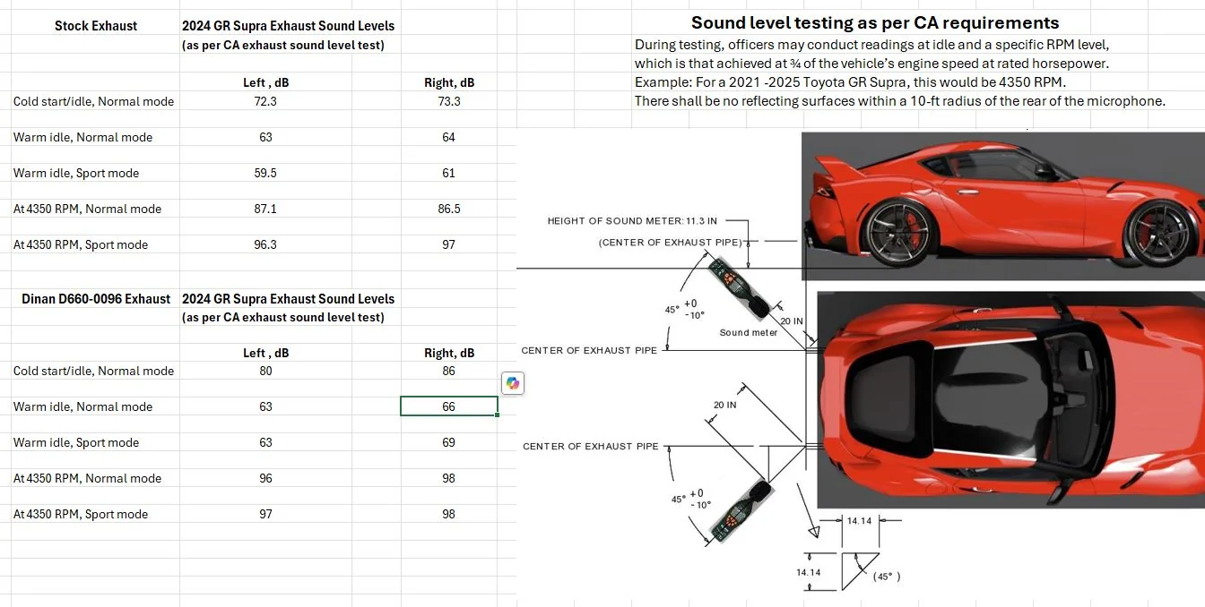

I agree with most of what you said. In sport mode there is essentially no muffler, but at higher rpm the actual sound level is close to stock. And I guess that since the Dinan muffler is freer-flowing, the sound level is higher in Normal mode. Startup is louder than stock. Attached is a sound level comparison.
My car has the stock downpipe and cat. The CA max at 4350 RPM is 95 dB.

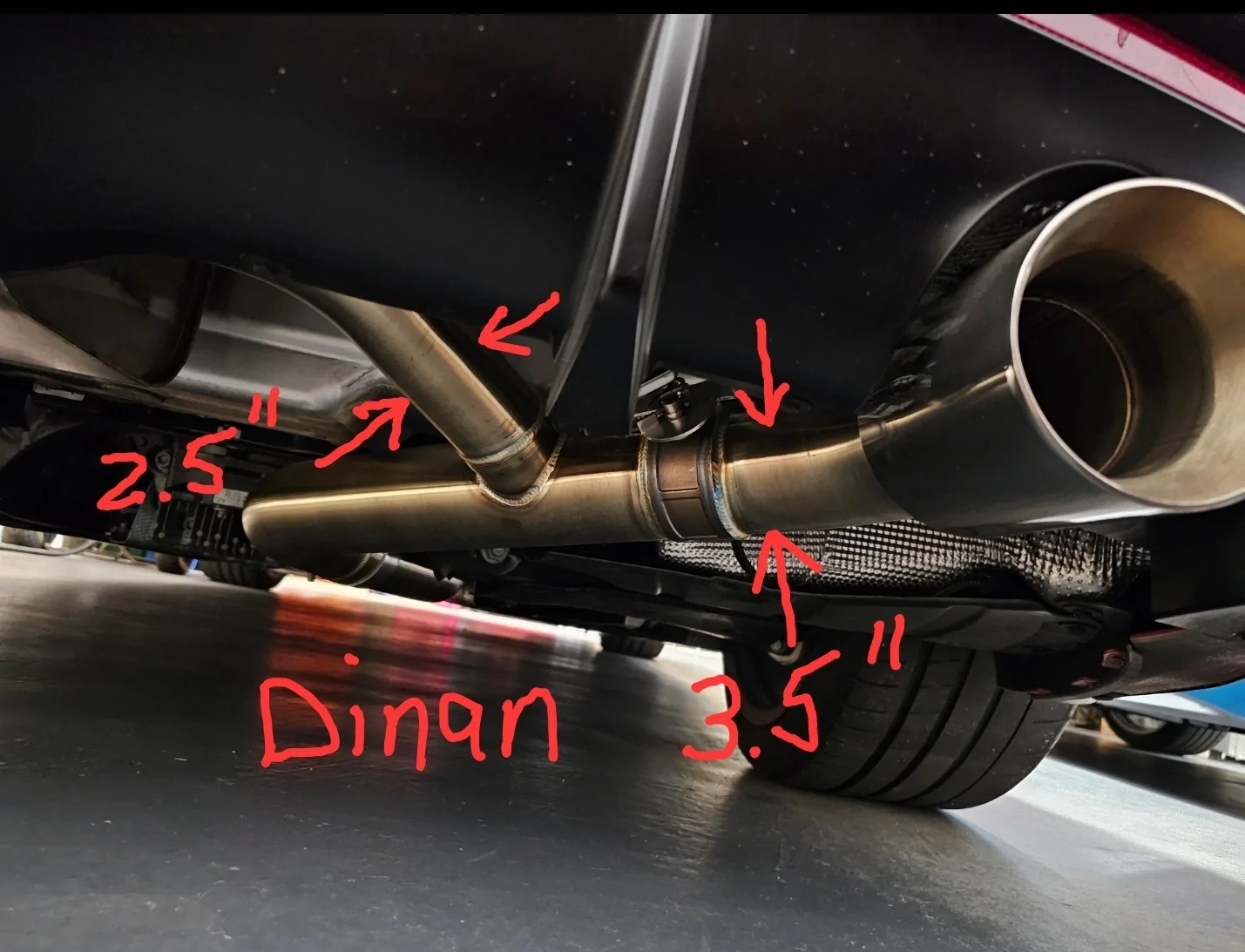

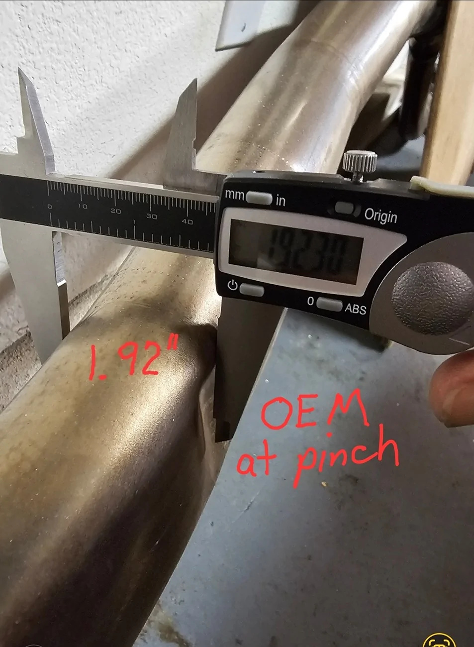

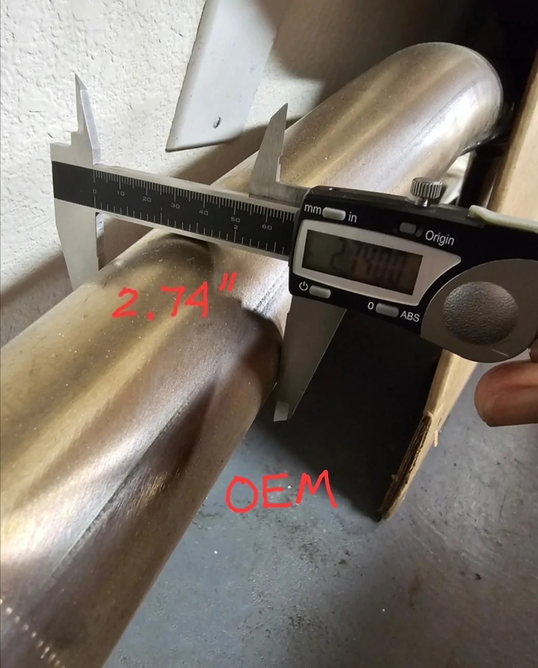

Some pipe measurements, stock (pinched area, then round) then Dinan
