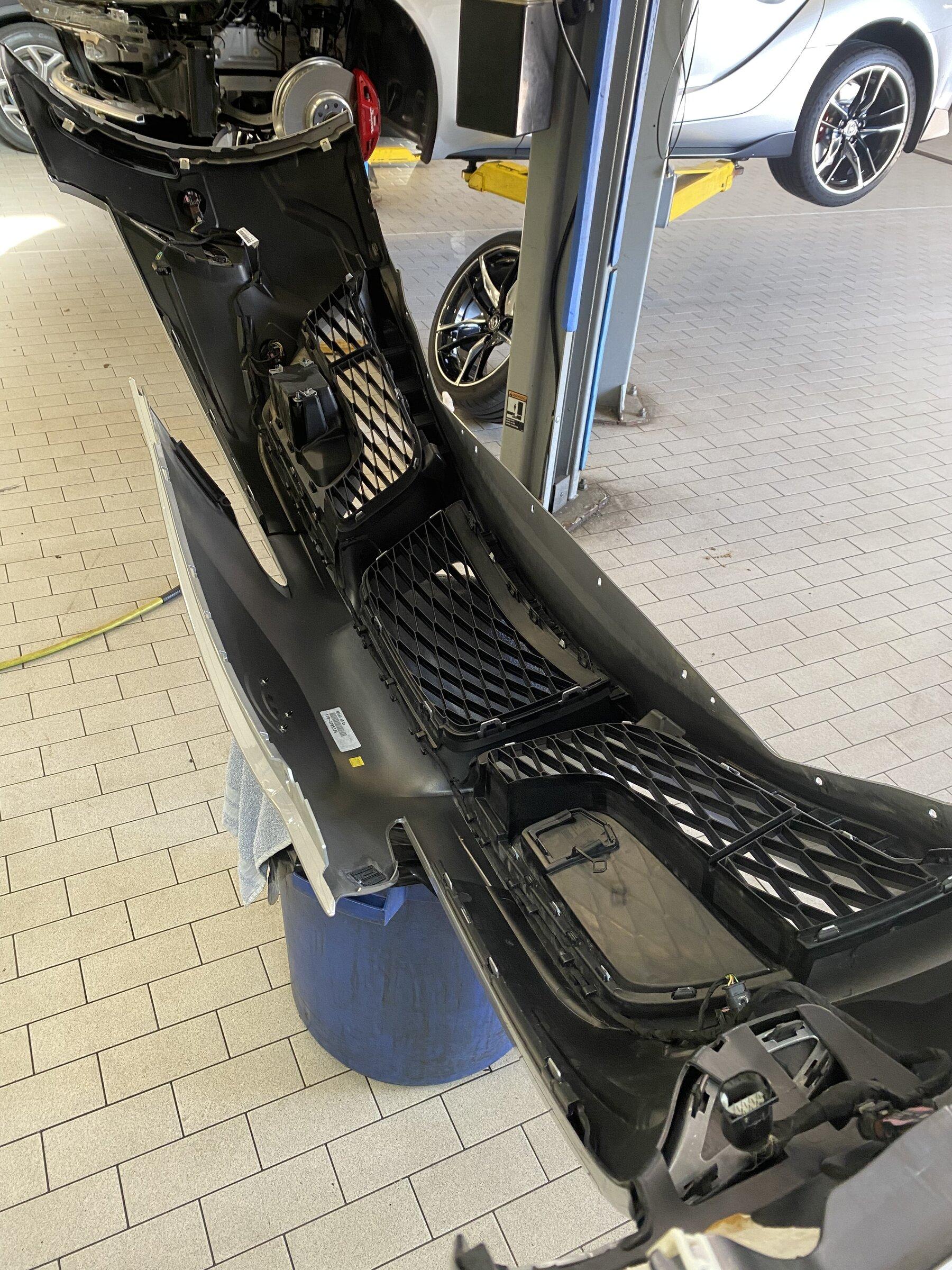

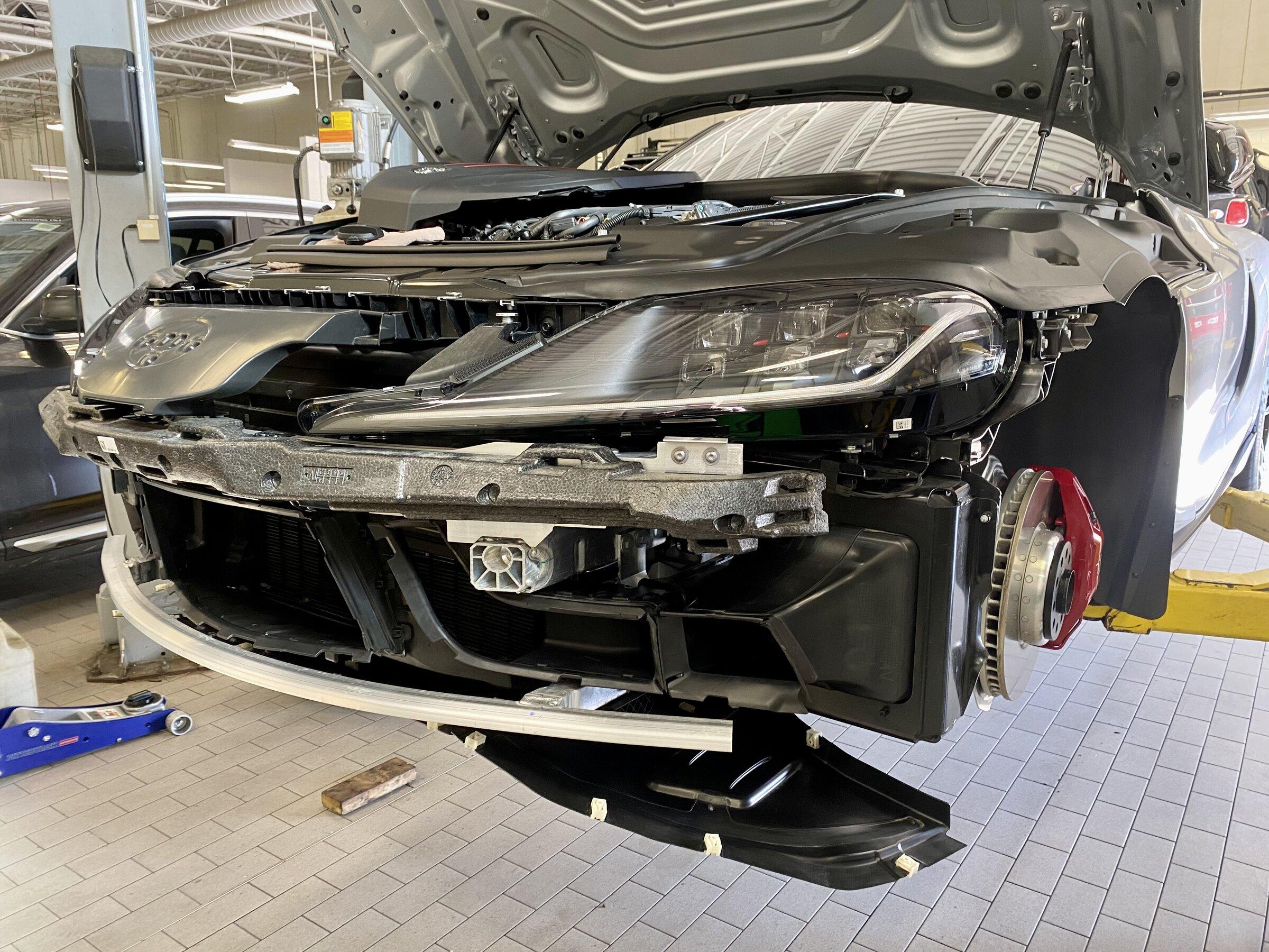

Finally my car has a real horn as of tonight!
I had my go to bmw mechanic order an oem low pitch bmw z4 horn. The front bumper did have to come off as others mentioned. Quite easy to do. If others want part numbers, let me know.
