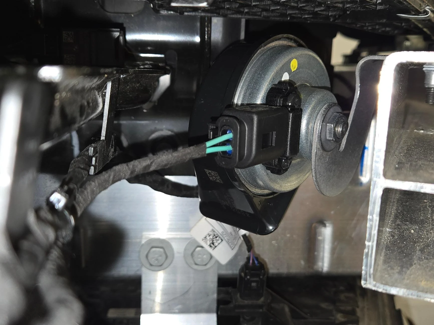

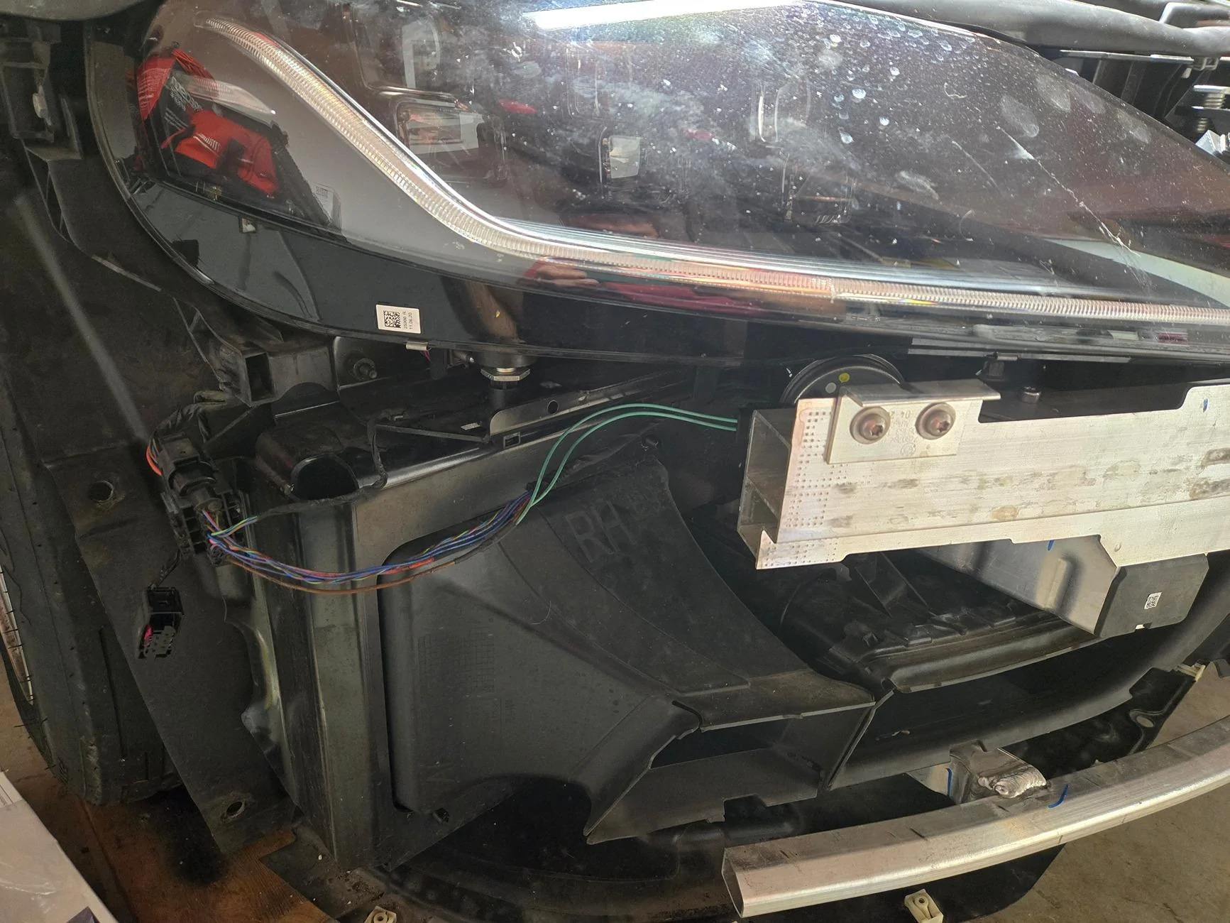

~ This was virtually a plug and play. The mounting hole is already in place near the existing horn.
If you order the bmw parts below… this makes things easy with the secondary horn plug harness and wires. You’ll have to splice into the original horn wiring with the new bmw wiring. Add shrink wrap to the 2 connection wires and you’re finished with the install. Quite easy as a diy. With the removal of the bumper, horn install and reinstall of the bumper… it took about 1.5 hours.
If you need more detailed pics please feel free to pm me.
Hi @Andrew4Supra, are you saying the mounting bracket is already there? All we need are the parts you listed and one washer + one bolt? Thanks!
