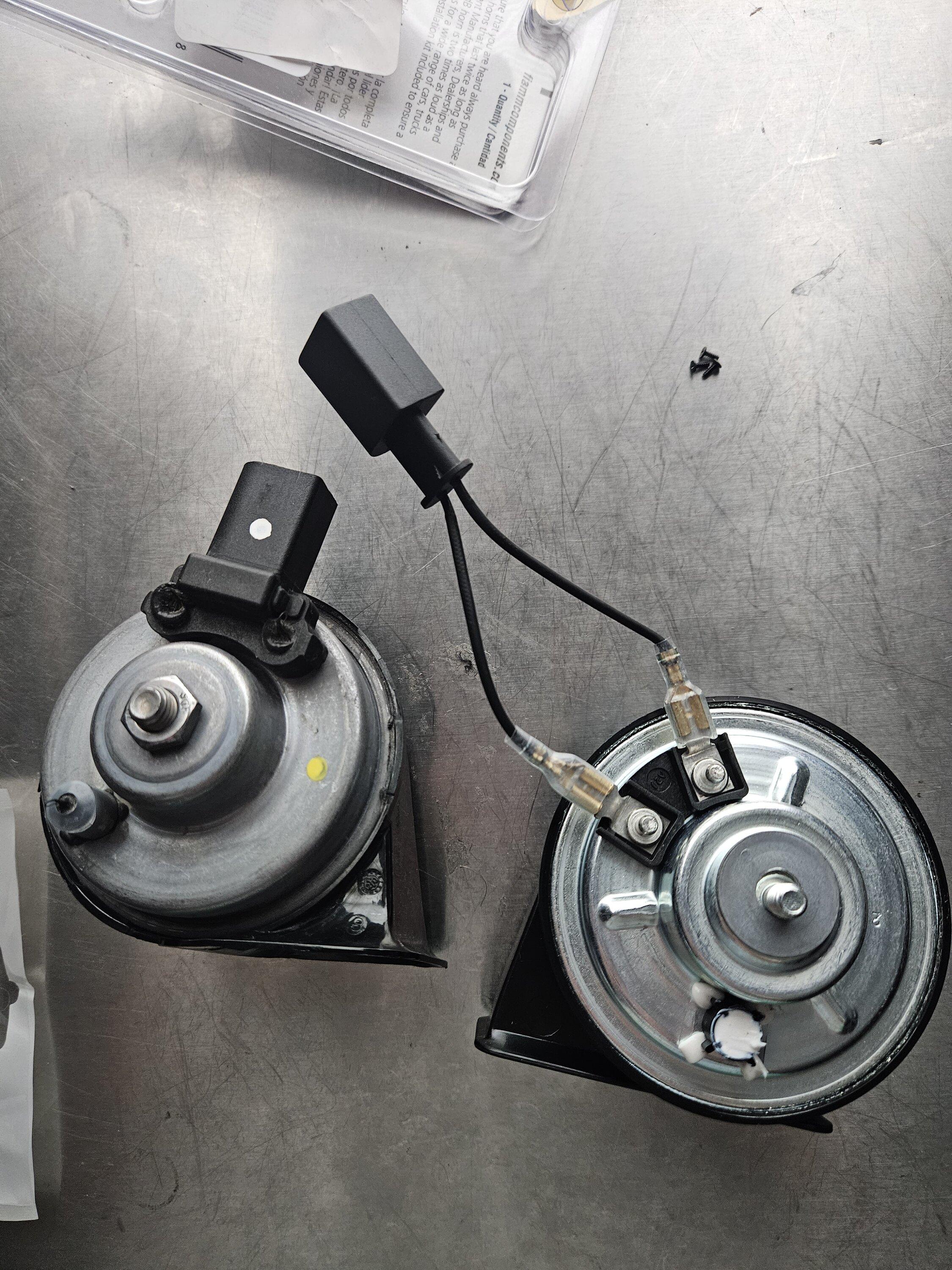

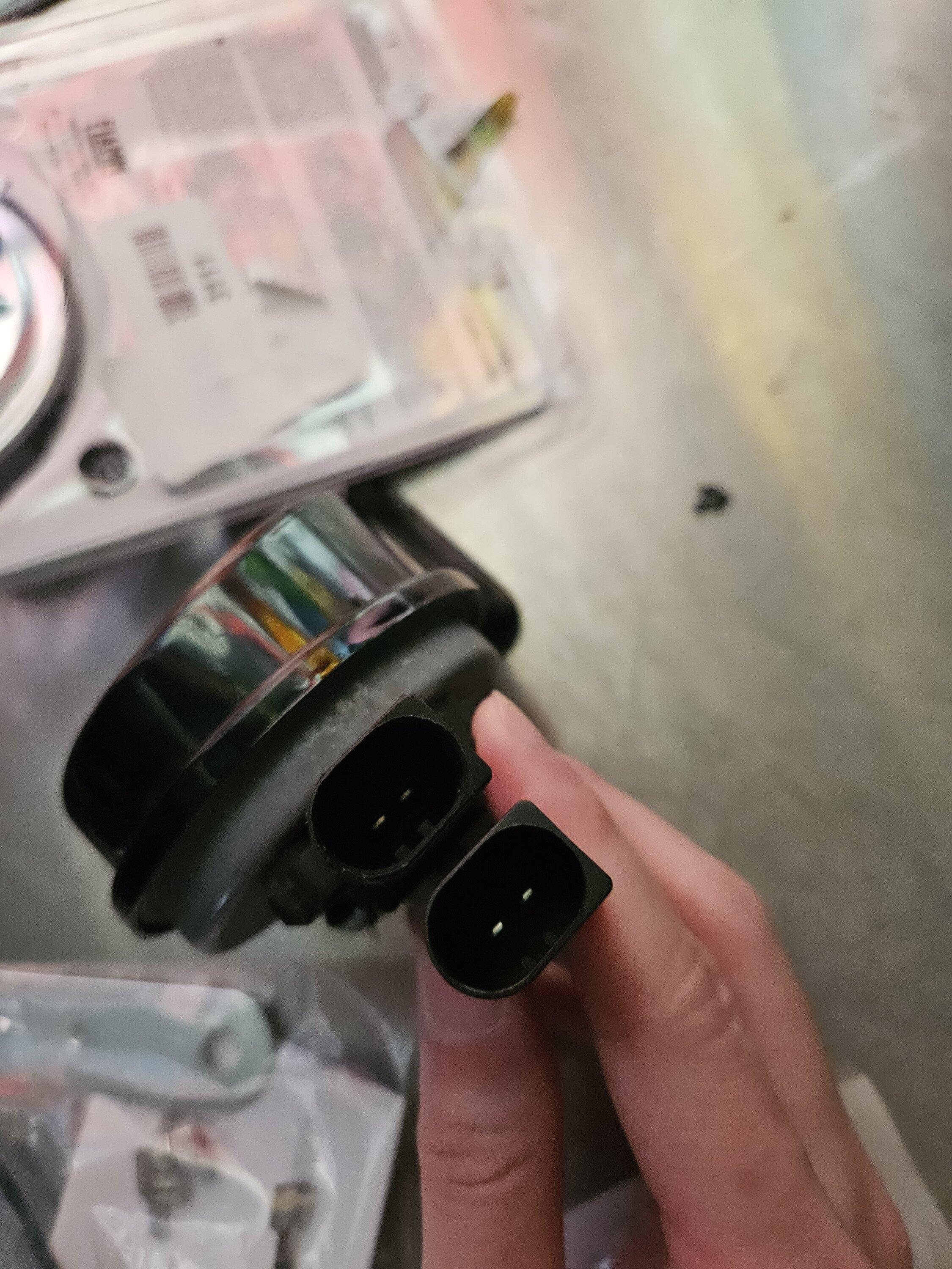

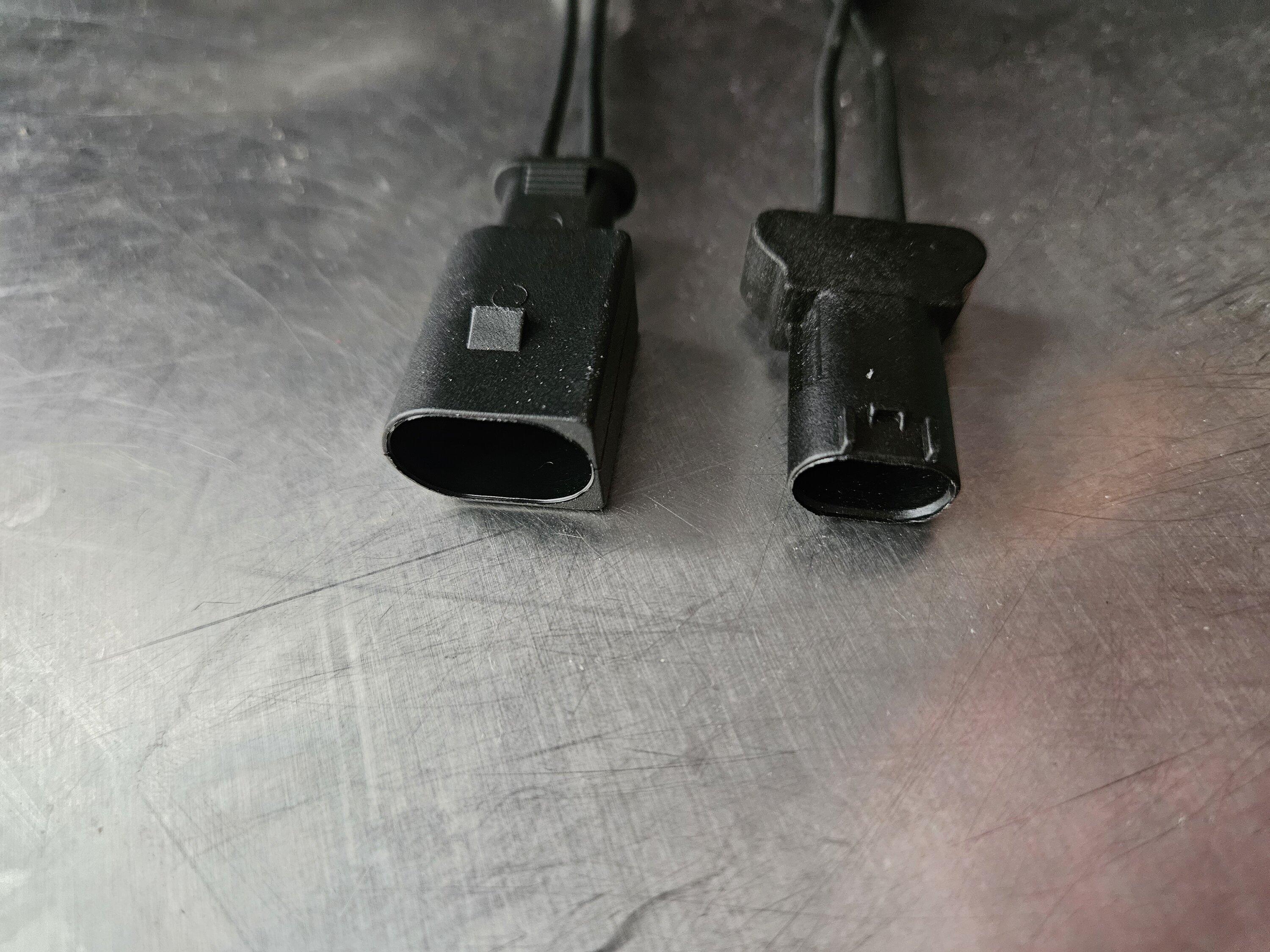

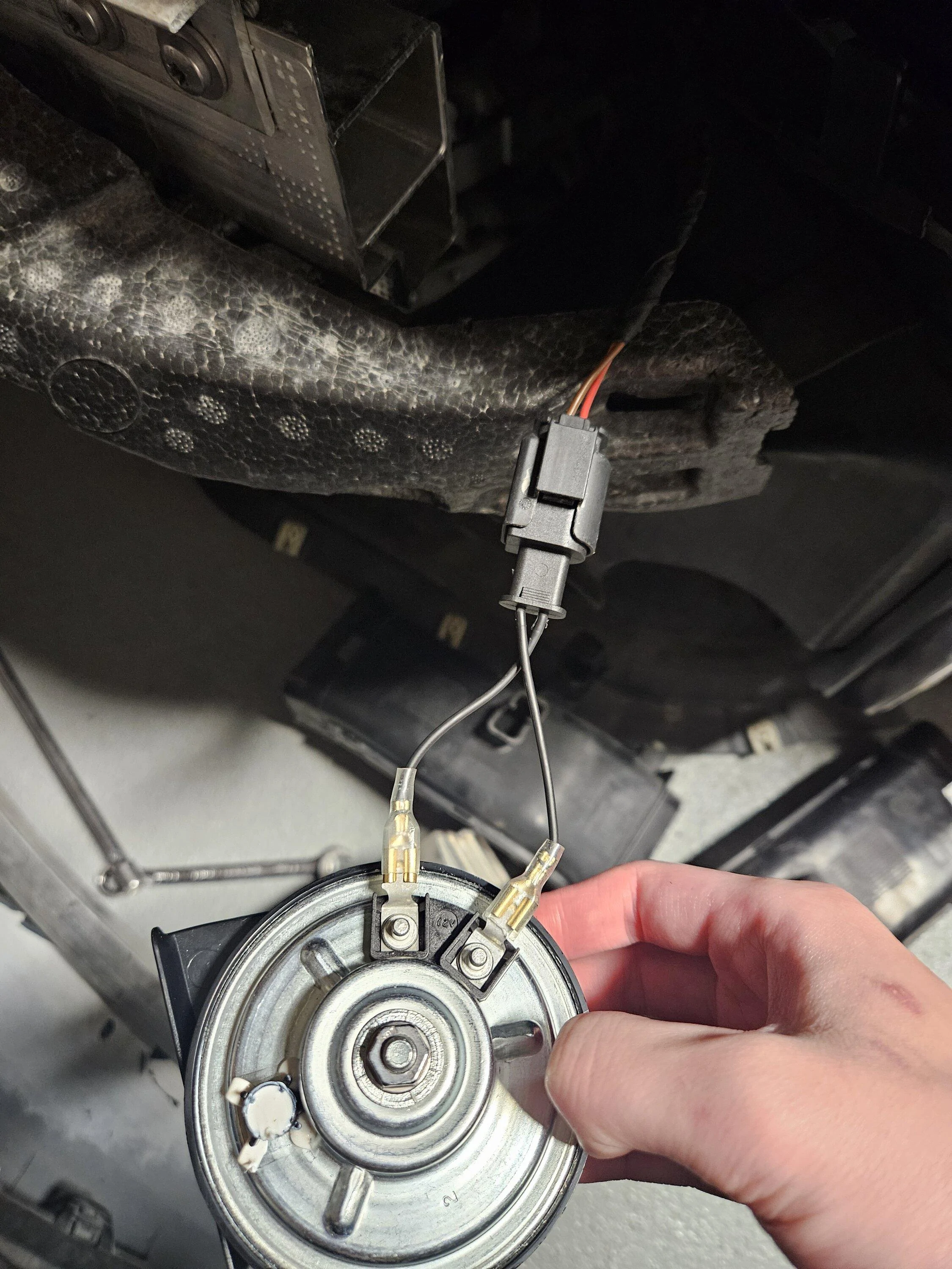

Splicing is no longer needed! ?
(If just swapping)
Found a Plug and Play connector......
Did some measurements and the VAG/VW/Audi/Porsche connector fits perfect!
Should plug into any universal horn.
https://www.amazon.com/dp/B08GZB1M47
The BMW connector in the link doesnt work, as it is older (E/F series?), too small.

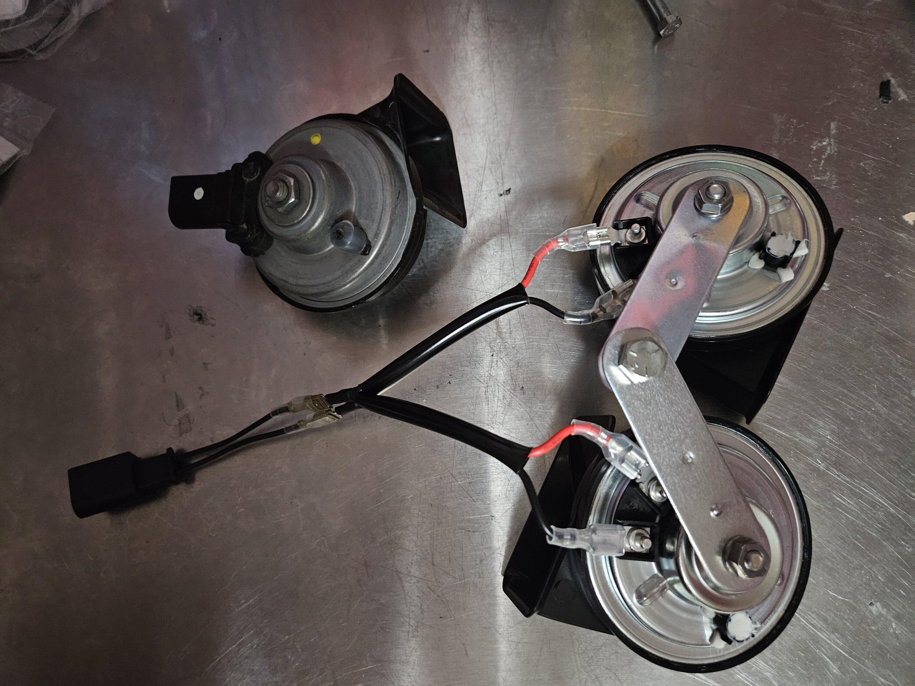

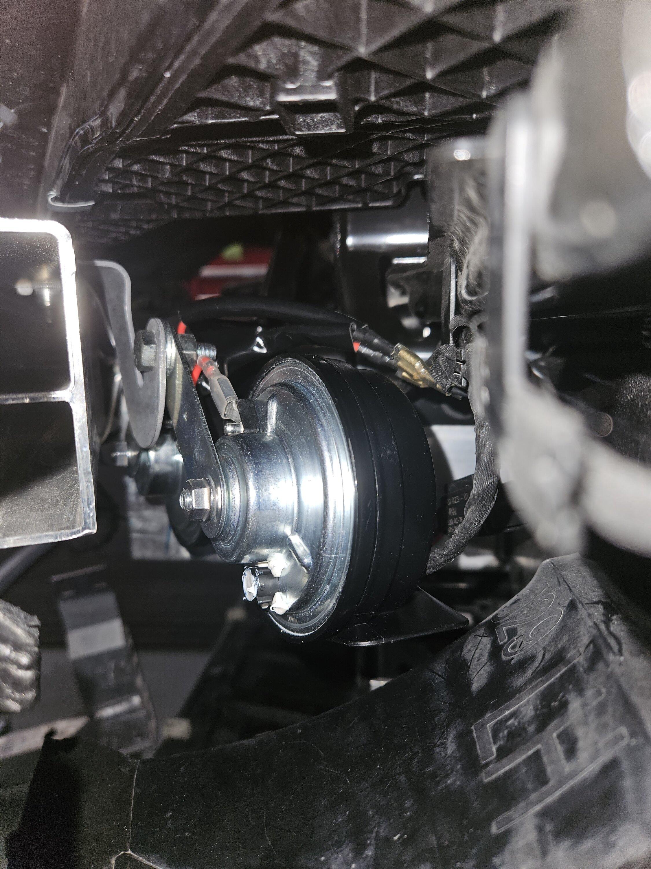

Another update.
Have a perfect plug and play, modern horn!
Running both Fiamm 72102 (High) + 72112 (Low) with a splitter.
Will need a center bolt/nut to hold the included brackets to fit onto stock mount (not included).
Will mount onto car 2mrrw, see how it fits.
Fiamm Dual sound:
Everything needed (~$50), amazon prime parts bin diving ?
Audi/Porsche connector:
Fiamm 72112 (Low):
https://www.amazon.com/dp/B000DINKPQ
Fiamm 72102 (High):
https://www.amazon.com/dp/B000FKKOK6
Splitter:
https://www.amazon.com/dp/B09N91P6NC
+bolt/nut mentioned
