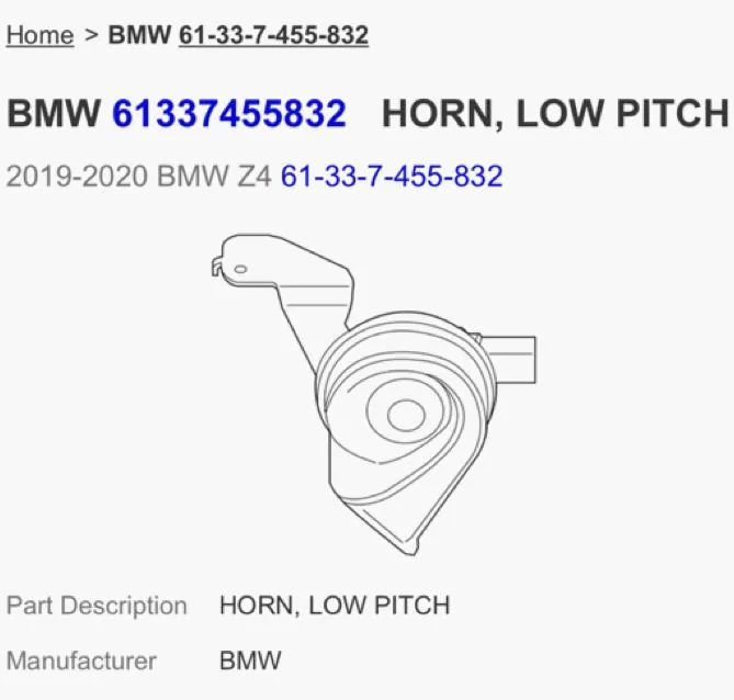

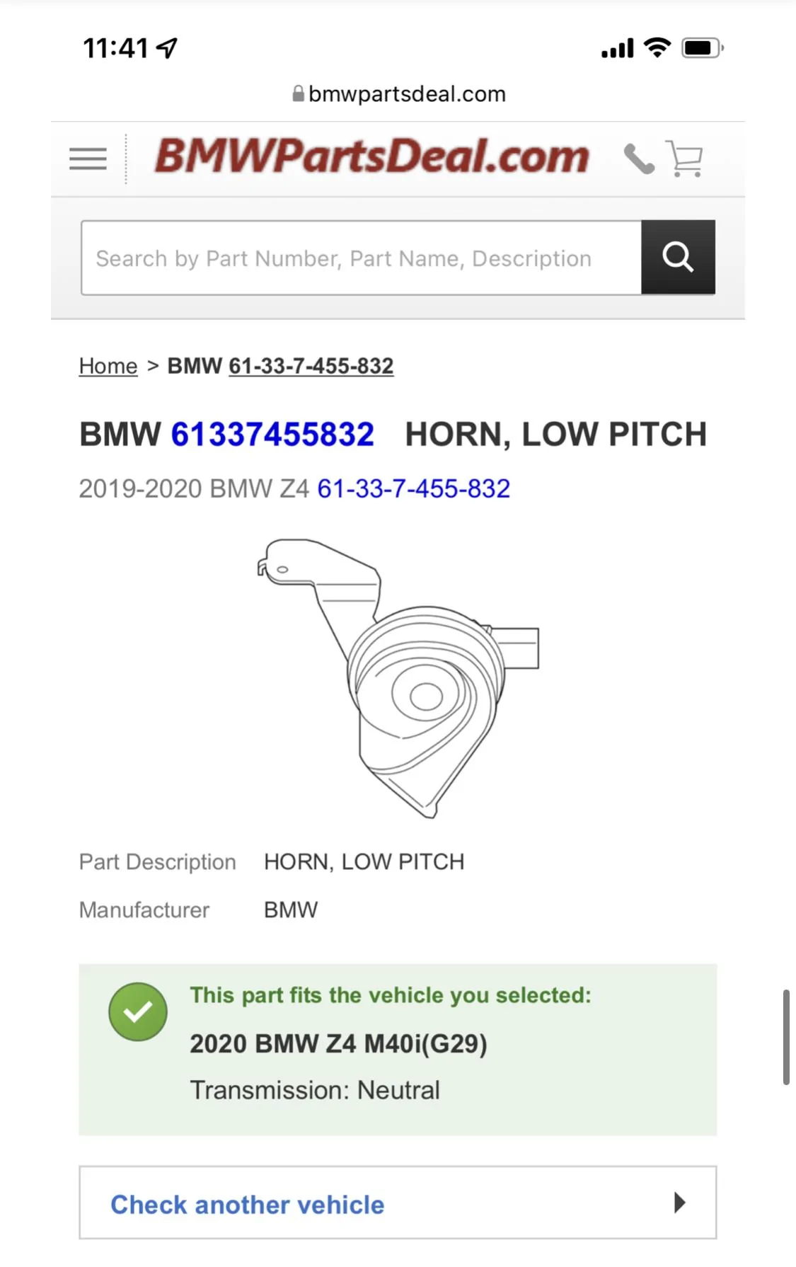

I know there has been talk of … but has anyone actually added the secondary BMW Z4 low pitch horn to their Supra?
My BMW tech has ordered one for me and plans to install.
Just checking with others…
There was one member based in the Middle East, he has done this mod.
would be great to see some pics of your installation by the BMW tech !

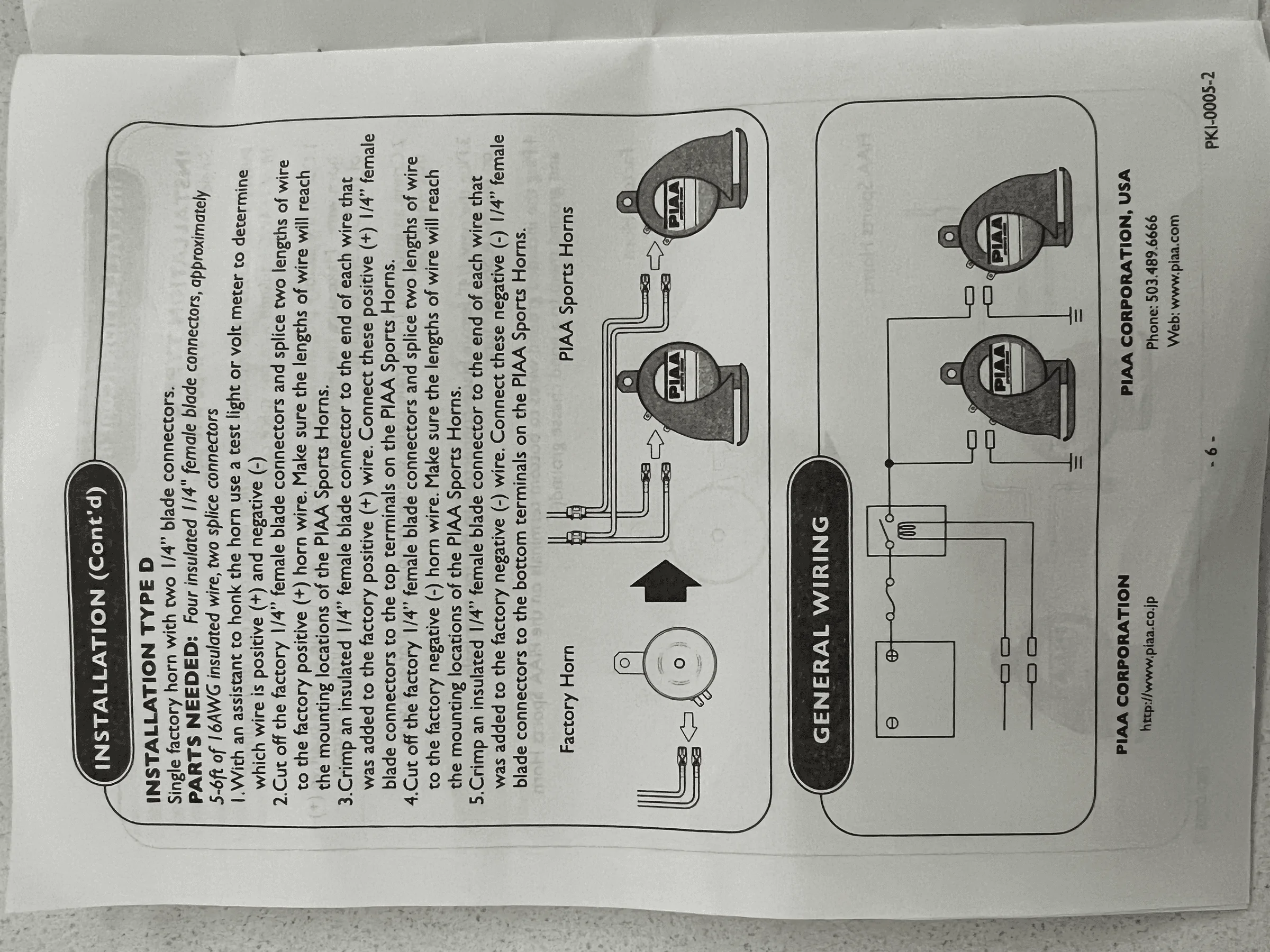

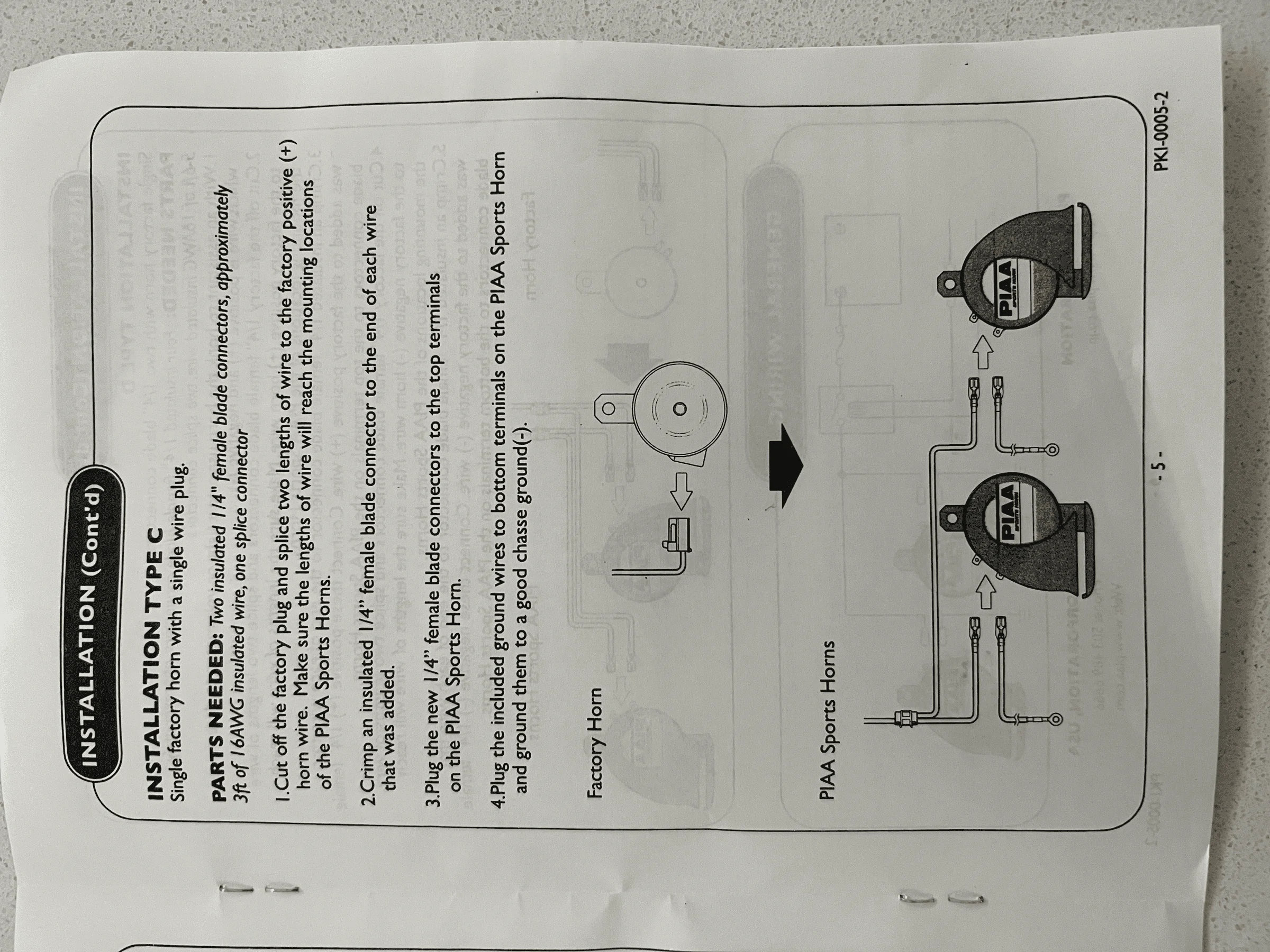

Is it a plug and play thing replacing the stock horn, or are you adding a 2nd low pitch horn? If you're adding a 2nd horn, please show pics of how it will be wired.?
I understand from previous posts that the front bumper cover must be removed to access the horn.
~ I will be adding the 2nd bmw horn (low pitch)… the bmw horn harness / connectors are being purchased as well. This way the existing horn wiring can be spliced and they can work in unison.
Pics to follow once installed.

I'm taking my GR to have the front bumper cover painted to repair rock chips this Monday. They are going to remove the front bumper cover which should provide access to the horn.
The paint shop is ok with me working on it while the horn is accessible.
Pics of reliable wiring to add an additional horn would be very helpful.... thanks all...
This video shows you how to wire it. Just power and ground.
