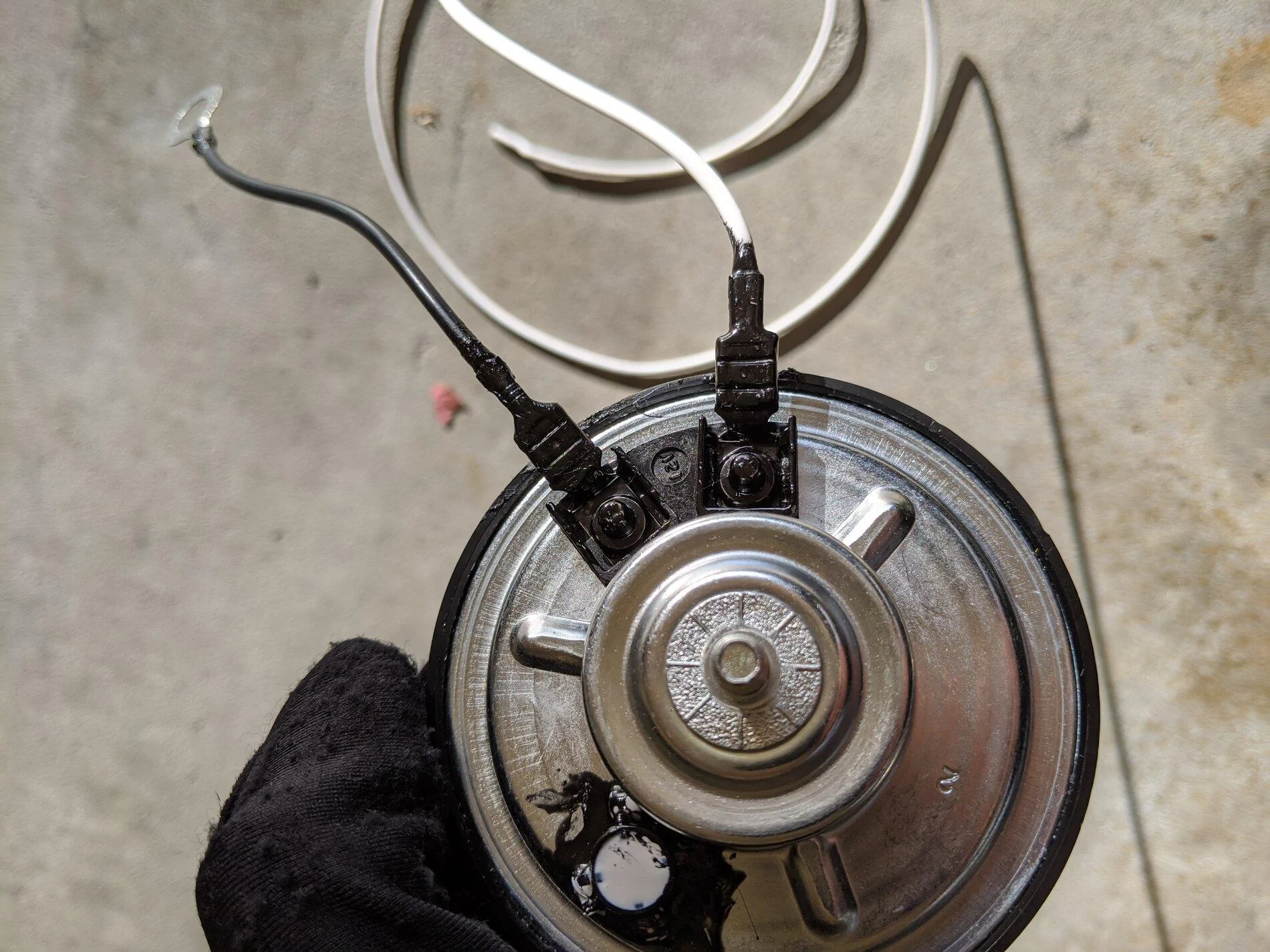

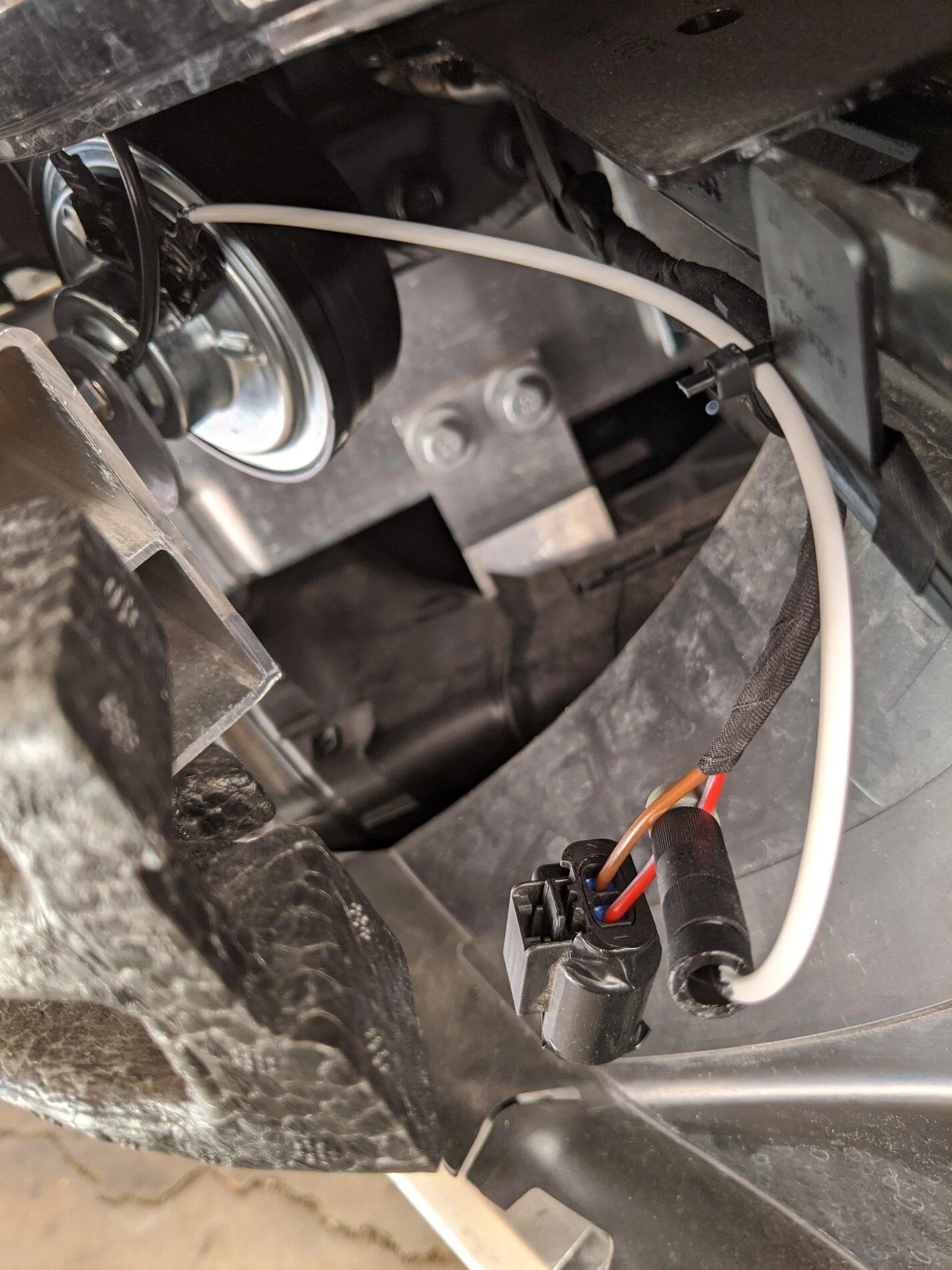

Did this recently, also used the FIAMM Freeway Blaster low note horn. It only comes with a ground wire so you would need some spare copper for the positive terminal. 16 AWG if you want to match the ground wire gauge.
I also coated the terminals and any exposed copper with Permatex liquid electrical tape. To tap in to the hot wire I used a Posi-Tap connector.

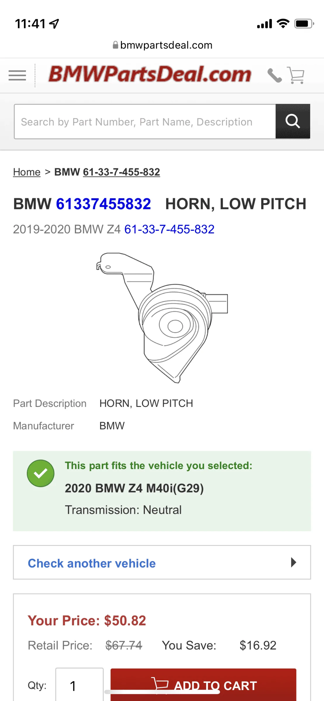

Has anyone looked at if the Z4 horn is a direct swap? I’d hope so.
(Z4 horn sounds much, much better - see throttle house Supra/Z4 comparison review for comparison).
We already have one of the Z4 horns, just missing the Z4 low tone horn. Other forum members reported adding that to solve our “clown horn” problem.

Here you go Z4 horn
i think you still have to tap the existing wires and run it towardw the secondary mount point at the opposite headlight.
It may be easier to just get a pair of twin tone horns which both fit at the existing Supra horn mount, and wire it up there.

I bought a FIAMM low tone horn, used a wire tap for the hot lead and a chassis point for the ground lead. There is room in that cavity to mount the additional horn
