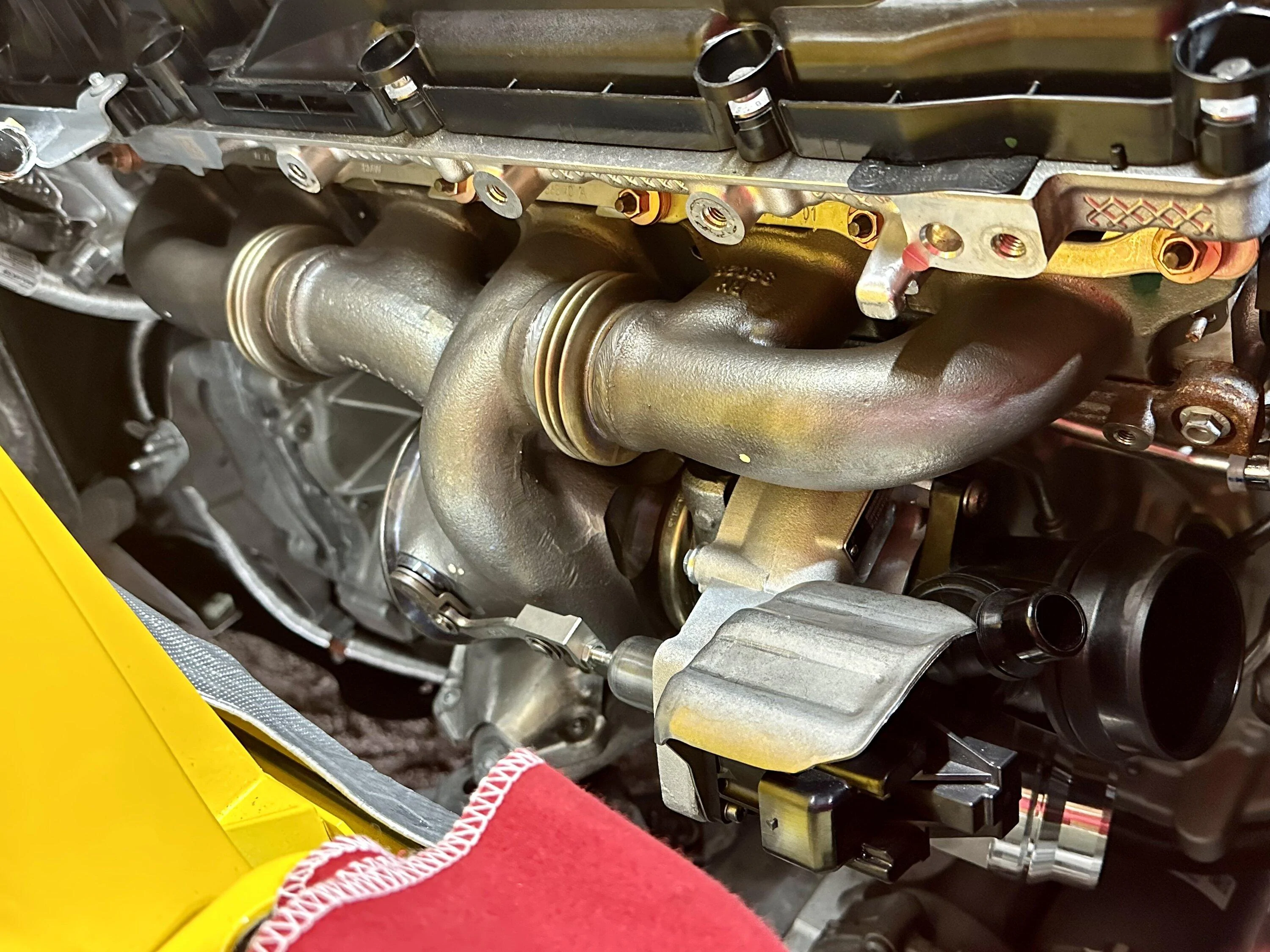

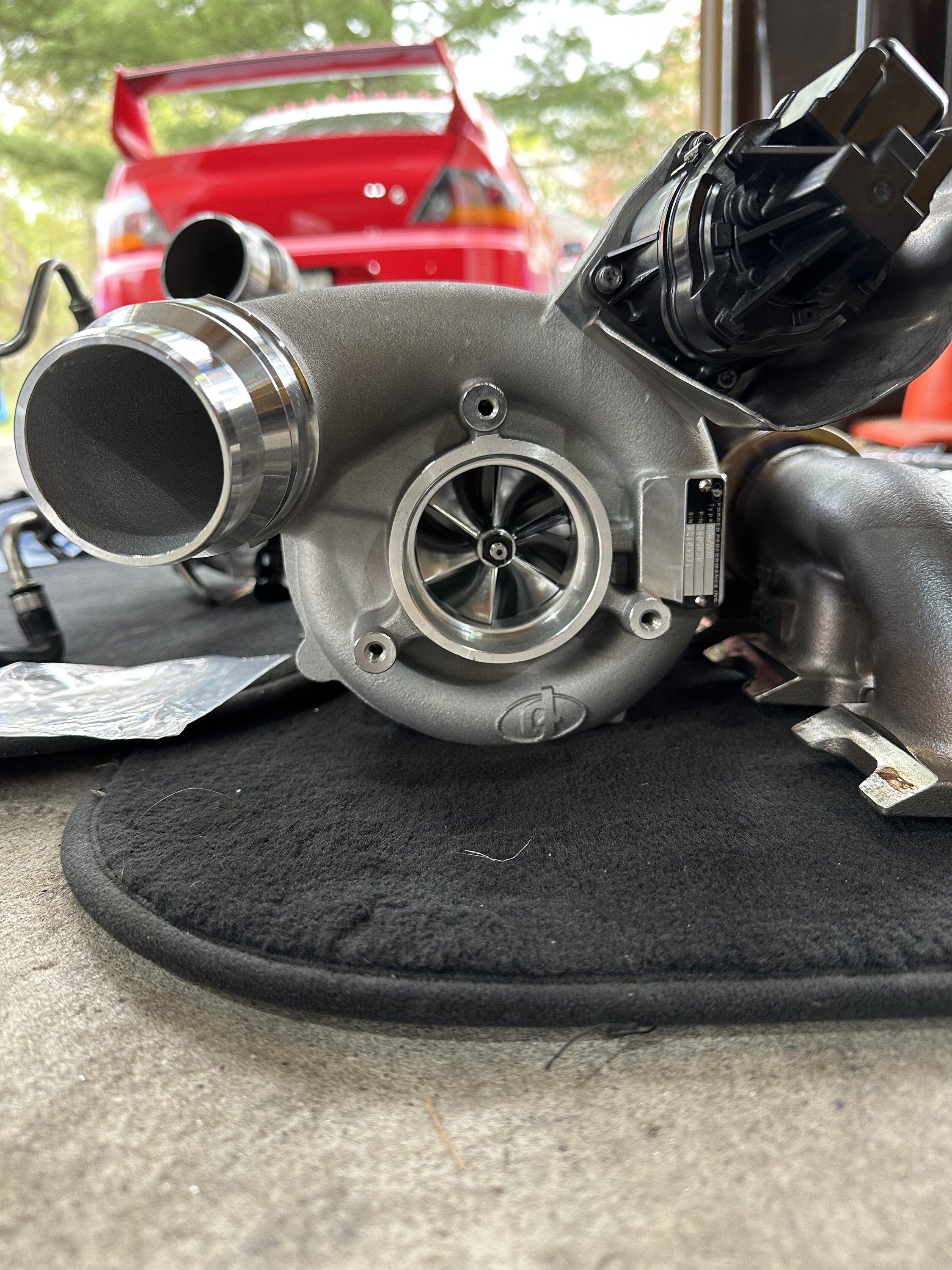

Hey everyone! I’m not much of a forum guy anymore, so I may not post much, but I at least wanted to help when I found this thread.
Long story short, with no research done, I grabbed this turbo a few months back. Having great past experiences with FP personally (I currently run the green uhf on my evo 9), and with customers and friends in the past, I wanted to try it on my 21. Well not until doing research recently, did I learn that it was not confirmed it fit the 6 port manifold.
Fast forwarding to last weekend, I decided screw it, I’m just gonna try it. Well, I can confirm that it does in fact work with the 6 port manifold! I’m not gonna say in two weeks, but I’m hoping to have pump and e50 numbers soon!
Oh and thank you @itsbassi for being cool enough to keep me in the loop on his progress ??.

I have owned over 15 Evos so know the fp line up very well. This green seems more like an hta71. Green have a different turbine housing usually. Would be in on a red or something that flows 65 lbs to 70 lbs. FP stuff with xona billet housing is nice.
Agreed. In the past a cold side only setup was not considered a Green. Would be more accurate to call it an HTA

Did you change out all your gaskets? Local bmw still hasn’t got my order in :( been over a week with my green just sitting here… how’s it driving for u
Yes, I changed every “one time use” part associated with the swap. I ordered all my parts through Toyota, and it took about a week to get everything together. Apparently the big hold up is the exhaust manifold nuts for some reason lol
I’m still going back and forth with Visconti on my tune, but so far on pump and e30 it feels great! Once my tune is situated, I’m hoping to hit the dyno and get pump and e50 numbers ??.
