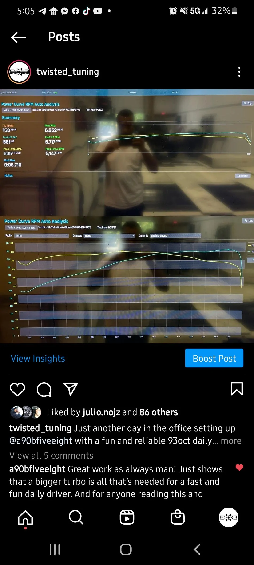

@Jackie.A90 if 500whp is what you want without ethanol. P800 will get you there and is a simple setup.
Here's a customer of mine. P800 downpipe and 93oct and custom tune by me
That's 560 at the wheels I assume?
I'll be looking for a turbo upgrade in the spring and I want a solid 125-130mph trap on pump (91-93) is this do-able with the 800 or will I have to go for the 850?
