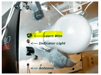

I have Genie Intellicode. Main unit has a learn button under the plastic covering over the lights. Have to press that then jump down and get in car to complete process. Can be rather amusing based on your garage lay out. This isn't as much about your car as it's your garage door trying to protect you.
Jeeze that sounds like a lot of fun?
That means car has to be in garage while you play with the buttons on the ceiling!?
Depending on size and shape of garage, you can push car forward and to the right to make space for a chair or step ladder between driver door and driver seat. then you can hop down and get in car with plenty of time. Honestly, you can probably make 20' to get into the car in the drive way. 30 seconds or whatever it is is longer than you might think.

Mine works great. As probably already mentioned, you have to put your garage door opener into a learning mode also. Once you do that, you are good to go. It's really nice not having to have an actual opener in the car, especially since I only have two.
