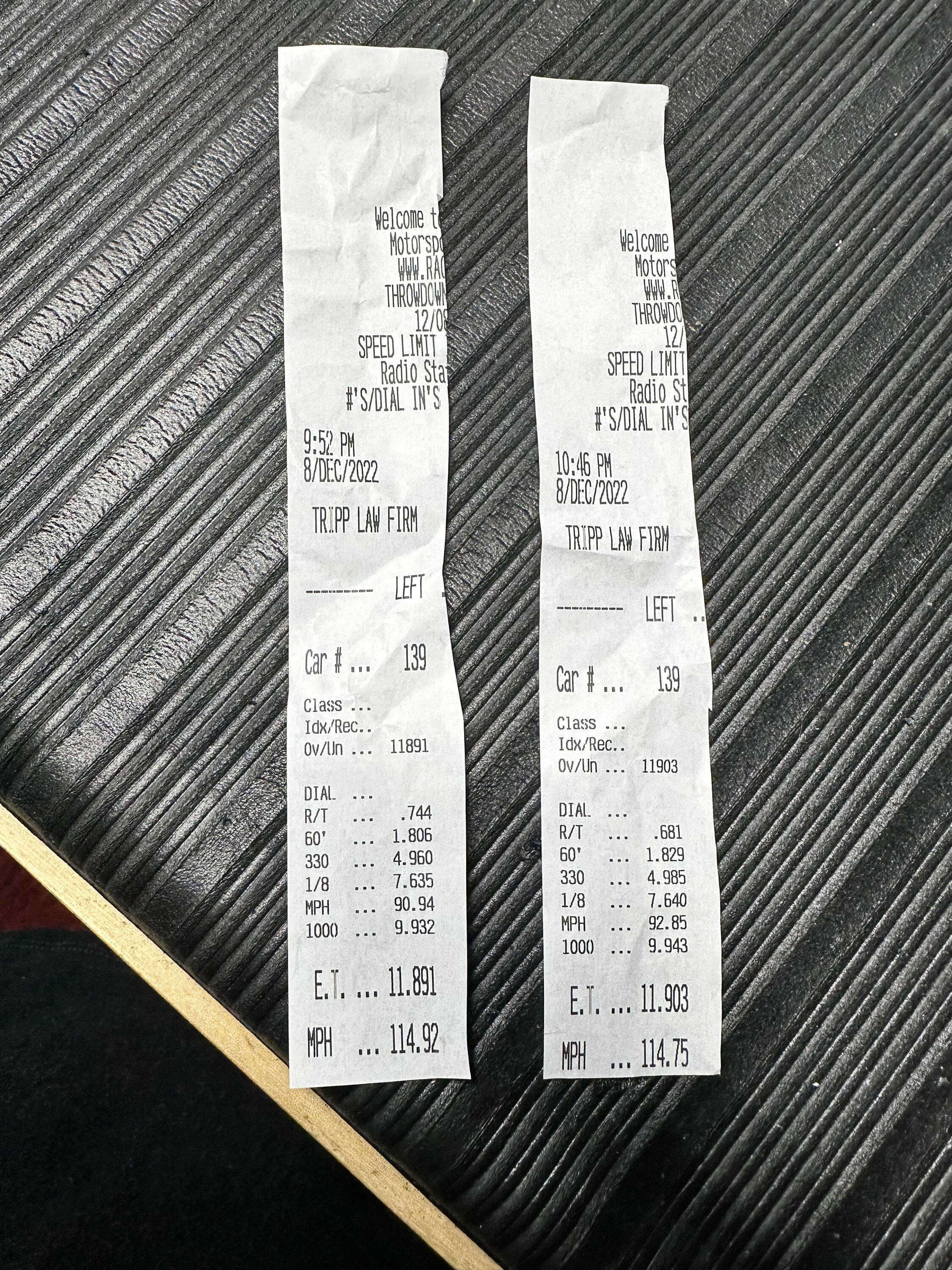

Got a chance to take it to the track tonight- real world testing in FL

The fact you went to Bradenton to test your new ride out is awesome! Appreciate your real world, plain and simple write up/post on this subject. When do you plan on adding Sebring to your checklist and see what else your new toy can do? ? Hit me up anytime you’re considering it. At least until May. After that, you already know what it’s like down here. ?

The fact you went to Bradenton to test your new ride out is awesome! Appreciate your real world, plain and simple write up/post on this subject. When do you plan on adding Sebring to your checklist and see what else your new toy can do? Hit me up anytime you’re considering it. At least until May. After that, you already know what it’s like down here. ?
