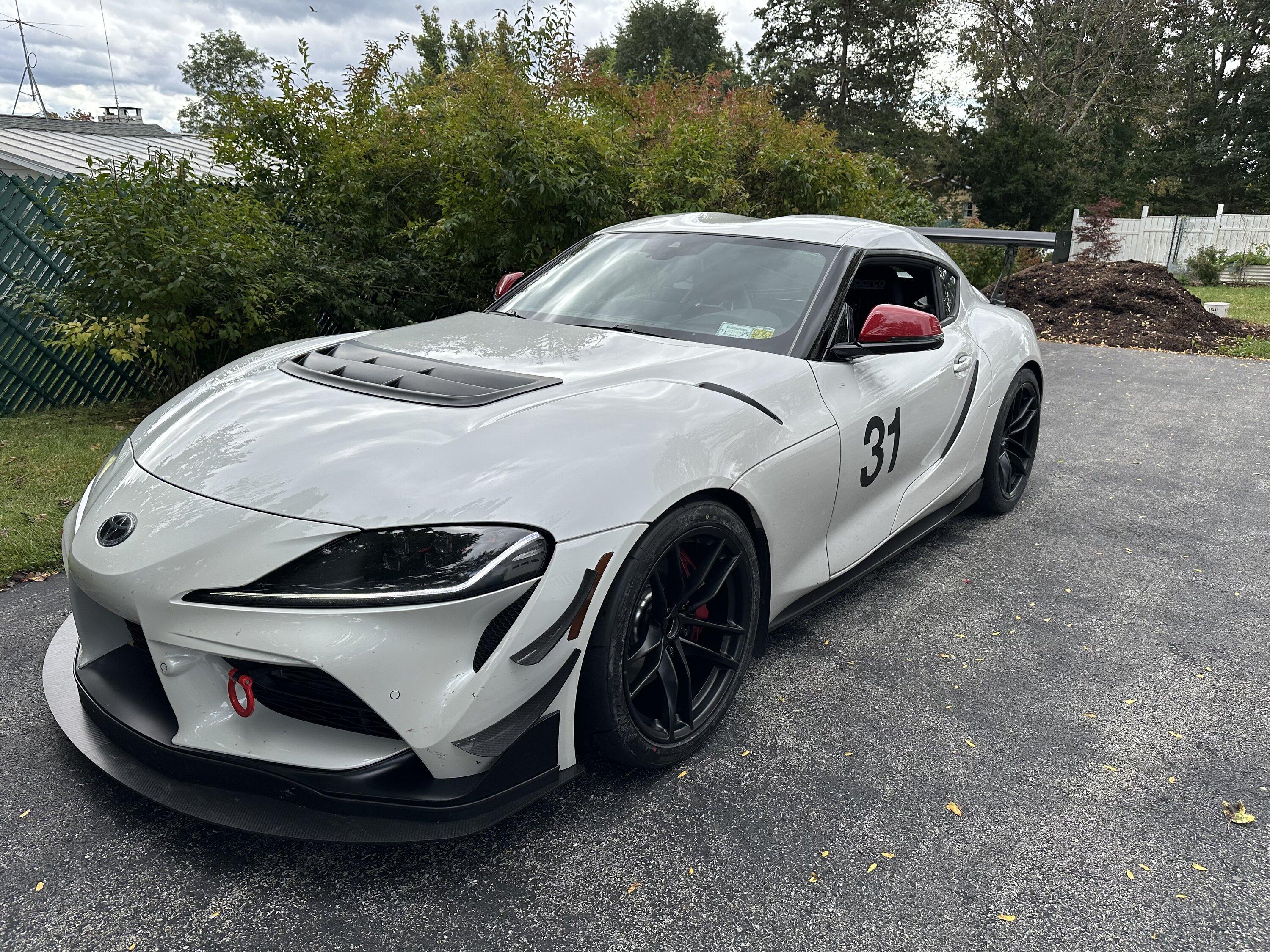

When I bought the Supra it was to have a track capable car without having to modify it like I did all my previous "track" cars...
and here we are...
Did you notice any difference, or have any issues with your hood vent?

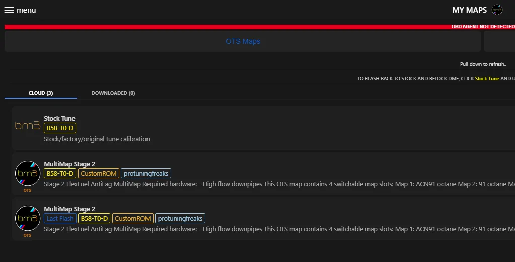

Well if you need to update your ECU you're going to have to take it back to the dealership. BM3 does not delete or overwrite the stock tune as it is always there. However, the dealership will most likely lock the ECO again, but you don't need to ship it to Femto again and it will just be a bench unlock. Which most garages can do. As for your second question, I am not sure about MHD, but BM3 licenses can be sold to someone else, so yes BM3 does have resale value.
I took a screenshot to help answer your first question.

Not correct. The original rom on the car is over written with BM3. The stock rom in BM3 is whatever they have on their server for the car. Just to be clear: BM3 does NOT read out your stock rom and store it.
Just went through this with them. My original ROM on the car didn’t need bench unlock. Now if going back to “stock”, I need a bench unlock as the ROM on their server is newer than what was originally on the car.
