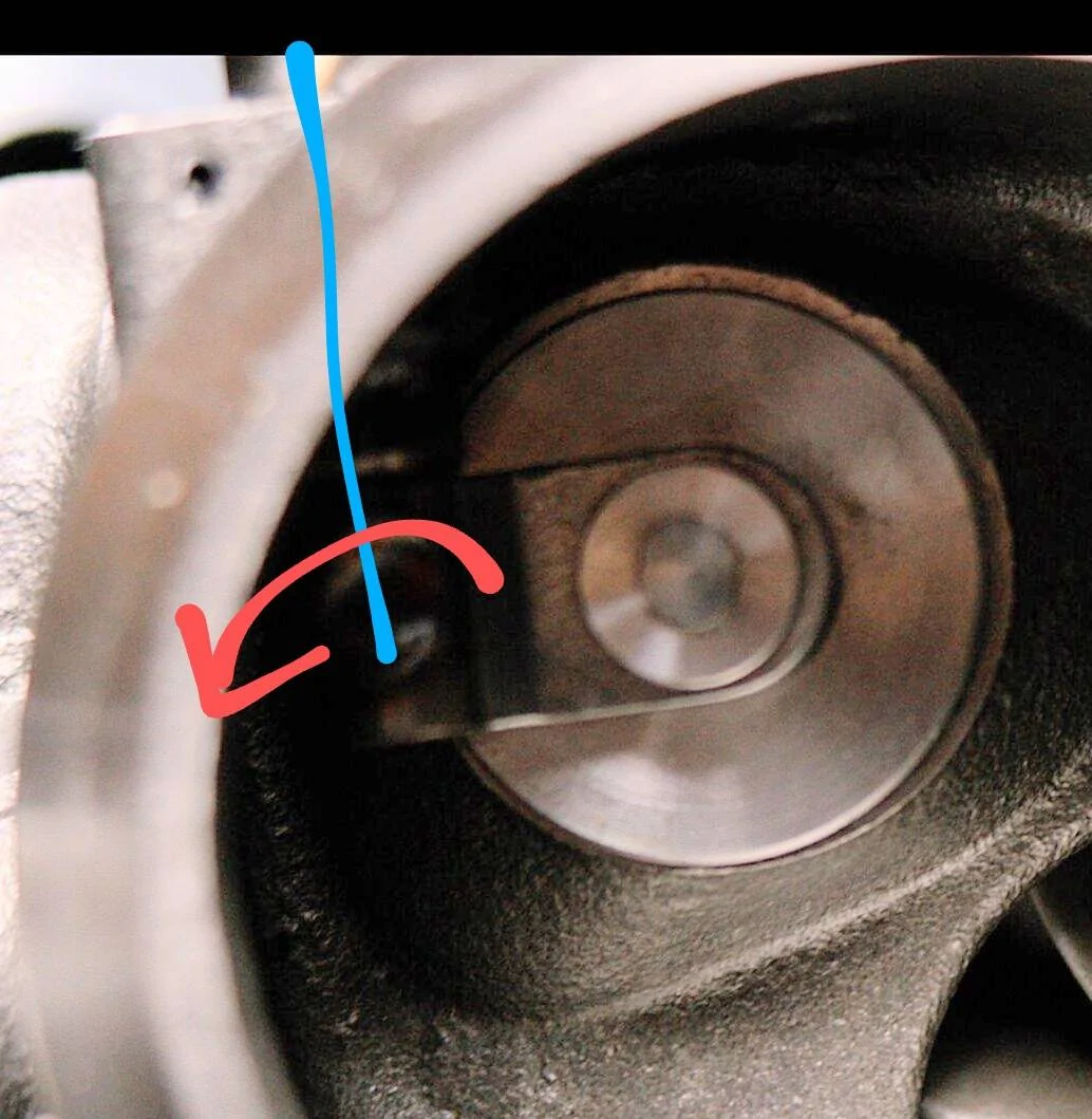

The wastegate arm is an inferior design being two pieces instead of one piece cast. It heats up and separates and no flappy wastegate door closure no mo’

up until this point I've only heard about the wg extension rod requiring adjustment. I think this is the first time I've heard about the flapper arm itself bring a potential issue, but the concern makes sense if its an interference fit.

There was actually a post on this forum about it months ago. Also some others but not posted on this forum. Most turbo WG flapper arms are cast as one piece (minus the flapper). This one unfortunately is two piece and the weld can fail with track use.
