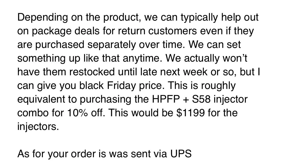

If anybody is in the market, Dorch is offering thier Supra HPFP and Bosch S58 injectors for approx $3k. I just got the combo and they will honor the price through their Black Friday special. Proven to make up to 700WHP, easy to install, and MHD has easy drop down features for both. Best bang for fueling up to 700WHP.

I've been in talks with them over the past week since the confusion with the MHD drop down and they were willing to do a bundle before black Friday because I made it clear that I wanted both. They told me I could broadcast the pricing and anybody can email them for it until the black Friday special. I'm going to be an oddball and hope to go sub 7 sec 60-130 on stock turbo with DI/ethanol until I decide on which turbo to get.

No, the price is the gen2 HPFP. I just ordered them and they are offering the same price if you reach out. Great deal!
