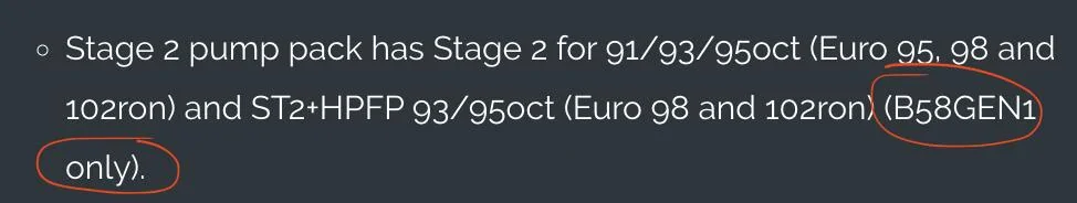

Stage 2+/HPFP Question:
MHD lists Stage 2+ OTS map as requiring the HPFP to be upgraded.. I seemed to recall this isn't really necessary?
I'm on a stock airbox, upgraded charge and intake pipe with a 200 cel cat DP. Also running 98RON (93) exclusively.
With reliability being my main concern, can I safely run the Stage 2+ OTS map without a HPFP upgrade or should I just stick to the Stage 2 OTS map?
Thoughts?

That's for Gen 1 B58. No need for Gen 2 B58
8,806
17,269
Thanks mate. Complete newb to tunes here. And reading, it would seem. ?
Wait.. I read that as Stage 2+ being for gen 1 only?
Stage 2+ HPFP is for gen 1 only. Gen 1 has an OEM HPFP that flows less than Gen 2.
