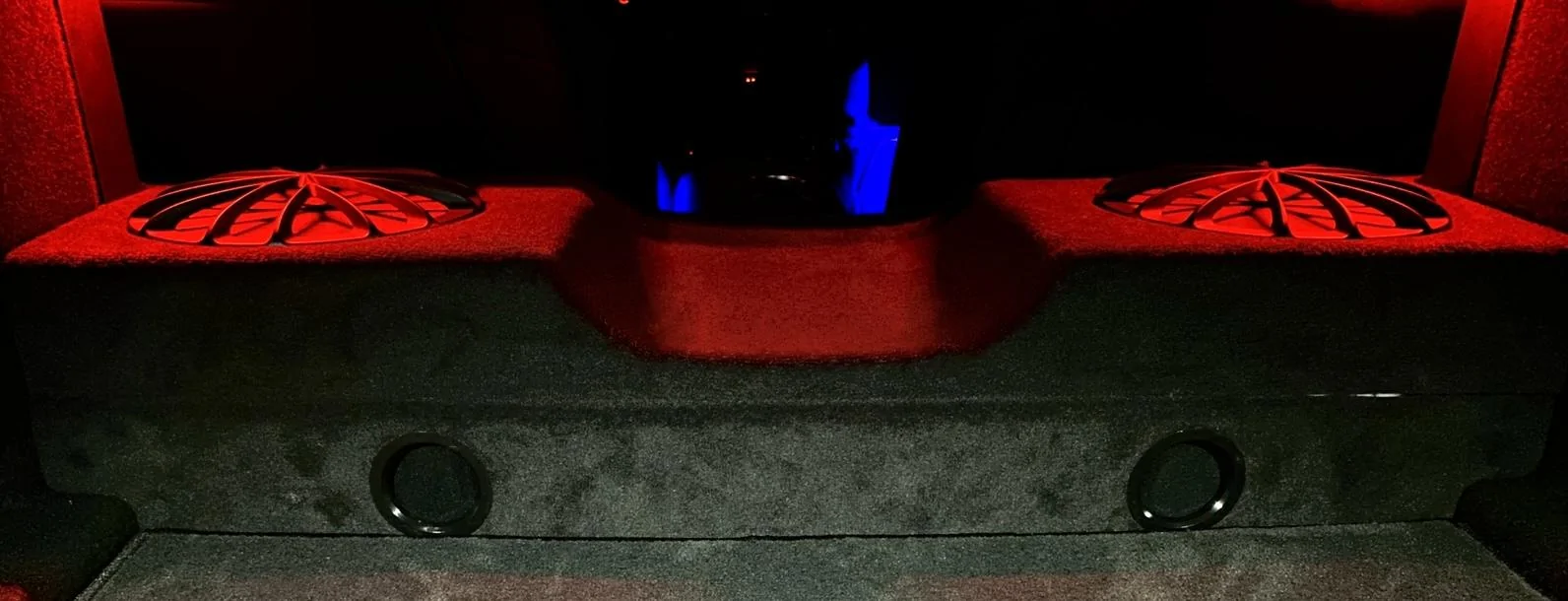

Anyone paint the area where the grills / ports go? On my car it's yellow and you can see it through the grills at the right angles. If it were a bright / crisp yellow like the car I think I would like it, but it's mostly overspray there so it's a faded yellow. I think I may spray it black so you don't see it at all, but I'm not thrilled with spraying the inside of the car TBH.
I used soft speaker mesh from an old home theatre speaker I had lying around. 3M double-sided tape holds it in place and it should be mostly acoustically invisible as it came from an old woofer cover. It completely obscures the ugly paint you’re mentioning.

Considering how little visibility there is through the ports, you could probably do the job with a Sharpie or other permanent marker rather than worrying about spraying it (either that or just use a small 1" trim roller to coat the area. Either that or do what Bassoony, tadda, and others have done with cloth, screen, etc.
One note if using grill-cloth like Bassoony... although audibly invisible, many are more than dense enough to cause loss of pressure... which can defeat the purpose of the ports entirely. They're fine in front of transducers with limited extension, but not as good for actual ports where volume and pressure are the key parameters.
HA! That's exactly what I did - giant Sharpie! It's not perfect since the finish isn't quite right obviously, but nobody would ever know except me (and now everyone on this forum).
