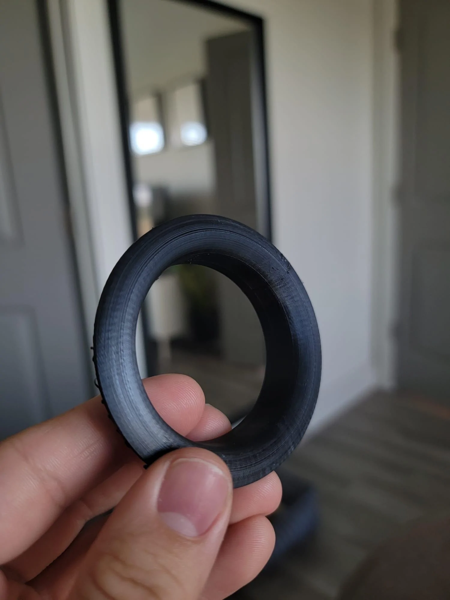

In case there's still people doing this mod, I made a 3D printed speaker port

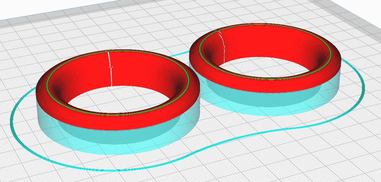

I didn't feel like spending $10 a port from amazon, nor did I felt like waiting long for a cheaper port, so I made my own one. I'll attach the STL so you guys can print it too!
I printed the speaker ports facing upwards, so that it's nice and smooth like on the picture above. This is how I printed it, for a better visual aspect:
I printed these at:
Infill Density: 30%
Layer Height: 0.06mm
Wall Thickness: 1mm
Print temperature varies with material, and quality (mine was 210F with PLA), so use to your typical choosing.

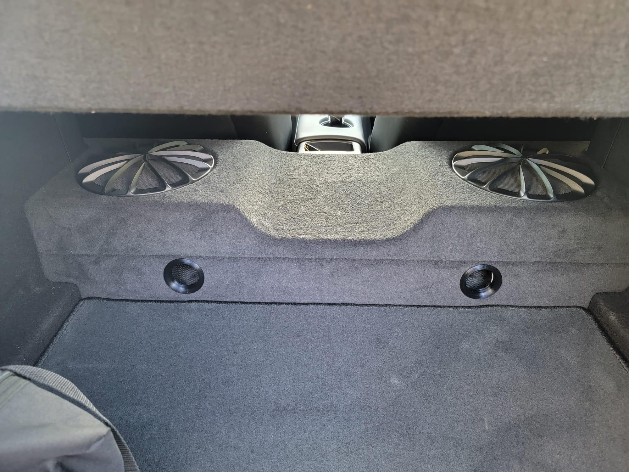

Overall the ports look great and they basically snap in the 2" holes (very satisfying). You be the judge on how it looks:
