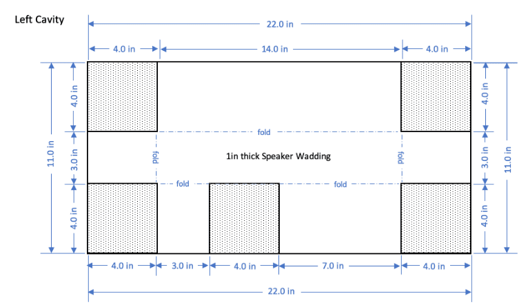

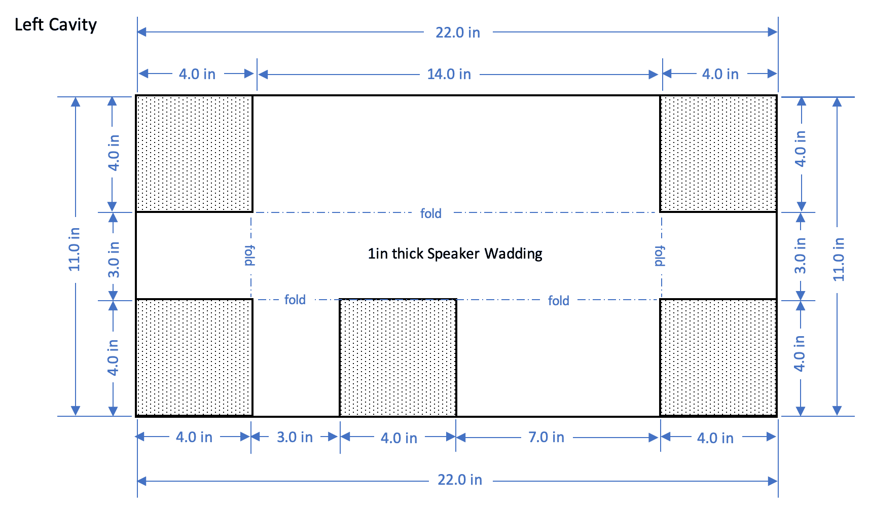

@tadda - 2 Questions for you:
1st: I see this template says Left Cavity. I assume the right side is just reversed (same template just flipped around)? Also, when stuffing this inside the sub box, this foam only covers 3 sides of the box. Which side of the sub box doesn't get this wadding? The top?
2nd: You mentioned putting Noico RED 315 mil Sound Insulation at the locations below. Can I use the Dynamat instead? The Noico seemed expensive for how little I would need and just curious if the Dynamat will do the job good enough.
tadda
tadda
Tom
Dec 14, 2019
1,251
2,157
Arizona
1st: I see this template says Left Cavity. I assume the right side is just reversed (same template just flipped around)? YES
Also, when stuffing this inside the sub box, this foam only covers 3 sides of the box. Which side of the sub box doesn't get this wadding? The top? YES
2nd: You mentioned putting Noico RED 315 mil Sound Insulation at the locations below. Can I use the Dynamat instead? The Noico seemed expensive for how little I would need and just curious if the Dynamat will do the job good enough. I used the thicker adhesive backed Noico foam to fill a gap space Dynamat is too thin...Any thick insulation foam strip would work fine here...
Answers above in Red

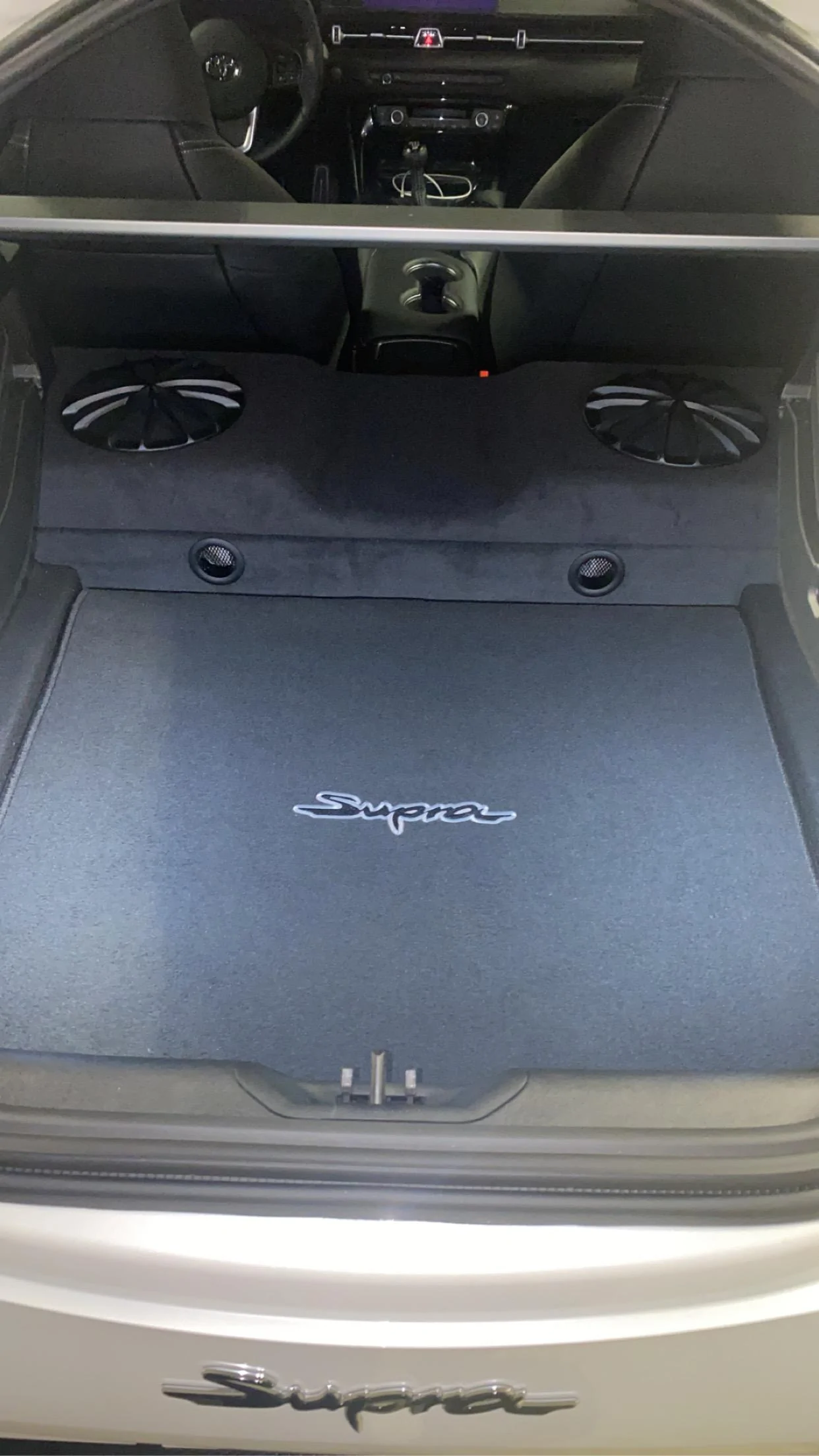

First mod I did to my '23. Improved the lows considerably. Totally worth it!
Found some cheap grills that looks decent. Ignore my dirty trunk mat.
