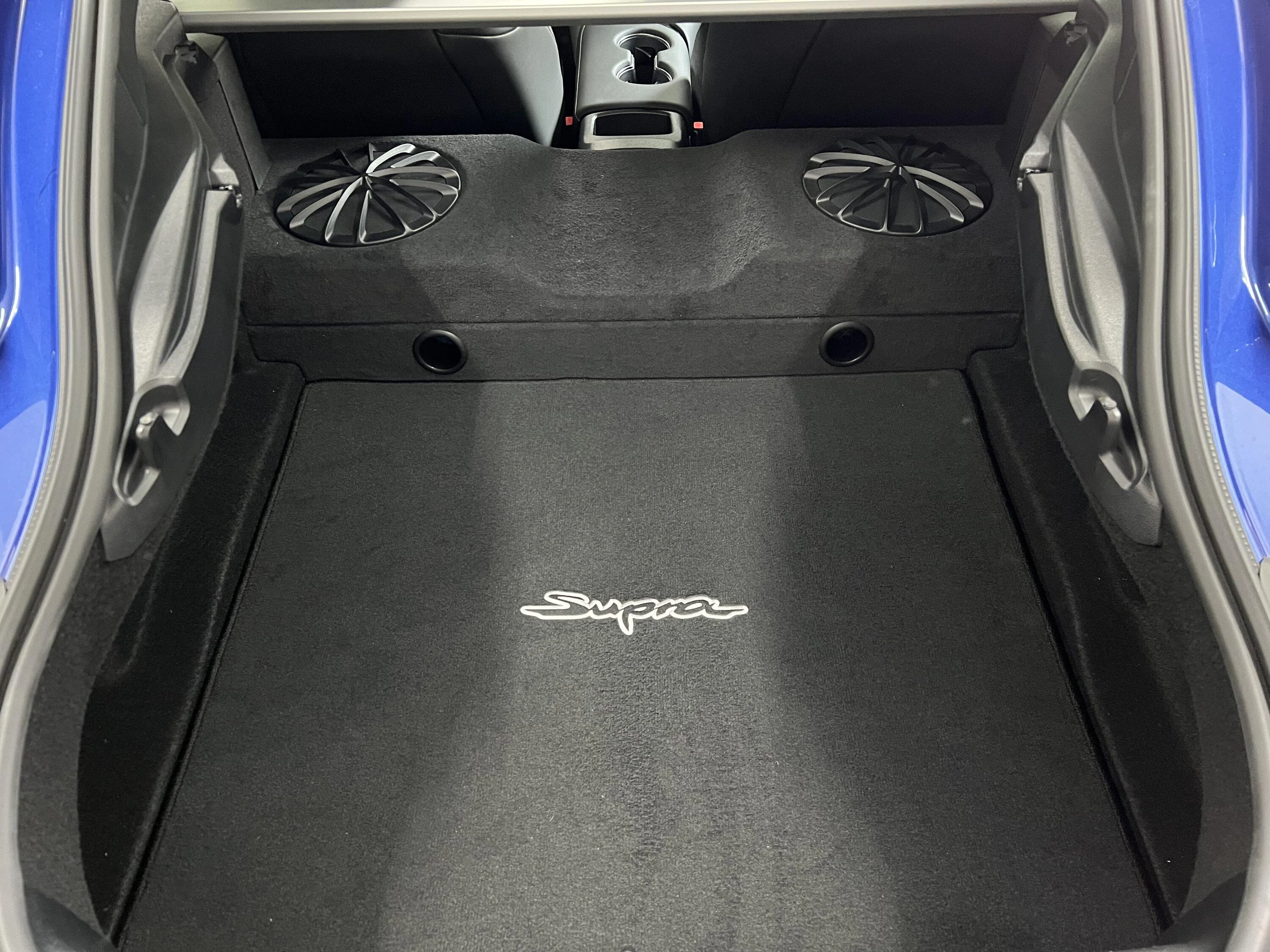

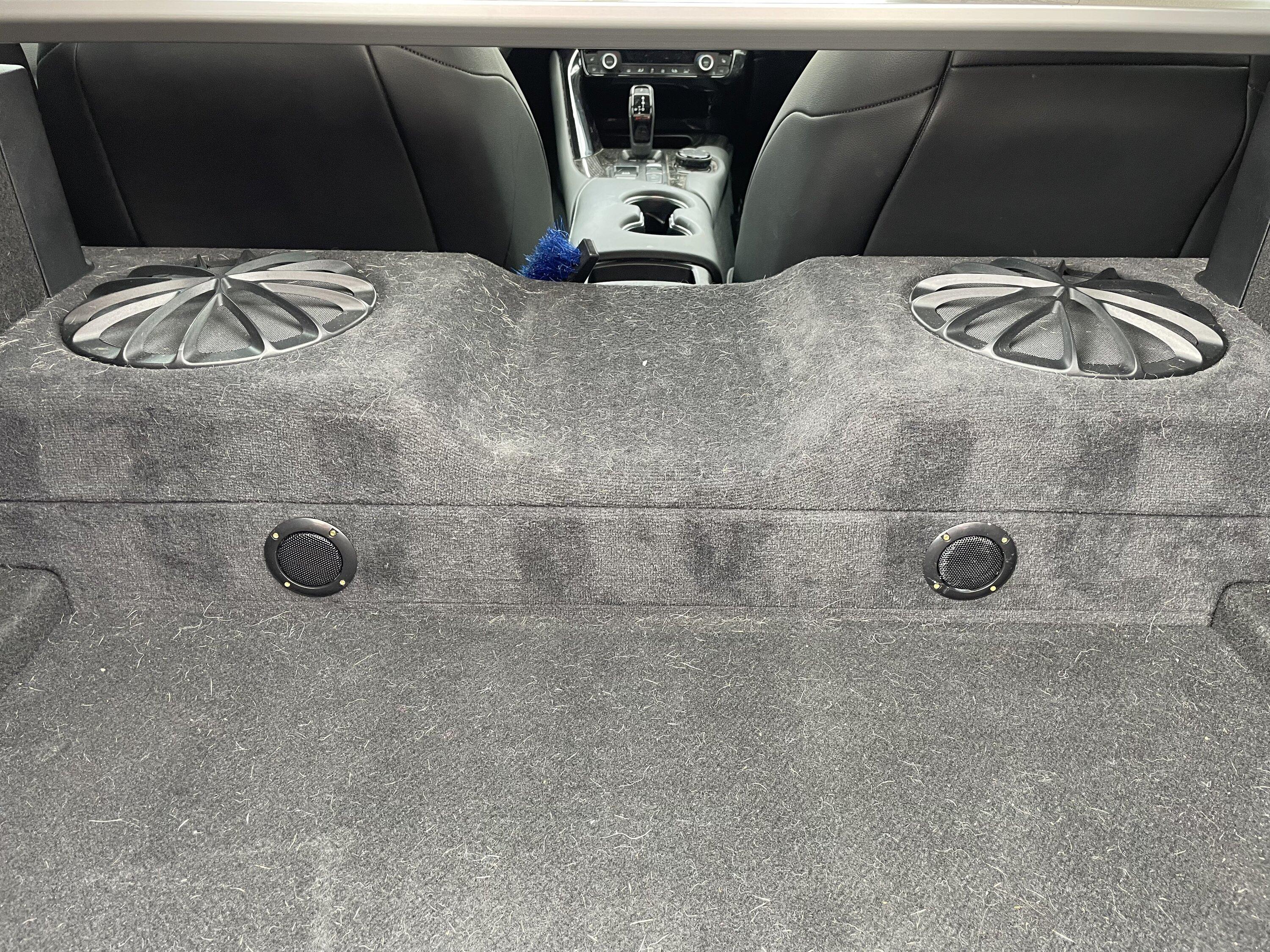

Just went through yesterday and did this. Definitely worth the effort to do. Instead of the speaker tubes I just used little speaker screens to cover the outlet. Next project is the front doors to add wadding to the door speakers. Thanks to everyone that has added input.
ignore all the dog hair 😂
NINaudio
George
Mar 2, 2023
110
92
Illinois
2023 Supra 3.0 Premium
Nice, that is what I would consider doing as well, or the port tube with a screen behind it.

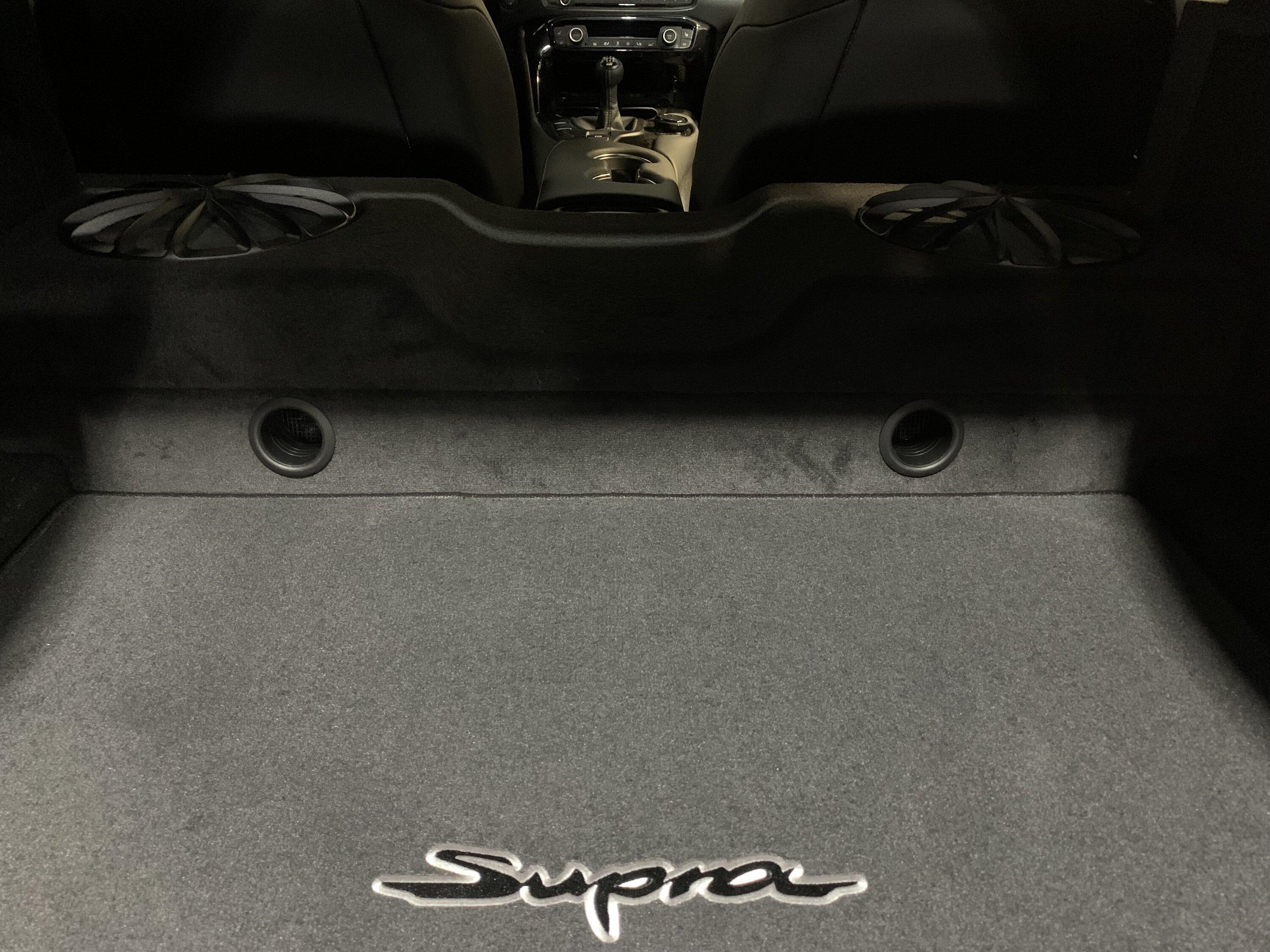

I was thinking of adding smaller, higher horizontal ports - see image. @tadda While I know they will allow less air out, do you think they will still have the same relative effect?
My main reasoning is that the boot mat I want to get has a lip which will obscure the ports.
Thoughts?
jtsang25
May 28, 2019
70
2,471
2,365
Thoughts?
Cut the mat.
