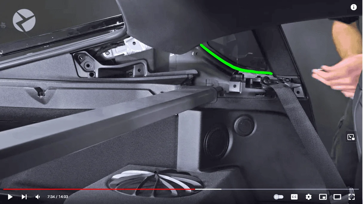

I replaced the OEM trunk bar with the Cusco brace and also added Tesa felt tape to the bottom of the window (green area in photo) where the two interior trim pieces touch - it seems those pieces tap on the windows when the car flexes over bumps. My creaks and rattles are nearly all gone!
Wondering if that's where my squeak is coming from, although sounds further back.
Is that panel quite easy to remove? Did you use felt tape?
Yes, I used the Tesa brand felt tape.
The trim pieces are two separate sections that are just held with clips and pop right out. The one further back comes out first, then the one under the b-pillar around the seatbelt.
There are videos of this if you search for either the harness trunk bar install or an audio/speaker replacement video.
