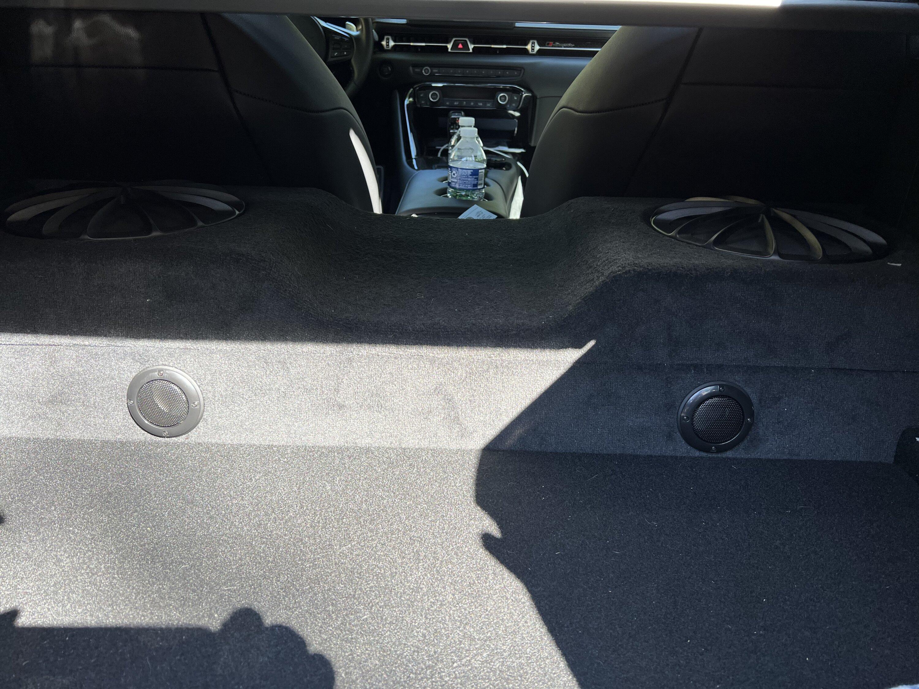

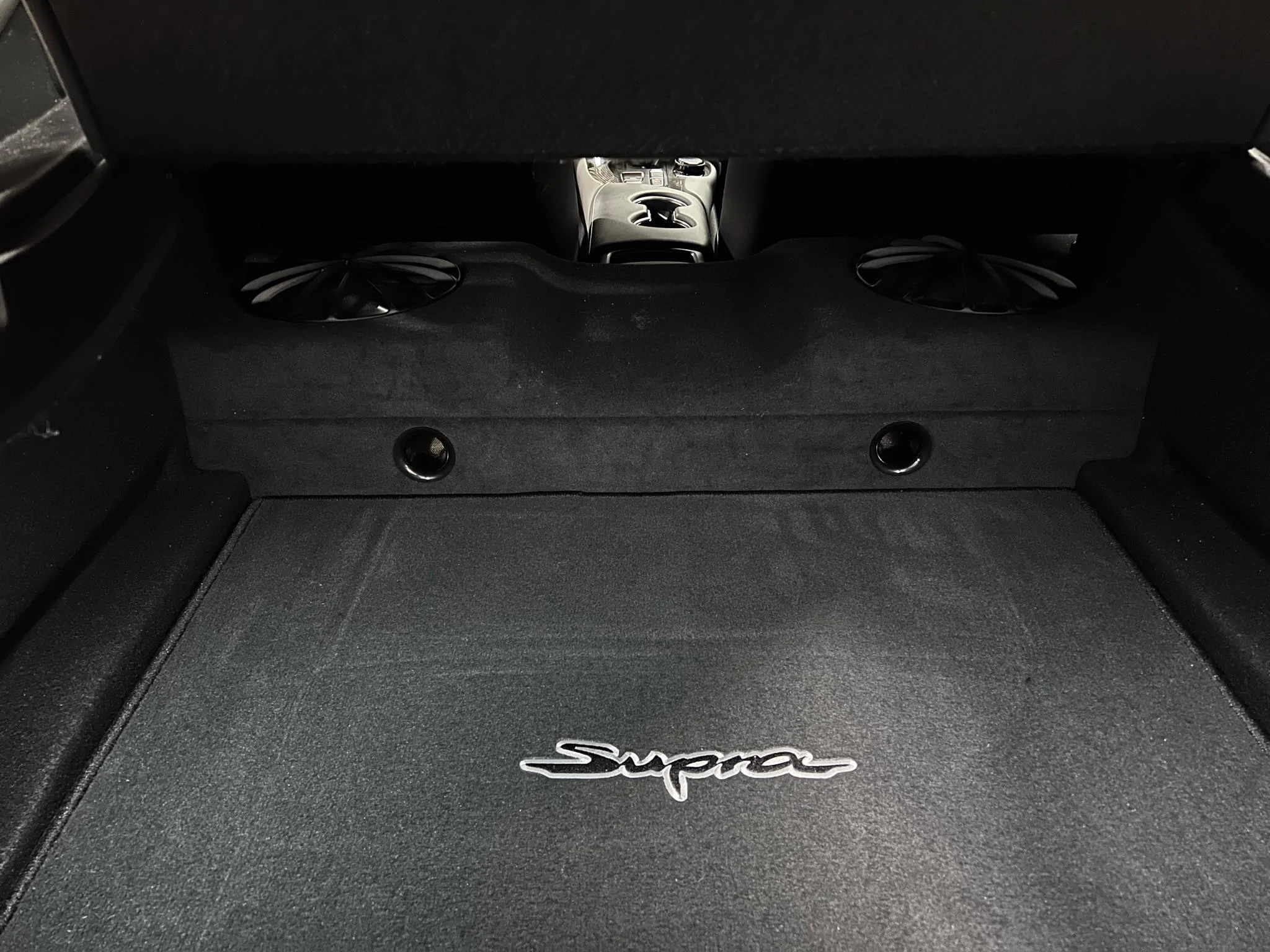

Pardon the glare, but after doing to mod this is what my trunk looks like. I decided to put the speaker grills on the outside of the sun instead of inside. I think it blocks the foam on the other side a bit more but both ways look OEM in my opinion.

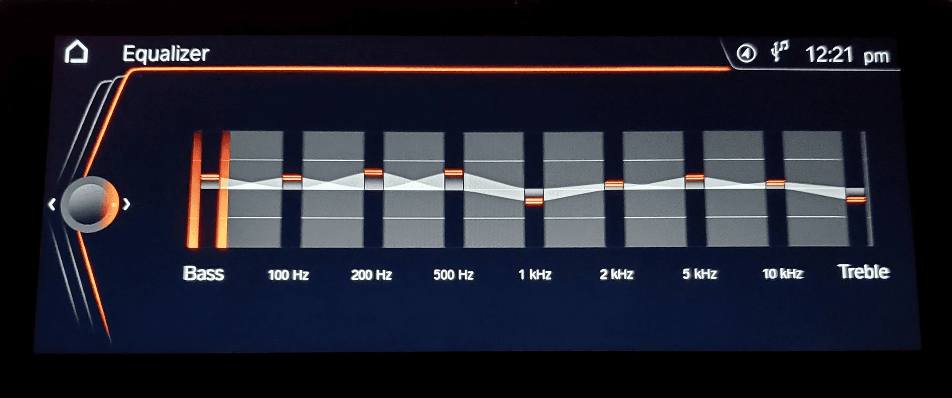

Here are my current audio settings:
  • ASD / Active Sound Design (off - using Bimmercode)
  • Surround (off)
  • Speed Volume (0)
  • Balance: (0)
  • Fade: (front +2)
  • Broad Bass (+2)
  • Broad Treble (-2)
  • Equalizer (shown below)
These are my new EQ settings (below) after improvements made to current OE Subwoofer system...I can now raise the volume to 2/3 of max with no low bass distortions or vibrational noise...
How to Setup and Optimize Sound Quality using OE Equalizer
