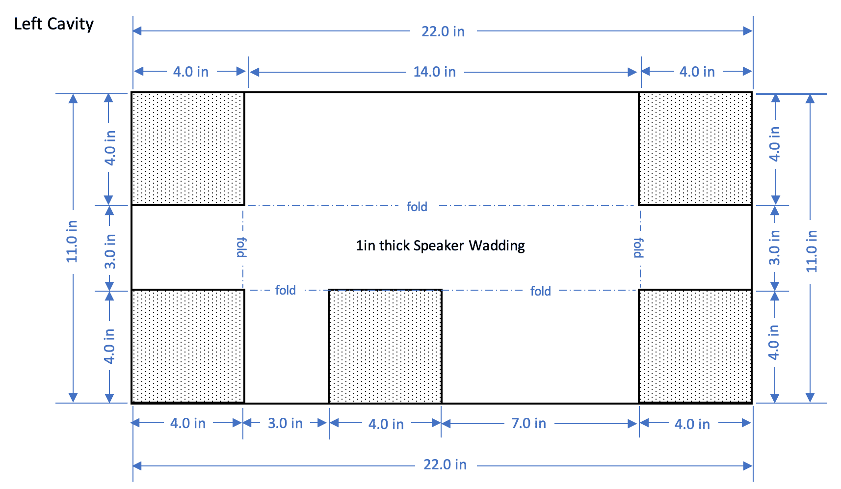

Quick question…. On step 1…. Does the center part of the 1” wadding go up towards the roof, or down towards the ground?
I am talking about the part of the wadding that is 3” x 22” in the diagram below.
Does it wind up being up or down?
tadda
tadda
Tom
Dec 14, 2019
1,281
2,298
Arizona
Should be lined around side and bottom of the enclosure
