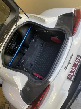

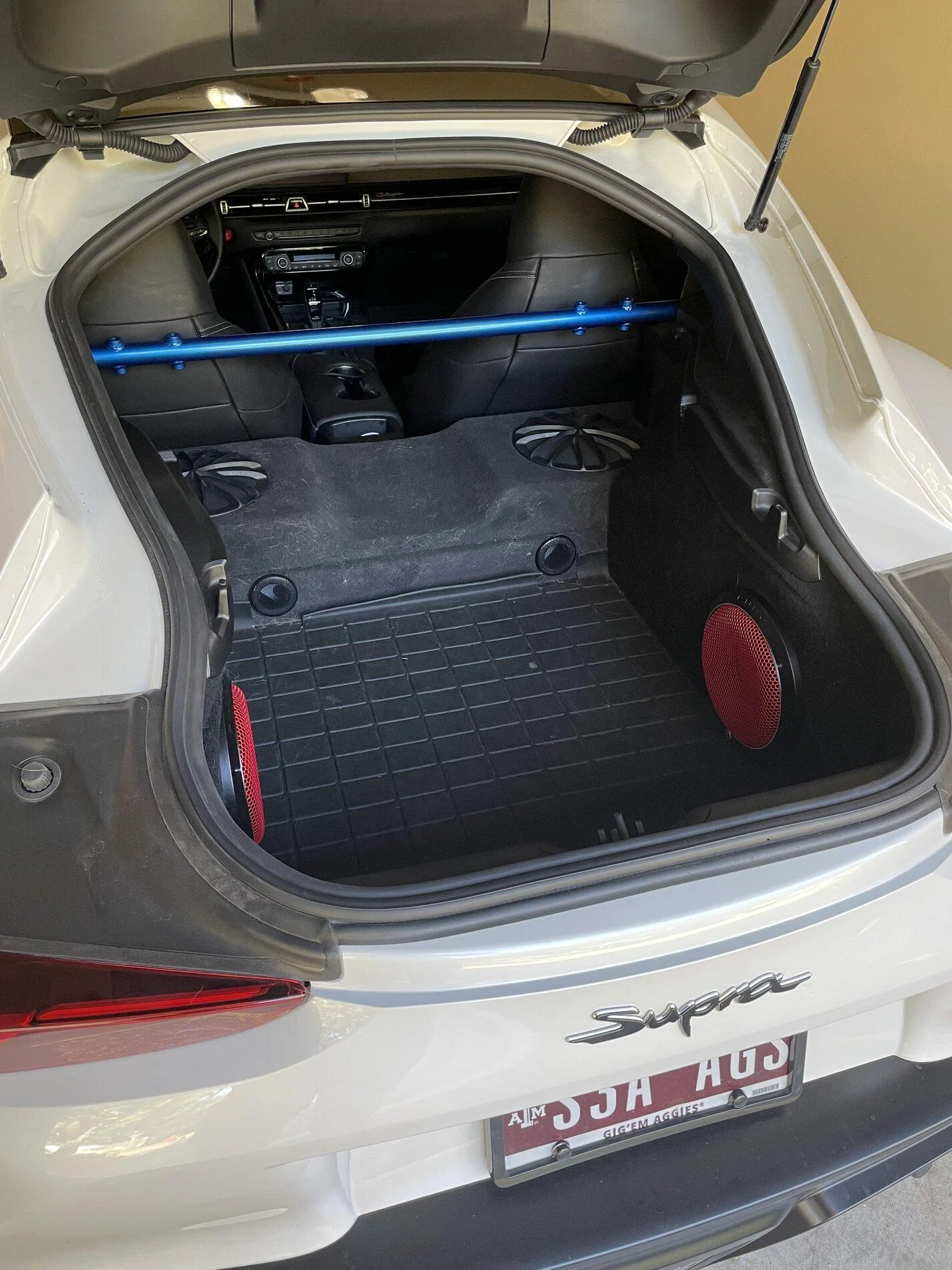

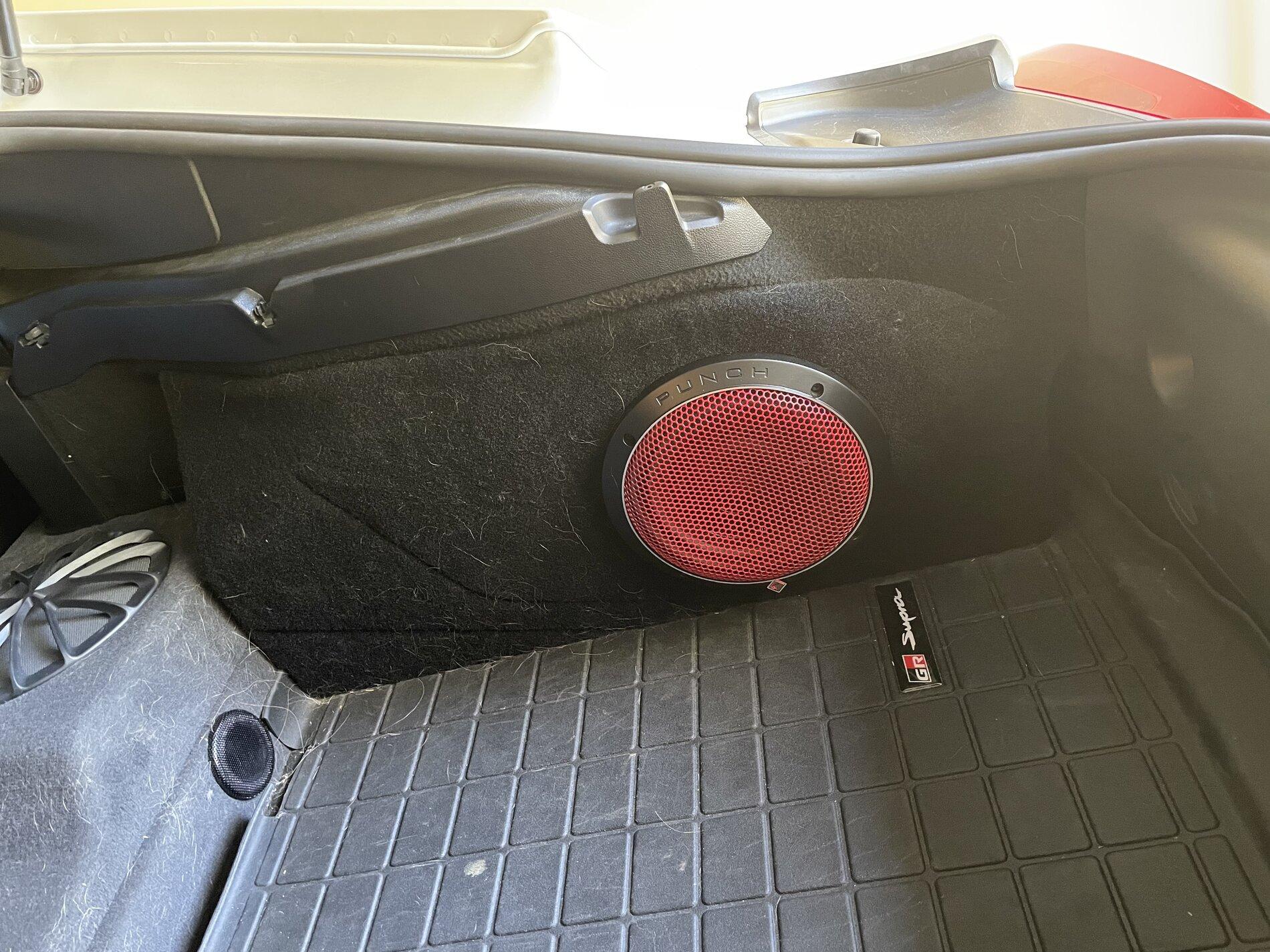

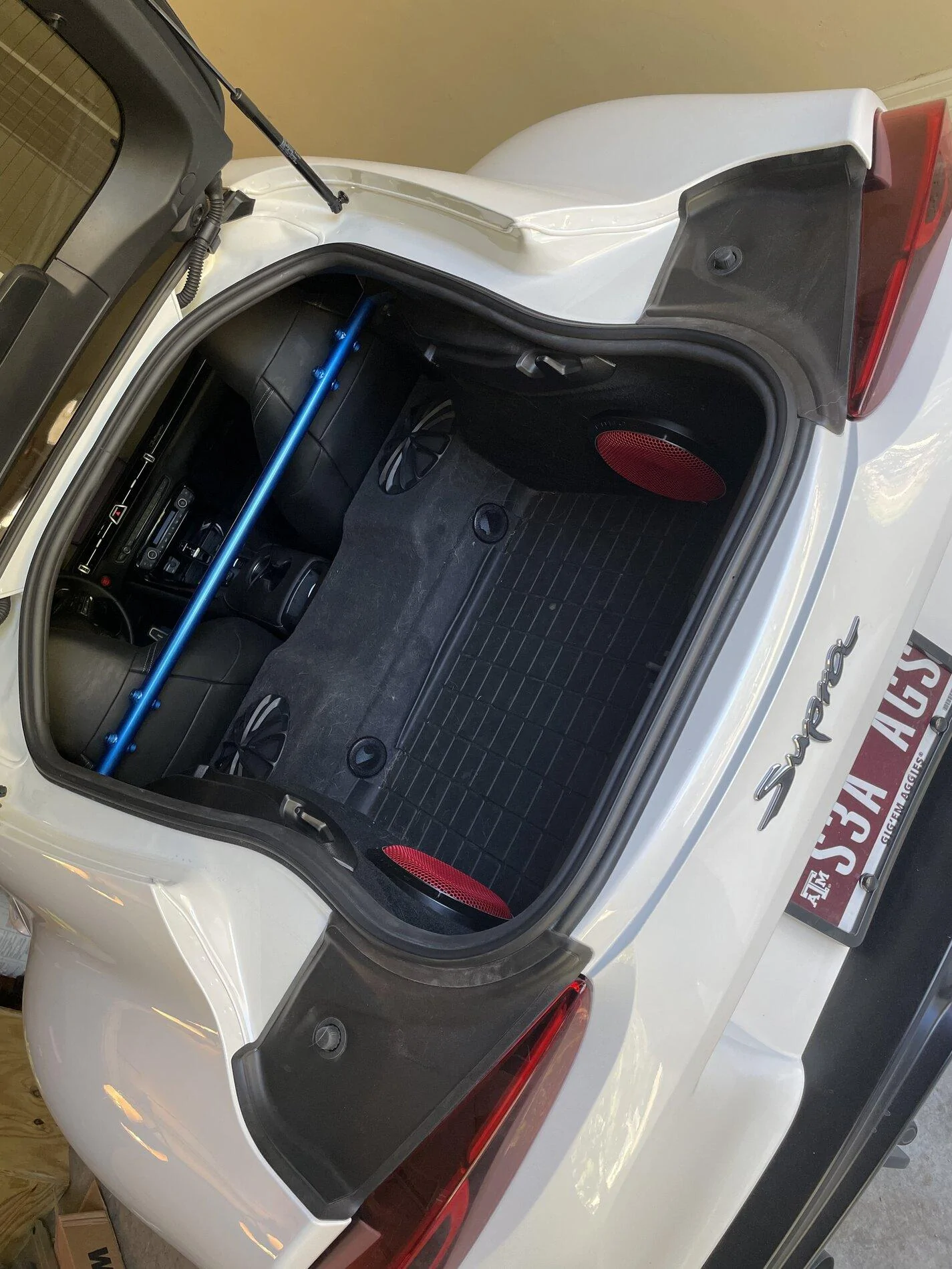

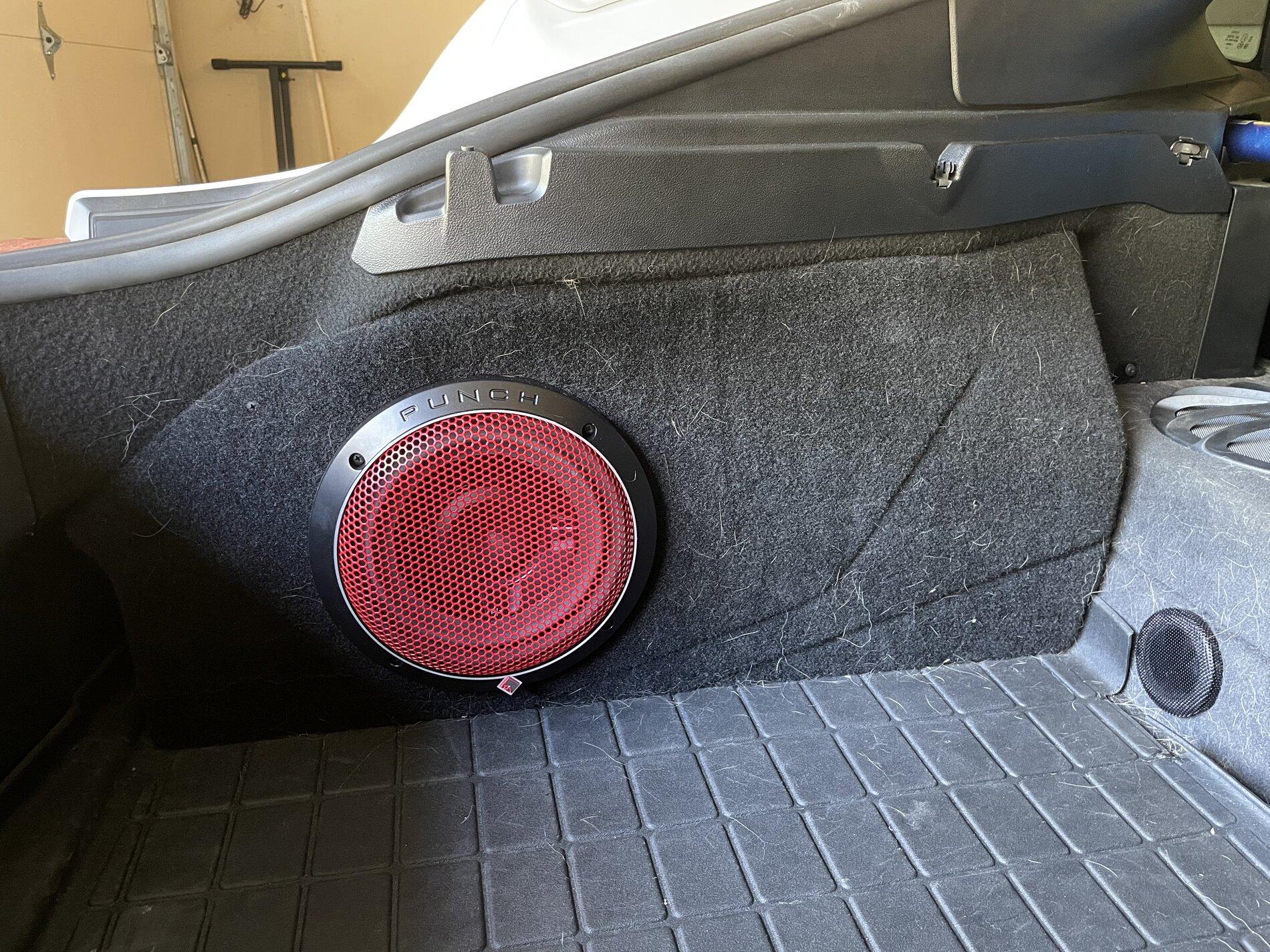

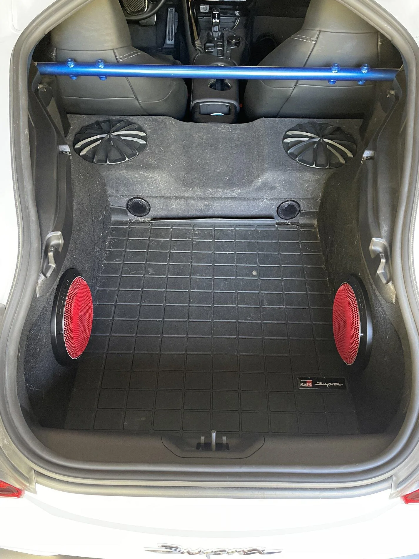

The fine folks at Modified Custom and Collision finished up some custom subwoofer boxes for me on Friday. The majority of the boxes are fiberglass with MDF faces. They installed two Rockford Fosgate P3SD4-8 subwoofers and used their 500W amp to power it all. Looks incredible, finished in factory carpeting with red speaker mesh. Sounds awesome! Check these guys out if you need any custom work done. Pardon the dog hair, Shadow likes to ride with me sometimes.

Thatā€™s awesome. Iā€™m working on the exact thing now. Did they make fiberglass enclosures

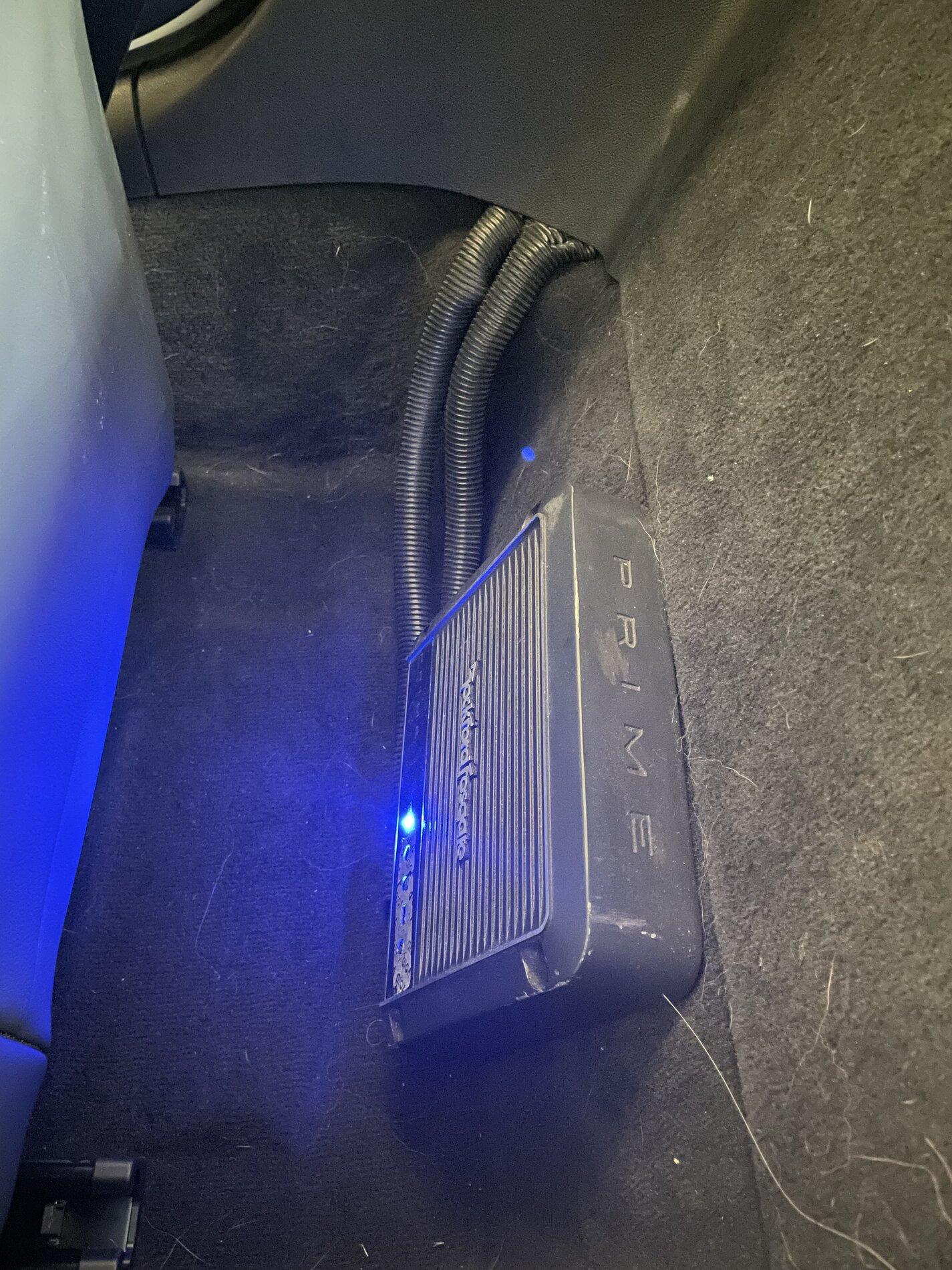

wow that looks fantastic! Any pics where they mounted the amp?

Yessir, enclosures are fiberglass. A local tuning shop did the work for me, Iā€™m not sure where they got the carpeting. I know that most Home Depotā€™s/Loweā€™s sell automotive carpeting in various shades and colors. Thatā€™s where Iā€™d look.

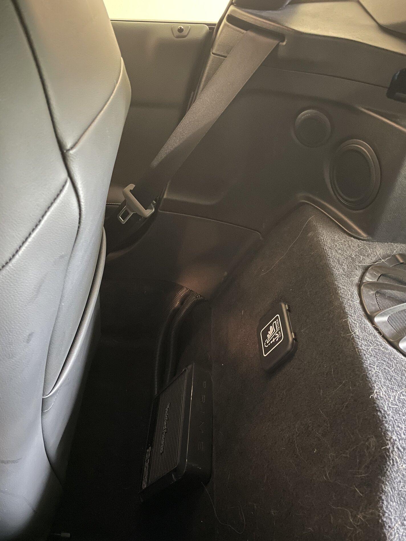

Iā€™ve seen a few people install amps there as well and most say they have no issues w seat hitting it. Iā€™m gonna mount mine behind the oem 8s at an angle

Nice. Any issues putting the seat all the way back or does it clear?
They installed the amp low enough that it really doesnā€™t come into contact with the seat at all. Even fully reclined, the seat hits the Cusco brace long before it could touch the amp.

Any idea how much air space they were able to get like that. Iā€™m doing the audiofrog GB10 and need like .75 cubes net

The subwoofers they installed demand a minimum air space of 0.25 cubic feet for a sealed box and 0.75 cubic feet for a ported box. I donā€™t know how much air each box actually encloses, but there is more than enough volume in those cubbies to satisfy either number.
