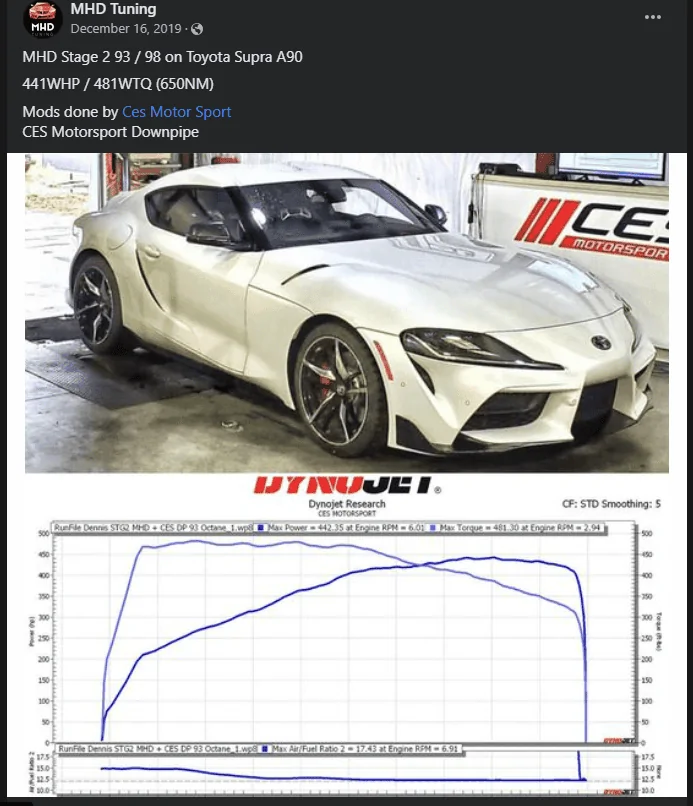

JB4 isn't like a full flash tune, so a downpipe isn't a giant thing on JB4 you should be pretty close on the stock system I believe. I just had a cat back and kept the stock downpipe.
So i'm assuming a pro tune (non ots) on MHD with a downpipe will yield a much better powerband and higher peak numbers than JB4. Let's say 450ish on 93 octane?

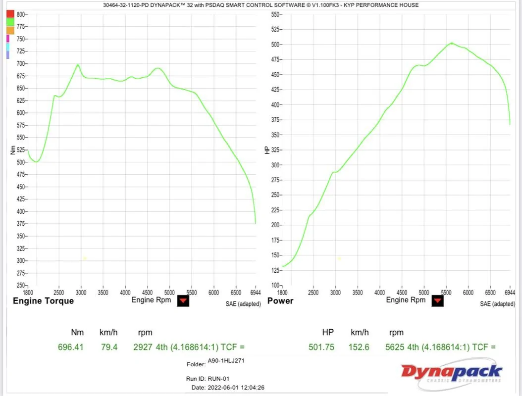

The MHD OTS maps are good. I spent months getting a "pro" tune for e40 and it was worse than the OTS e30 tune.
This is what mine made with the OTS e30 map on a hub dyno.

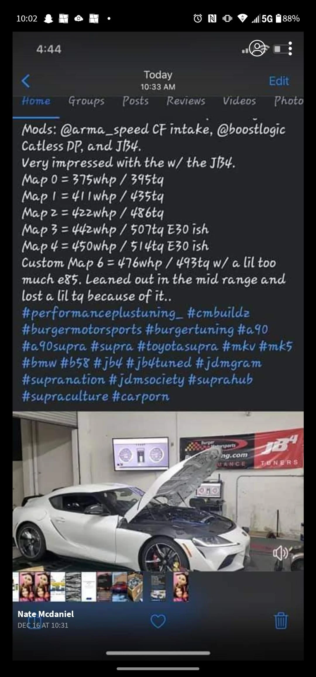

Thank you i’m running 93 here in FL as well, it’s hot, it’s muggy its not ideal. We get good air like 4 days a year LOL.
As for the facebook post if it’s possible to find out was Map 1-4 also run with E85 or did they do a custom map 6 to run E85? That is a big difference since the higher HP would be more a result of E85 and less a result of custom tuning using 93 across the board.
What I think is helpful for all of us to understand, who use JB4, is was custom tune really made available so you can tune alternative fuels and if your just gonna run 93 across the board probably not gonna make much difference between say map 3/4 and custom on 93. I’m sure a bunch of us don’t want to throw away $600 and get basically what we already had.
