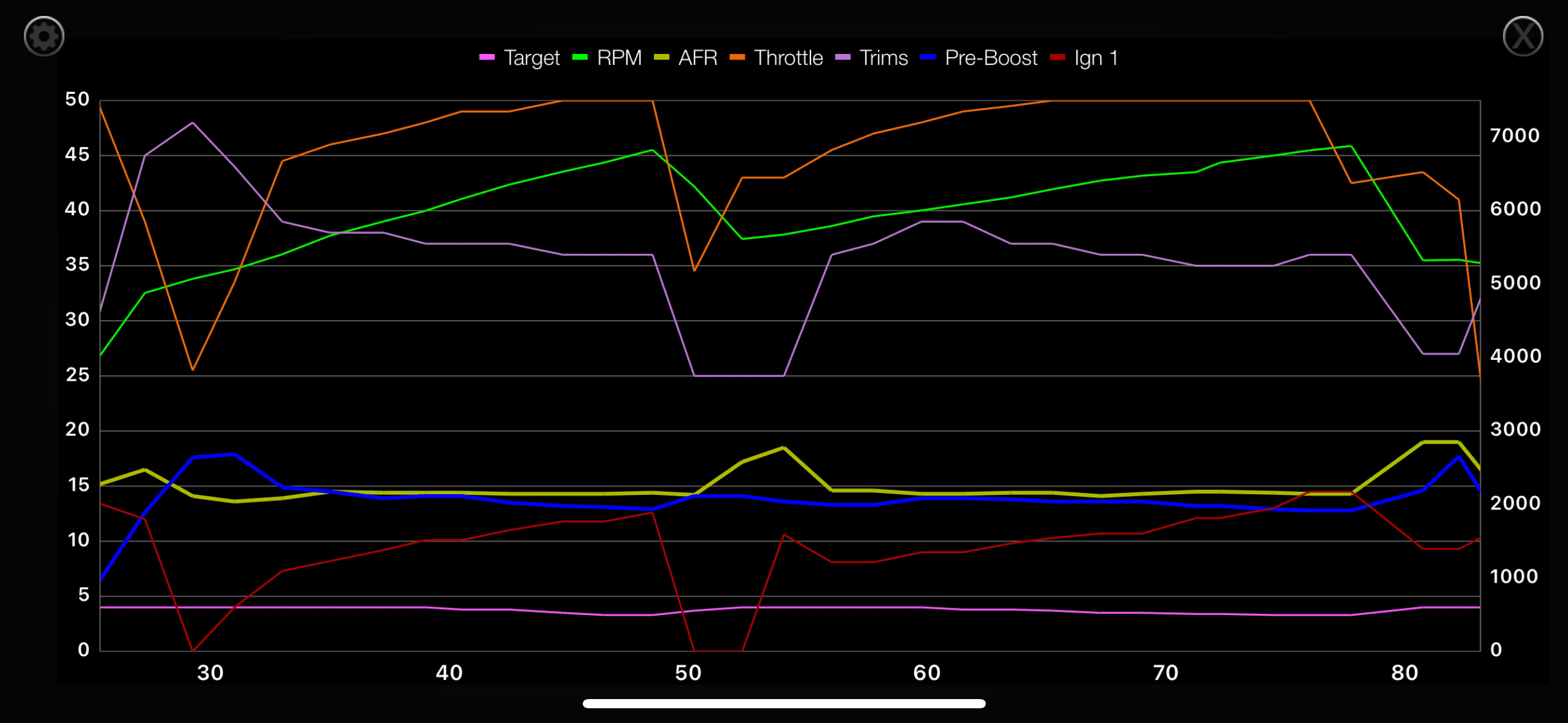

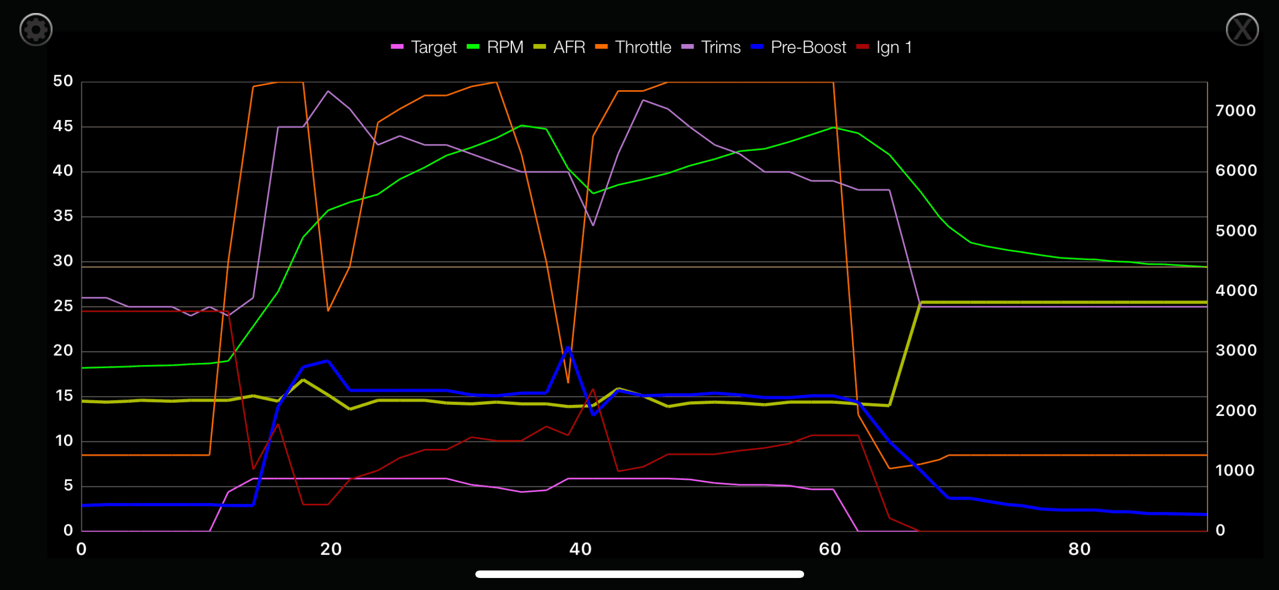

I would say it's more than just numbers. It's how smooth it is. Most of the off the shelf maps are not smooth at all to the point where you notice it when driving. Even if Jesse's tunes made the same hp/tq as an off the shelf map, it's going to drive way better, not pull timing/close throttle and overall just be better.
Here is my personal example. He took something that looked like this (off the shelf map)...
And turned it into something like this....

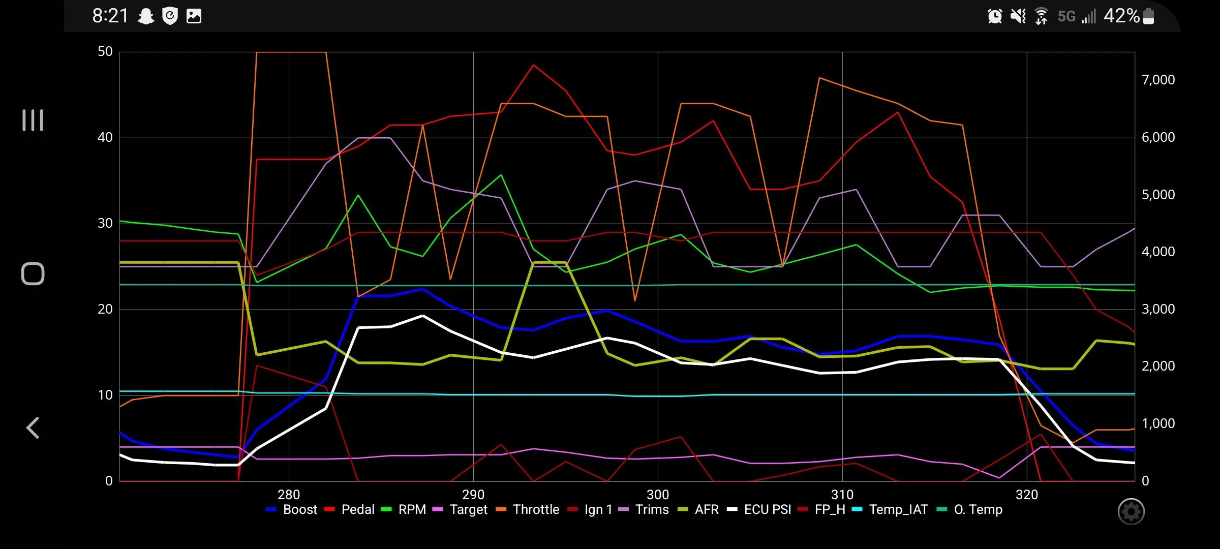

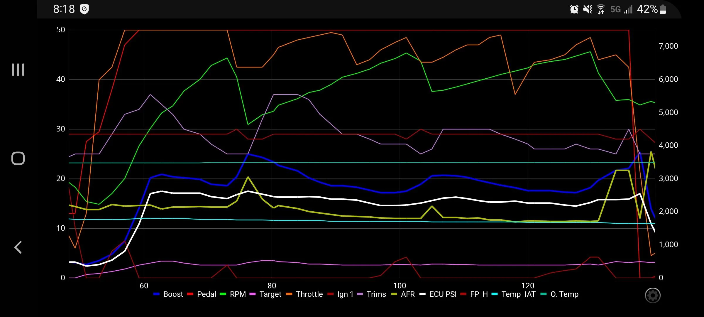

Thank you for the charts that is really helpful. But also an interesting result too. So here are my graphs below. My Map2 and Map3 graphs don’t look near as crazy as yours they look closer too (but not exactly) to the custom map your running.
Based on the graph and what you said your car is running different than most. Your ECU PSI has to be around 10 for it to only be targeting 15-16 PSI on Map3 (usually indication of a boost leak somewhere) when almost all 2021 target 14-15 PSI Stock, so while you think your gaining a ton of performance your only 2 psi over what most cars typically run completely stock :)
You can thank +100° days and 91 octane for that. I now run an E25 blend and the graph is smoother then ever (only on the custom Jesse tune).
