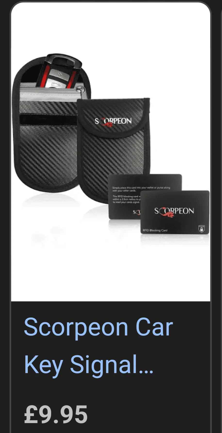

100% worth it.
- Cheap.
- Keeps key clean.
- Protects key from scratches/dropping.
- Easily tested: if you walk up to the car with the key in the pouch it won't unlock, and it won't start either even once inside the unlocked car, if you put it back in the pouch.
My advice: they tend to be cheap overall but DO NOT buy a really cheap one, try to spend at least Ā£10 or equivalent of your currency; Get one from a website that specializes in making faraday pouches/security gadgets, OR, if on Amazon, get one that is very popular with high rated reviews, trust me, I tried 3 or 4 types and I can confirm the very cheap ones do not work, I would avoid ebay and any chinese crap website.
I got this one from a brand called "Scorpeon" and it's excellent, it has velcro as well as zipper and it is small, some of them are too big so make sure you check the size, it also feels very nice and sturdy and looks cool - as a bonus they also had a card that you can keep in your wallet to reduce relay risk on your contactless credit/debit cards.
This one can also be in silver/carbon color:
