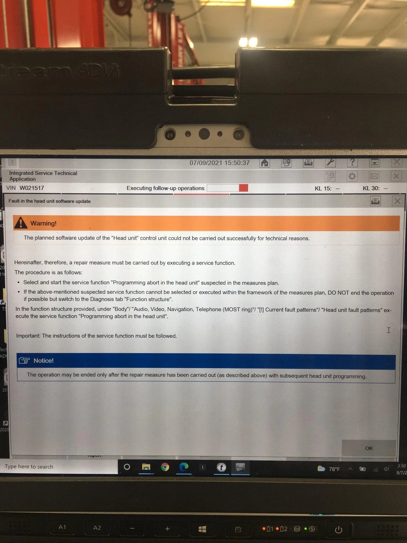

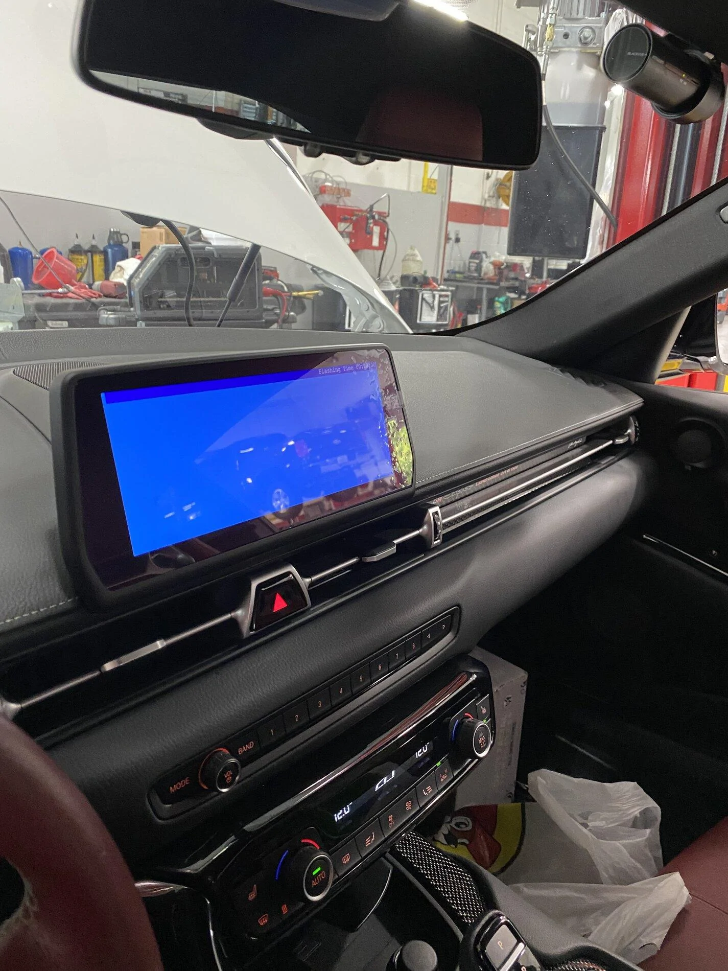

Has anybody taken their Supra in for a recall and the dealership was unsuccessfully updating the software and the Navi screen went blank blue and was told by the dealership that a new idrive navi system was needed. Lol (not me, happened to a friend of mine) now her car is stuck at Toyota until a new Navi unit comes in.

Forgot the ecu locking. I spoke to a Supra tech today and he told me the new recall updates was causing some idrive headunit malfunctions where it freezes up during the updates which causes Toyota having to order a new headunit. FML ?‍♂ The people that got the recall updates with no issues are the lucky ones.
I'm not surprised to hear this. This is no different from bricking an ECU, or motherboard during a firmware update that looses a connection halfway through the re-write. Guess we'll let Toyota figure all that out before I head in to have it done.
Do you know if the car was on a battery tender? I'd guess that either the laptop lost the connection or the cars voltage dropped.
Axix23
Nov 18, 2019
3,135
3,344
GA
NA
unsure Honestly. All I know is the dealership she went had never attempted a recall update before hers. Not sure why she went to that one lol
I am calling technician error. But who knows…..
